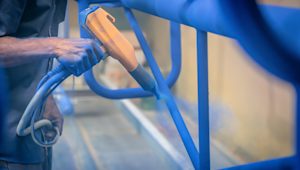

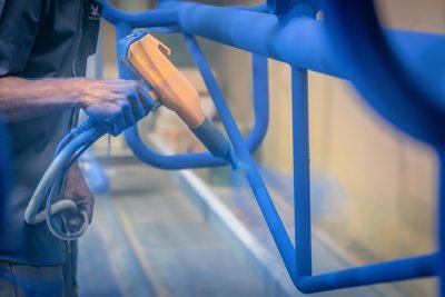

Spray device with a powder delivery system and electrostatic spray gun
High transfer efficiency
