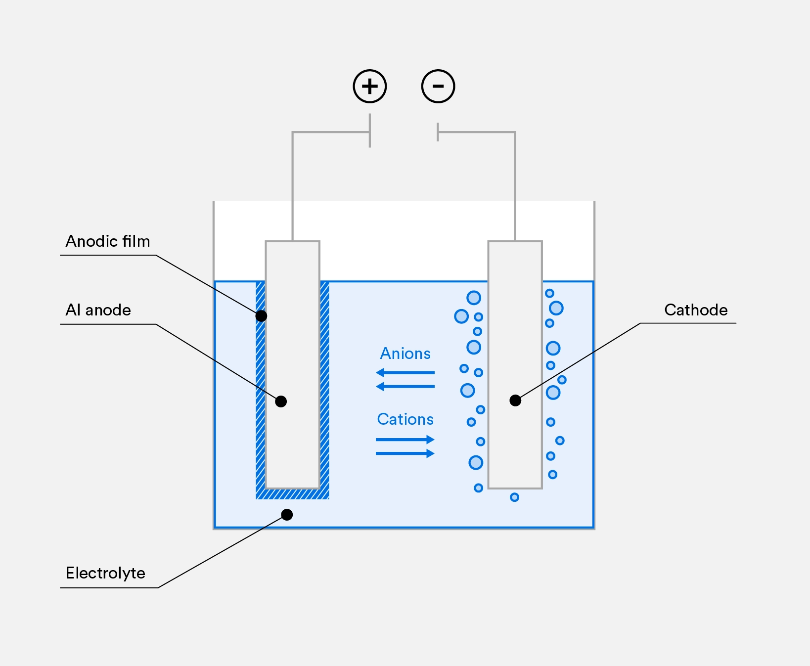

The DTSS-3D anodizing process
Anodizing is an electrolytic process both for protecting aluminum parts against wear and corrosion and for improving cosmetic appearances. Let’s break down the basic steps for anodizing a part:
Connect the part to an anode
Submerge the part in acidic electrolyte solution
Apply a cathode to a metal electrode in the solution
Positive ions react with negative O2 ions and the surface becomes porous
This grows a layer of aluminum oxide on the part
Use corrosion inhibitors or colored dyes for cosmetic purposes
Seal the nanopores
