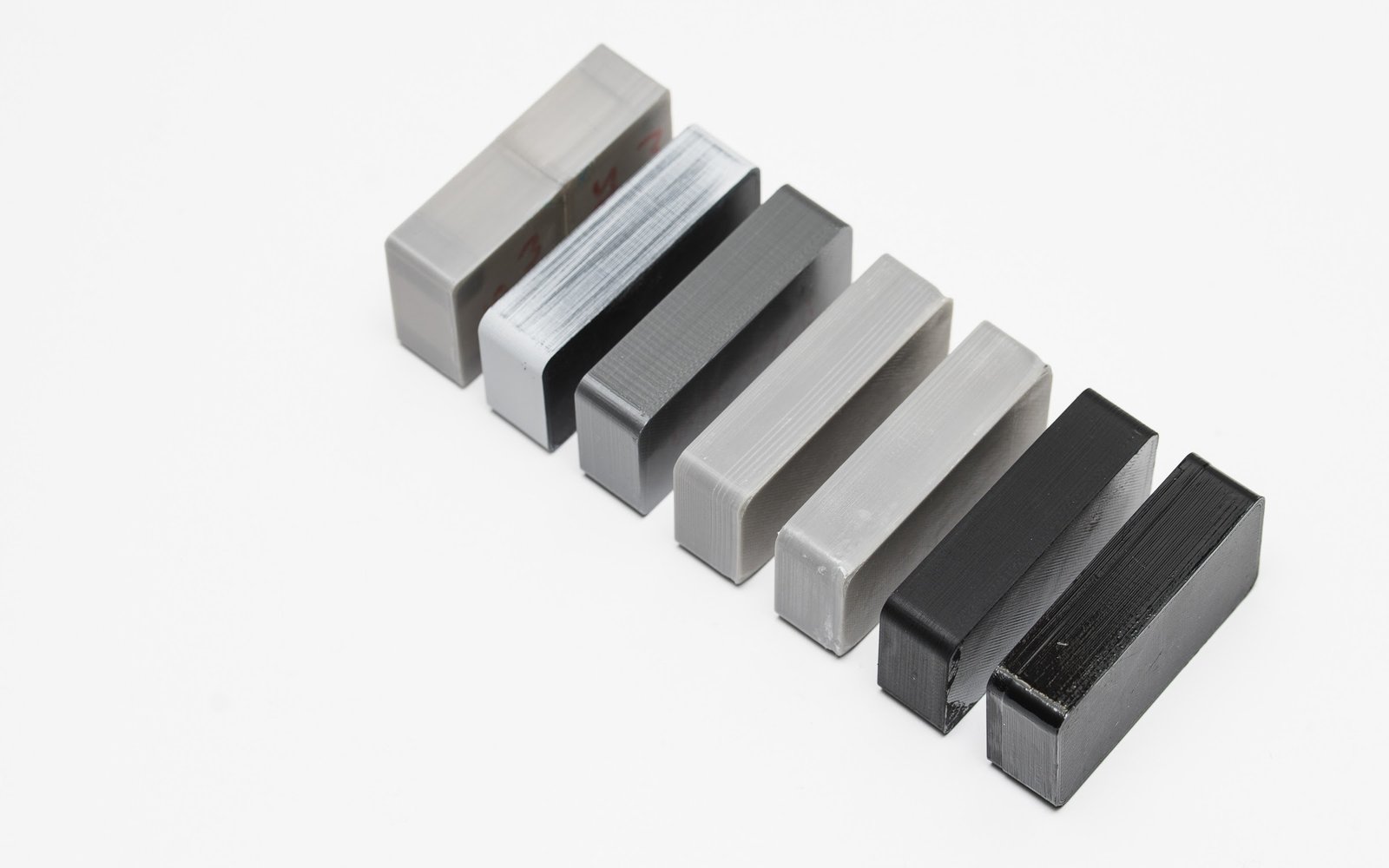

Sanding
Tool kit
150, 220, 400, 600, 1000, and 2000 grit sandpaper
Tack cloth
Toothbrush
Soap
Face mask
Process: After supports are removed or dissolved, sanding can be done to smooth the part and remove any obvious blemishes, such as blobs or support marks. The starting grit of sandpaper depends on the layer height and print quality; for layer heights of 200 microns and lower, or prints without blemishes, sanding can be started with 150 grit. If obvious blemishes are present, or the object was printed at a layer height of 300 microns or higher, start sanding with 100 grit.
Sanding should proceed up to 2000 grit, following common sanding graduations (one approach is to go from 220 grit to 400 grit, to 600 grit, to 1000 grit and finally 2000 grit). It is recommended to wet sand the print from start to finish, to prevent friction and heat build-up from damaging the part and keep the sandpaper clean. The print should be cleaned with a toothbrush and soapy water, then a tack cloth, between sanding gradations as well to prevent dust buildup and “caking”. FDM parts can be sanded up to 5000 grit to achieve and smooth, shiny finish.
Pro-tip: Always sand in small circular motions evenly across the surface of the part. It may be tempting to sand perpendicular to print layers, or even parallel to the print layers, but this can cause “trenches” to form the part. If the part discolors, or if there are many small scratches from sanding, a heat gun can be used to gently warm the print and soften the surface enough to “relax” some of the defects.
Pros
Produces extremely smooth surface finish.
Makes additional post-processing (such as painting, polishing, smoothing, and epoxy coating) very simple.
Cons
Not recommended for prints with 2 or less perimeter shells, as the sanding process can damage the print.
Difficult for intricate surfaces, and prints with small details.
Can impact overall accuracy of the the print if sanding is done too aggressively and too much material is removed.
Finish
Tolerances
Speed
Suitable for
All FDM thermoplastics

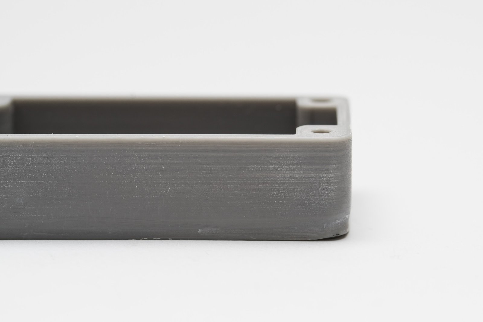

Vapor smoothing
Tool kit
Tack cloth
Solvent-safe sealable container
Solvent
Paper towels
Aluminum foil (or other solvent-proof material)
Face mask & chemical-resistant gloves
Process: Line the chosen container with paper towels along the bottom, and up the sidewalls if possible. It is critical that the vapor will not compromise the chamber itself, and the chamber can be sealed. Glass and metal containers are recommended. Pour in enough solvent to dampen, but not soak, the paper towels; this should also help the towels adhere to the sidewalls of the container. Acetone is well-known for it’s abilities to smooth ABS. For PLA, smoothing is possible with different solvents (THF or MEK work decently) but it is generally more difficult to get a smoothed surface when compared to ABS. When working with any solvent, please check the safety regulations on the chemical and always use appropriate safety precautions. A small “raft” of aluminum foil, or other solvent proof material, should be placed in the middle of the paper towel lined container. Place the print on the raft (with whatever side has been chosen as the bottom resting on the raft), and close the lid of the container. Vapor polishing will take a variable amount of time, so check the print periodically. Heat can be used to increase the speed the polishing occurs at, but care must be taken to prevent the buildup of potentially explosive vapor.
When removing the print from the chamber, try to avoid touching the print at all by leaving the print on the raft, and removing both from the container. Any points where the print has been contacted will have surface imperfections, as the outer shell will be semi-dissolved. Allow the print to fully off-gas any remaining solvent before handling.
NOTE: Many aerosolized and/or atomized solvents are flammable/explosive, and solvent vapor can be harmful to human health. Take extreme care if heating solvents, and always smooth prints/store solvent in a well-ventilated space.
Pros
Smooths many small blemishes and diminishes the layer lines present in a print without any additional work.
Produces a very smooth “shell” around the exterior of the print.
Very quick, and can be done with commonly sourced materials.
Cons
Will not “heal” gaps or fully mask layer height.
Smoothing process “dissolves” the outer shell of the print and therefore this has a heavy impact on tolerances.
Negatively impacts the strength of the print due to alterations in the properties of the print material.
Finish
Tolerances
Speed
Suitable for
ABS (sometimes PLA)

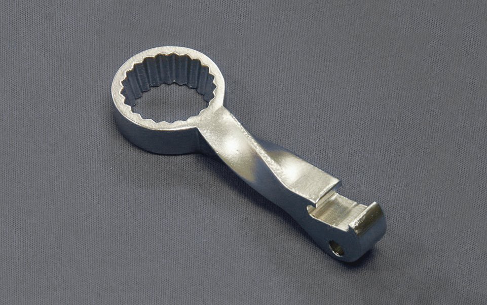

Metal plating
Tool kit (for home plating)
Electroforming solution - Electroforming solution can be made by mixing a metal salt with an acid and water, but unless the measurements are exact and the ingredient quality is very high, it is difficult to achieve professional finishes. Buyipremade solution (such as Midas’ solutions) will ensure plating issues are not due to the solution.
Sacrificial anode - The material of the anode must match the metal of the electroforming solution, so if copper sulfate is used in the solution, then a copper anode must be used. Any object made of the plating metal can be used (such as copper for copper plating), or a thin strip of the plating metal can be purchased, which is made specifically for electroplating.
Conductive paint or acetone & graphite - The surface of the print must be conductive for plating to work, which can be achieved with conductive paint or a 1:1 solution of graphite and acetone. The conductive paint will work for any print materbut the acetone graphite solution will only work for ABS.
Power rectifier - A battery can be used in place of a power rectifier, but a battery is not as efficient and will not produce results as quickly or consistently as a rectifier will. A rectifier is also a safer option, as it can simply be turnedto break the current flow during electroplating.
Conductive screw or eye-hook
Non-conductive vessel
Lead set
Non-conductive gloves and protective eyewear
Electroforming solutions are acidic, and can cause eye damage if splashed, so appropriate eyewear is necessary. It can also irritate skin and will conduct charge during electroplating, therefore non-conductive gloves should be used at all times..
Process: Metal-plating can be done using electroplating at home, or a professional shop. Proper metal-plating requires a strong knowledge of materials, and what can be done at home is limited in comparison to what a professional shop can achieve. For superior finishes, and a wider range of plating options including chroming, utilizing a professional shop is the best option. For clarity, the process of electroplating with copper will be described below.
Electroplating at home can be done using copper or nickel as a base plate, to which other metals can then be plated over. It is of critical importance that the print surface is as smooth as possible prior to plating; any irregularities and layer lines will be emphasized after the plating process. Prepare the cleaned and sanded print for plating by coating the plastic with a thin layer of high-quality conductive paint, or a solution of acetone and graphite if the print is ABS. Allow the conductive coating to dry fully, and sand if necessary to ensure a smooth surface. It is of utmost importance to minimize contact with the print at this point or wear gloves, as the oils from skin will affect the plating process.
Insert the screw or eyehook into an inconspicuous surface of the print, and attach to one of the rectifier leads; this will serve as the cathode and must be connected to the negative terminal of the rectifier. Attach the copper anode to the positive terminal of the rectifier using the second power lead, and fill the chosen vessel with enough copper electroforming solution to fully cover the print and copper anode. Insert the anode into the bath and turn on the power rectifier. Once the rectifier is on, insert the print into the bath, ensuring it is not contacting the anode at any point (Be very careful at this step, as once the print is in the bath, the plating system is electrically live and any contact with the solution or anode/cathode can cause injury). Set the power rectifier to 1-3 volts, and allow plating to occur until the print is fully coated. The voltage can be increased to increase plating time, but do not exceed 5 volts. Simply power off the rectifier and remove the print once a satisfactory coating has been deposited and dry the print using microfiber towels. Coat the print with a metal lacquer once dry to protect from corrosion.
Pros
A plated metal shell increases the strength of the plastic part, which greatly broadens potential applications and uses of the print.
The outer metal coating is very thin, so tolerances can be tightly held if the plating is done properly.
Produces a beautiful surface finish, which if done properly, will not look like a 3D printed object.
Cons
Generally, very expensive to plate the prints professionally, and electro-plating at home requires a decent amount of equipment for a professional finish.
Electroplating at home can cause electrical injury if proper safety procedures are not followed and adhered to.
Finish
Tolerances
Speed
Suitable for
