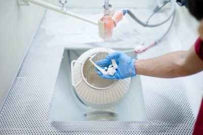

The fastest and most cost-efficient method to add color to SLS and MJF parts is by dyeing them. SLS and MJF parts are porous, which makes them ideal for dyeing.
To dye a part, immerse it in a hot color bath - a large range of colors is available for SLS parts, with more color options on the way for MJF. Using a color bath ensures that you cover all internal and external surfaces of the part. Typically, the dye only penetrates the surface down to a depth of around 0.5 mm, which means that over time the color will fade and expose the original color of the powder. So, watch for wear and tear.
Pros
A large range of colours available for SLS
Dyeing doesn’t affect part dimensions
Multiple parts can be dyed at once
More cost-efficient than other coloring methods
Ideal for complex geometries

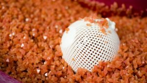

How do vibro polishing and tumbling affect SLS and MJF parts?
As SLS and MJF parts are printed using nylon powder, completed parts will have a coarse surface finish. Vibro polishing smoothes out the surface of the part via a tumbler filled with small media (generally ceramic beads) that vibrate against the surface of the model, removing the grainy texture. This method gives your part a smooth and slightly shiny appearance, similar to
injection molded parts.
It’s important to note that vibro polishing and tumbling affect the part dimensions and round out otherwise sharp edges. We don’t recommend using a tumbler for parts with fine details and intricate features. Smaller, weaker parts are likely to be damaged after being exposed to vibrating media for several hours. As well, small ceramic beads may get stuck inside medium-sized gaps and trenches.

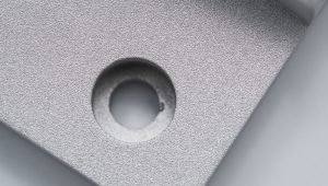

What is the standard finish for SLS parts?
The standard finish is your default for
SLS printed parts. With this process, you remove parts from the build chamber and use compressed air to get rid of all the excess powder material. After this, you clean the surface via plastic bead blasting to remove any unsintered powder that may still stick to the surface.
This standard finish is inherently rough, similar in feel to medium grit sandpaper (satin-like matte that’s slightly grainy). However, it’s the best surface preparation for painting or lacquering your parts.
All SLS parts come with this standard finish unless otherwise specified.
