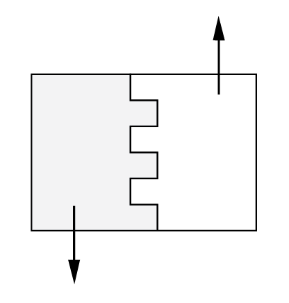

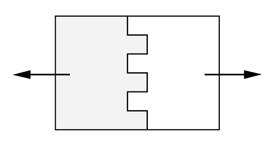

There are 3 forces to consider when designing interlocking joints:
Friction - the critical force that holds the joint together. The tighter the joint is, the higher the friction and the more difficult it will be to pull apart
Tension - the force that acts to pull the joint apart
Shear - the force perpendicular to tension that pulls the joint sideways (a tearing force)

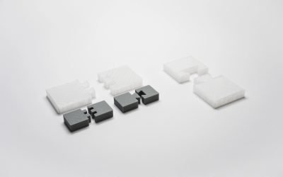

Interlocking joints accuracy
When interlocking joints are manufactured in injection molding, a tolerance of 0.1mm is applied. For 3D printing, tolerances vary between technologies as summarized in the table below.
| Process | Interlocking parts tolerances |
| FDM | 0.5 mm |
| SLA | 0.2 mm |
| SLS | 0.2 mm |
| Material Jetting | 0.1 mm |
Rules of thumb
- SLS and Material Jetting are best suited for interlocking joints due to their high print accuracy and material strength.
- FDM is good for low cost prototyping of interlocking connections when accuracy and durability are not critical.
- Including a small radius on the edges of parts will assist with assembly of joints.
