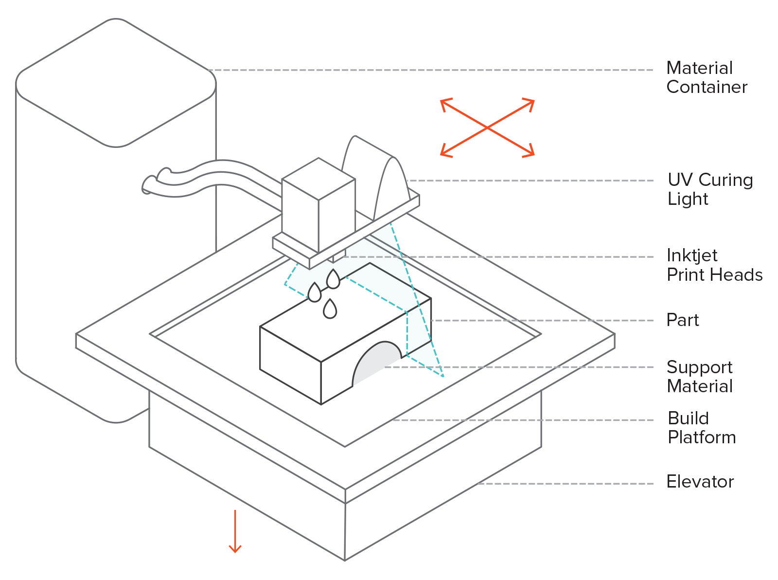

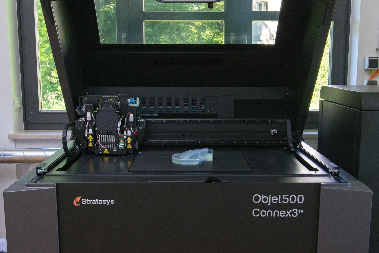

Material Jetting works much like a standard inkjet printer. However, instead of printing a single layer of ink, thousands of layers are built upon one another to create a solid part. Via hundreds of tiny jets, Material Jetting printers dispense a photopolymer over a specific area. The print head then cures (solidifies) the photopolymer via a UV light. After a layer has been deposited and cured the build platform drops down one layer thickness and the process is repeated to build up a 3D part.
Unlike most 3D printing technologies that deposit, cure or sinter build material through point-wise deposition technologies (a single point follows a path to complete the cross sectional area of a layer), Material Jetting operations deposit build material in a rapid, line wise fashion. Because of this, Material Jetting printers are able to print multiple parts in a single line with no effect on build speed. If parts are correctly placed, and the space within each build line is optimised, Material Jetting is able to produce parts at a much quicker rate than other 3D printing technologies.
Material Jetting processes require support and this is printed simultaneously during the build from a dissolvable material that is removed during post processing.

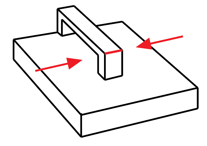

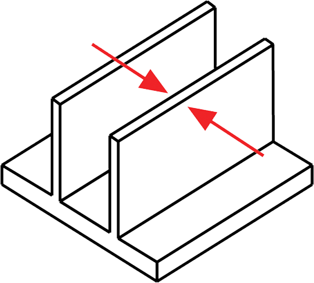

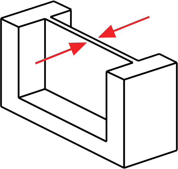

Major support walls -The minimum wall thickness for major supported walls is 1 mm.
All other walls - For all other walls the minimum wall thickness should be no less than 0.5 mm.

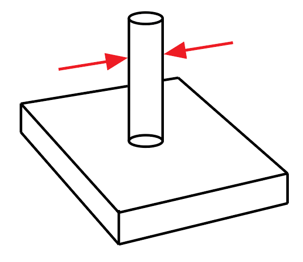

Pin diameter - A minimum pin diameter of 0.5 mm is recommended

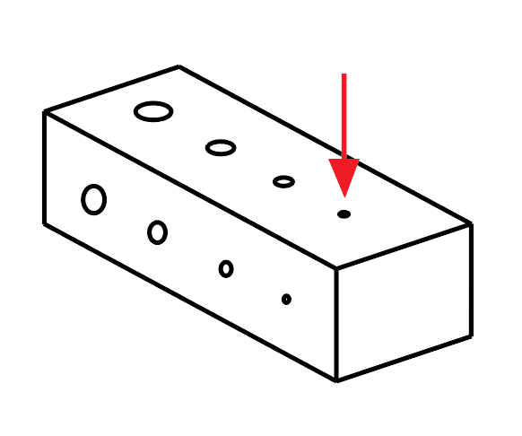

Hole size - For a hole to successfully print the minimum diameter should be no smaller than 0.5 mm. Holes, whenever possible, should be oriented vertically, to maximize the circularity of the feature.

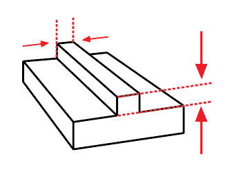

Embossed and engraved details - To ensure small details are visible the following rules apply:
Minimum depth of engraving 0.5 mm
Minimum height of embossing 0.5 mm
Feature size (pins, protruding features etc.) - Material Jetting is capable of producing part details as low as 0.25 mm.

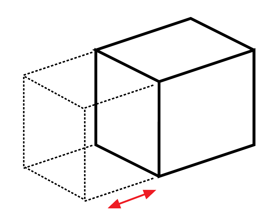

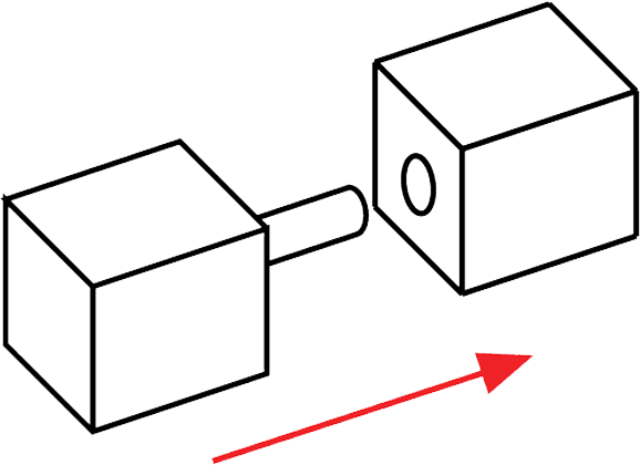

Moving parts: Assembled parts, hinges and joints should have 0.15 - 0.2 mm clearance around all sides. This clearance must also be accessible in some way to allow for cleaning/removal of the support material that will build in the gap.
Tolerances - Tolerances for parts made via Material Jetting range from from +/-0.1mm - 0.3mm depending on geometry and material.

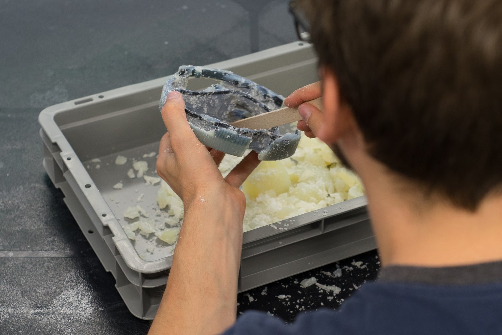

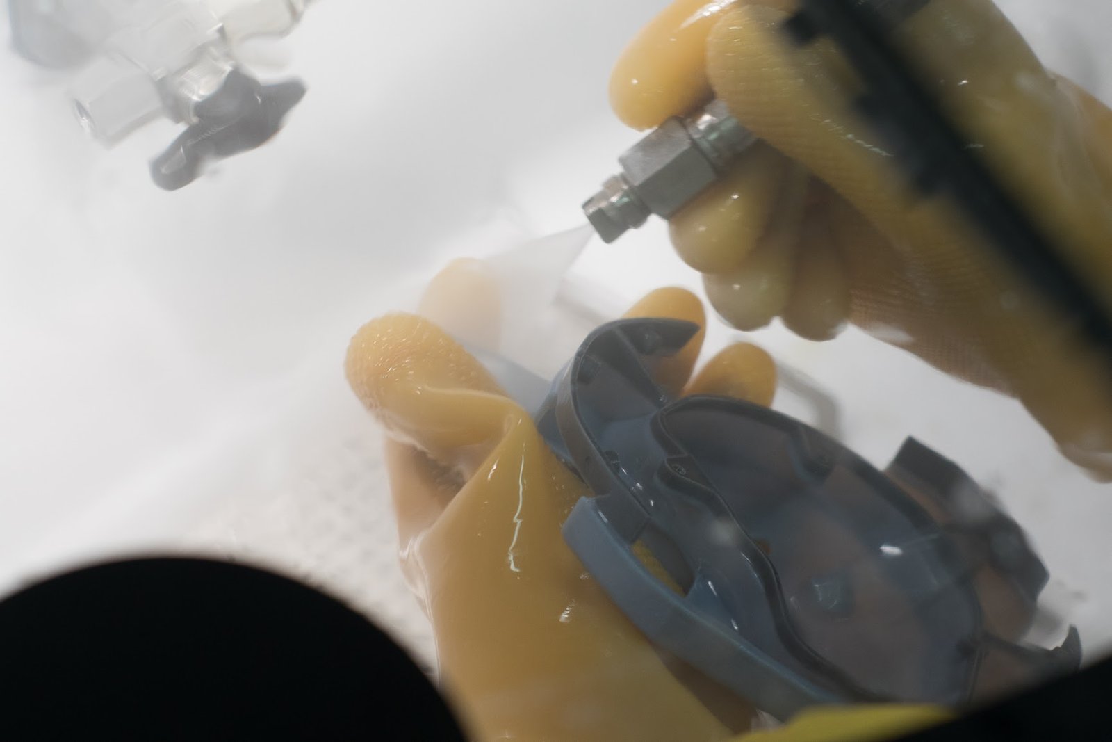

Dissolvable support
One of the biggest advantages of Material Jetting is that all parts are printed in 2 different materials; one for the main build material and the second as dissolvable support. This means that unlike other 3D printing methods where support must manually be cut away from the part, support is dissolved and easily removed with agitation. When post processed correctly this can result in a surface that shows no indication of support at all.
This also means that part orientation is much more flexible than other 3D printing technologies. This coupled with the relative homogeneity of material jetted parts offers greater design freedom and allows very complex and intricate design so be printed and easily post processes.

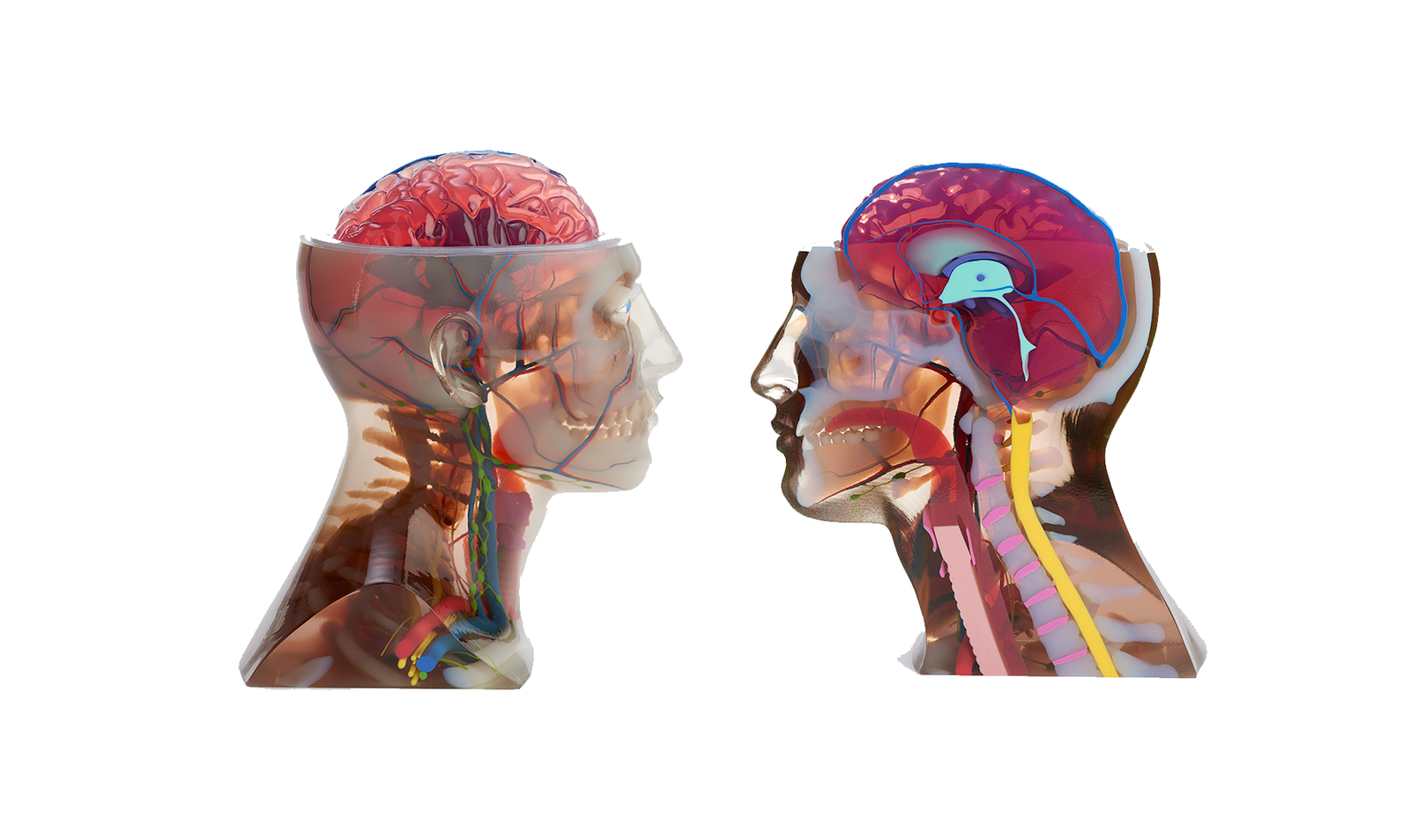

Material Jetting is the only 3D printing technology that is able to produce full, multi-colour prints. By using Cyan, Magenta, Yellow, Black, and White rigid materials (CMYK) a full suite of colour options are available. This can be achieved through the print setup process, by assigning RGB colour codes to the parts, or can be done in the CAD process, by colouring the part, and exporting as a VRML file. Texture layers, such as pattern prints and finishes, can also be applied to the part in CAD, and exported as a VRML. Things like brush strokes, wood grain, and gradient colours, can be added to parts using this method.
The medical industry has taken advantage of this for educational, high detail, anatomical models as shown in the image below.
