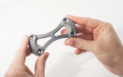

What are the best practices for 3D printing with MJF?
The best practices for manufacturing with MJF 3D printing include setting the right print size, choosing an optimal wall thickness, selecting materials based on the desired application and several more design considerations.
If you opt to use MJF to produce custom parts, we recommend a maximum print size of 380 x 285 x 380 mm (14.96 x 11.22 x 14.96 in). The walls of any part created with MJF should be between 2.5 mm (0.098 in) and 12.7 mm (0.5 in) thick.
While MJF is capable of creating small parts or tools with extremely fine details – such as raised text or cosmetic details – we recommend a minimum feature size of 0.5 mm (0.02 in) and print layers that are at least 80 microns thick (0.08 mm).
When embossing, ideally your part will be printed with an upside-down orientation and facing up for engraving. Additionally, parts with curved, hollow geometries can be tricky to achieve with MJF printing, so be sure to adjust your part accordingly or consider a different additive manufacturing process.
Water-resistant parts are also possible when printing with MJF, but only when using PA 12 nylon powder – and in parts that feature walls that are at least 1 mm (0.039 in) thick, or more than 4 mm (0.16 in) for watertight properties.
MJF already enables designers and engineers to produce parts at reduced costs and lead times – especially compared to 3D printing processes such as SLS and injection molding. To get the most out of your MJF print, however, it’s best to keep the above limitations in mind when designing parts. Factor in additional post-processing techniques as well, such as sanding, dyeing or painting, as MJF parts are typically rough and gray-colored.
Other elements of or limitations to MJF to consider include:
Warping of long and thin parts. To avoid this, increase part thickness, add ribs in affected areas, replace solid-volume areas with lattice structures (with a 2.5 mm (0.098 in) gap between each lattice) and introduce smooth transitions (ramps instead of steps, for example).
Assembly requirements. If parts need to be assembled after printing, leave a minimum gap of 0.6 mm (0.024 in) between areas that will connect. If you are printing parts that are already assembled, a minimum clearance of 0.9 mm (0.039 in) is recommended.
Elephant skin. The thicker the part, the higher the chance that a part will improperly cure and feature an uneven pockmarked surface known as “elephant skin.” By decreasing wall thickness or using internal lattices, you can avoid this phenomenon.
