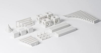

Learn how to optimize common design features - such as bridges, overhangs, pins and vertical axis holes - for FDM 3D printing.
As the most affordable 3D printing technology on the market, fused deposition modeling (FDM) is a great choice for quick, low-cost prototyping and can be used for a wide variety of applications. It can also be an effective solution for functional parts, such as enclosures.
Like all manufacturing methods, FDM has some limitations and constraints on what can be printed. This article explains how you can adjust your designs for optimal FDM print quality.
