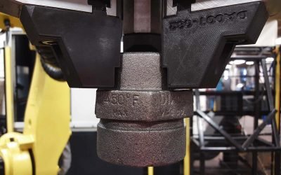

How Dixon Valve 3D prints robotic grips to save time and reduce costs
Dixon Valve’s US manufacturing facility in Maryland, USA, deals with thousands of different valves, fittings and gauges. Each product line requires custom equipment, including tooling and grips to hold specific parts efficiently.
To reduce costs and save time, Dixon Valve makes use of robotic arms in production line cells for part transfers. The custom grips attached to the end of each robotic arm used on the line require high strength, need to be user-friendly and safe, have chemical resistance due to the working environment and wear resistance from repeated use.
After comparing traditional manufacturing techniques to 3D printing options, a set of Onyx jaws (printed on a Markforged printer) were designed and printed for the end of each robotic arm. The time and cost savings are summarized in the table below.
| Cost | Time | |
| CNC machining service | $290.35 | 72 hours + shipping |
| Printed on Markforged | $9.06 (-97%) | 9 hours, 20 minutes (-87%) |
