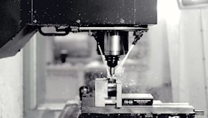

Specialized cutting tools, rotating at very high speeds (thousands of RPM), remove material from the block. First, the machine removes material quickly at a lower accuracy to achieve an approximate geometry. Then, it takes a few higher accuracy passes to produce the final part.
