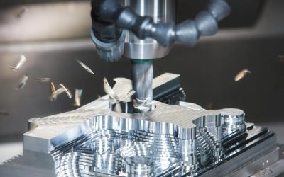

CNC machining is one of the most common subtractive manufacturing technologies. It uses a variety of rotating tools and cutters to transform a solid block of raw material—this is called a blank—into nearly finished components.
For both small one-off jobs and medium to high-volume production, CNC machining is one of the most popular methods of manufacturing. It offers excellent repeatability, high accuracy and a wide range of materials, post-processing options and surface finishes.

CNC machining offers tight tolerance and excellent repeatability. Very large to very small parts can be CNC machined accurately. Thanks to the shape of most cutting tools, internal corners will always have a radius, but external surfaces can have sharp edges and can be machined very thin.

CNC machining is mainly used to produce parts from metal. As it’s quite flexible, you can also use the CNC process to manufacture parts from thermoplastics, acrylics, softwoods and hardwoods, modeling foams and machining wax.
