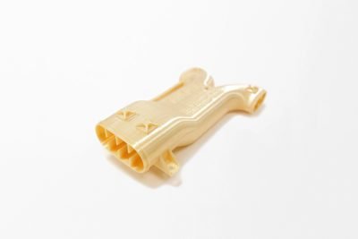

Rapid prototyping uses 3D computer-aided design (CAD) and manufacturing processes to quickly develop 3D parts or assemblies for research and development and/or product testing.
Rapid prototyping, commonly carried out through additive manufacturing, allows a designer to develop multiple iterations of a prototype without the additional cost or time that comes with using traditional manufacturing and design techniques.
