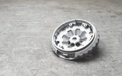

Direct metal laser sintering (abbreviated to DMLS) is an additive manufacturing technology that can be used to prototype one-off parts or manufacture low volume production runs directly from CAD data. Fusing together fine layers of powder, DMLS has the ability to produce very strong and accurate parts (± 0.05 mm/0.002 in.), from simple to complex geometries. This makes it a great alternative to machining parts.

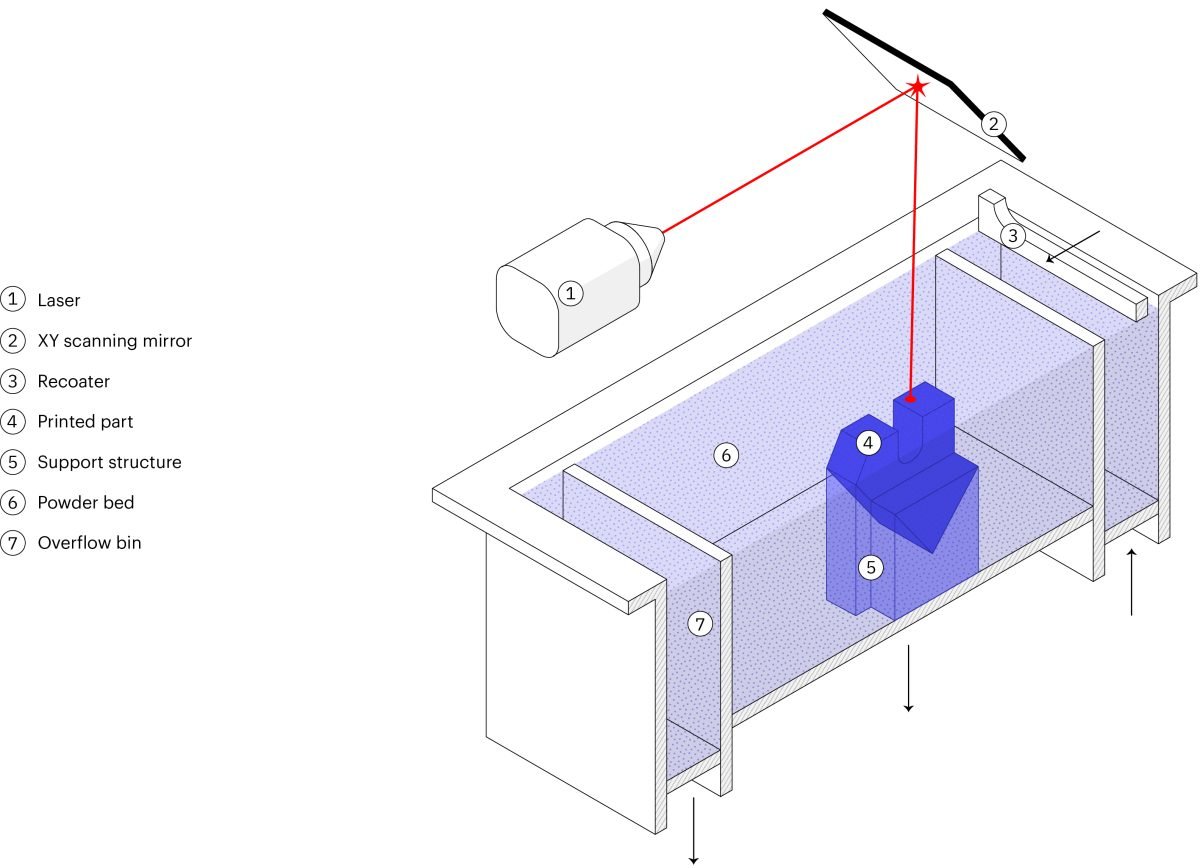

The DMLS process builds a part from an STL file, meaning that it slices the part into layers, similar to all the layer-based additive manufacturing techniques. This process uses a high power laser for sintering the metallic powder.
At the start of the process, a steel build plate is set inside a build chamber where there is less than 1% of oxygen and the atmosphere is controlled with an inert gas. This helps prevent the oxidation of metal powders during the building process and preserves the metal at an optimum quality as well as decreasing fire hazards and making the final product inert.
During the building process, the build platform is lowered one layer of thickness so that the coating mechanism (also known as the recoater) can move without collision. The coating mechanism distributes the metal powder evenly through the build platform and the laser beam through two-dimensional cross-section selectively sinters the powder into solid. This process of lowering the build plate of one layer thickness, the coating mechanism dispensing a layer with powder and the laser sintering it, is repeated until the part is completed.
Once the part cools down, the removal of the surrounding powder, which can be reused, follows. The final steps include removing the part from the build plate, support structure removal, as well as any required post-processing.

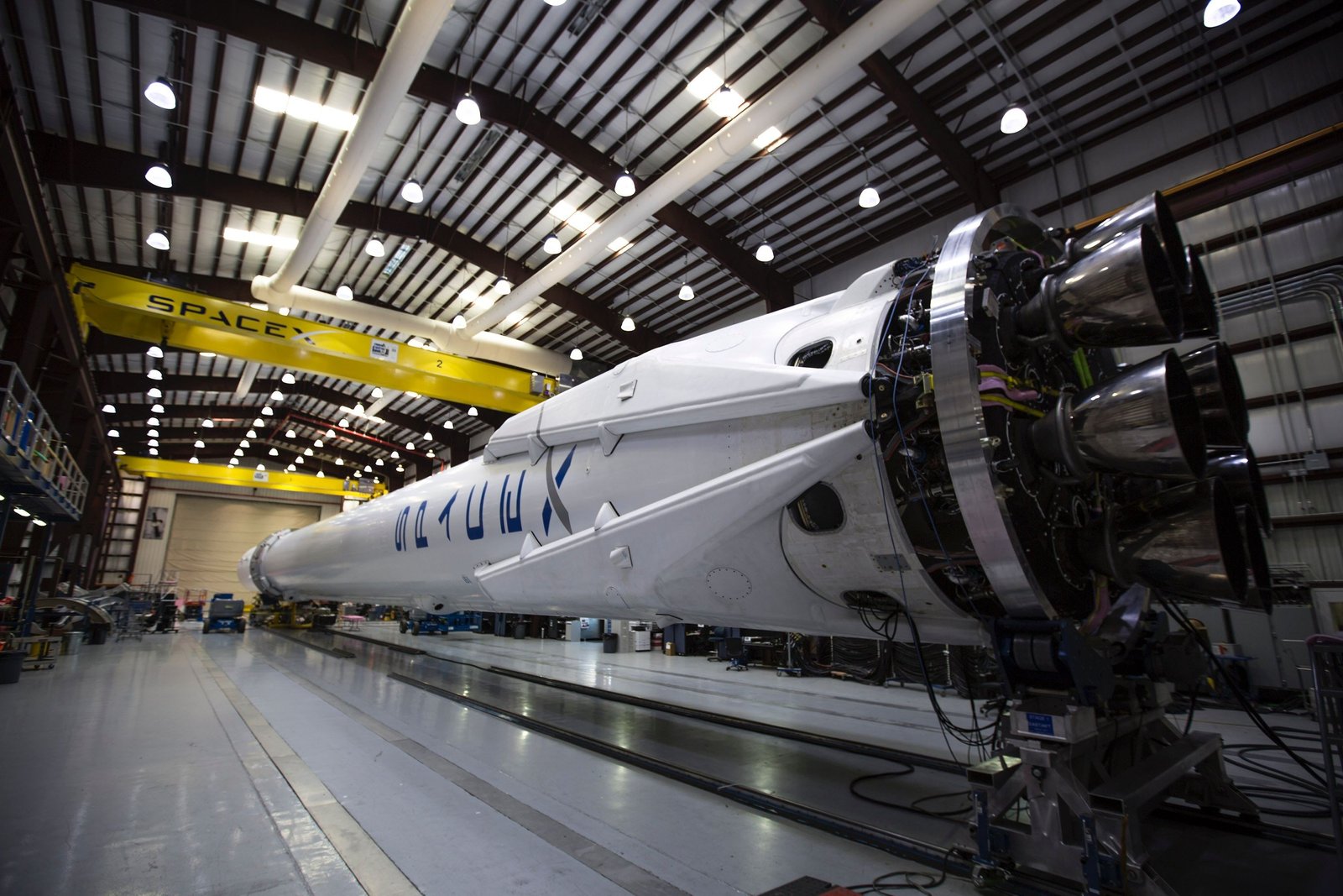

Since DMLS is often used for product development and testing, the technology can have many applications in the automotive, F1, jewelry, medical, and aerospace industries. It is most suitable for injection and blow molding tooling, wax injection, and press tools, all of which are processes used to produce functional metal prototypes or low volume production runs of parts.
Credit: SpaceX
For example, in the aerospace industry, DMLS is most often used to create strong, durable, yet lightweight parts for commercial aircrafts and rockets. Meanwhile, in the medical industry, DMLS can be used to build new surgical tools with complex geometries. This technology makes it possible to print custom parts at an affordable price while also meeting the necessary mechanical requirements of these tools.
