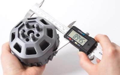

How do you measure dimensional accuracy in 3D printing?
To quantify the dimensional accuracy of 3D printed parts, we use the following parameters.
Dimensional tolerance - quantitative values from machine manufacturers and material suppliers that state the expected accuracy of parts. These are defined with respect to well-designed parts on well-calibrated machines.
Warping or shrinkage - the likelihood a part will warp or shrink while printing. While design plays a big role in determining whether parts will warp or shrink, some processes are inherently more prone to warping or shrinkage than others.
Support requirements - for many 3D printing technologies, the number of supports you have to remove after printing will affect the accuracy of a part’s surfaces and features.
