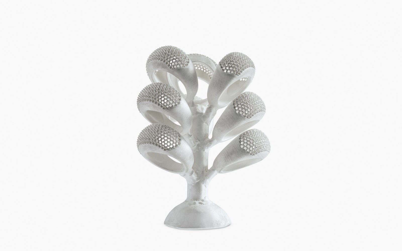

Very complex designs can be created. Historically, jewelry casting patterns were carved from wax using CNC machines. 3D printing is not restricted by the limitations of CNC machining and is able to produce parts that have in the past were impossible to make. Designs can also easily be customized.
With 3D printing, multiple patterns can be made at once and within a very short time frame. This has significantly reduced lead times as well as cost when compared to traditional pattern making techniques (wax CNC, aluminum molds for casting etc).
3D printing also allows multiple designs to be produced in a single print. This means it is very cost competitive pricing for low production volumes (an important issue for jewelry where customers typically want a one-off piece).

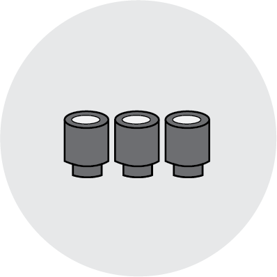

1. Pattern formation
Traditionally this was done by pouring a special casting wax into a metal mold. 3D printing now allows the pattern to directly be printed from wax or a castable resin.

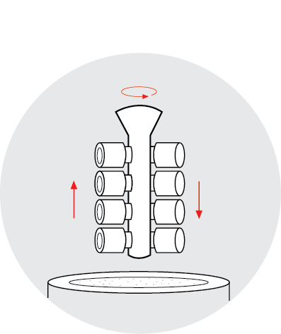

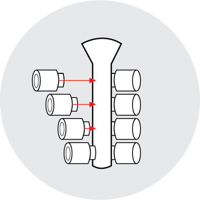

2. Mold assembly
The molded or printed pattern is then assembled onto a “casting tree”. This allows multiple parts to be cast at once. Some 3D printing methods disrupt this step by printing the part patterns and the tree in a single step.

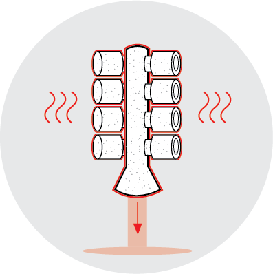

3. Shell building
After completion of the pattern assembly, the entire assembly is submerged multiple times in slurry. The slurry coating is then left to dry and solidify forming a ceramic outer layer over the pattern.
4. Burnout
The structure is then placed inside a furnace and the original wax/resin structure is melted/burnout resulting in a hollow negative mold (cavity).

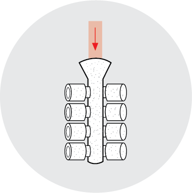

5. Pouring
Once all the original pattern material has been removed from the ceramic negative the final casting material is poured into the mold and left to cool and solidify. Parts are often cast in brass and then electroplated in precious metals during the finishing stage.

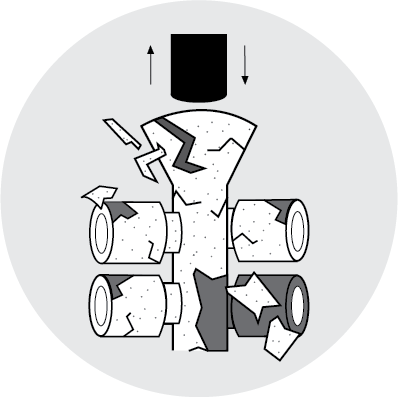

6. Knock off
The outer ceramic mold must then be removed. This is typically done by vibrating the mold to knock off the outer shell.

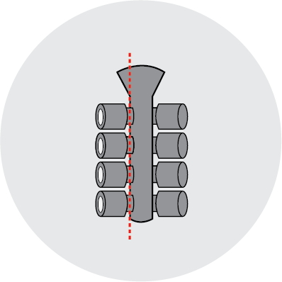

7. Cut off
After the ceramic shell is completely removed the individual cast items are cut off the mold tree.

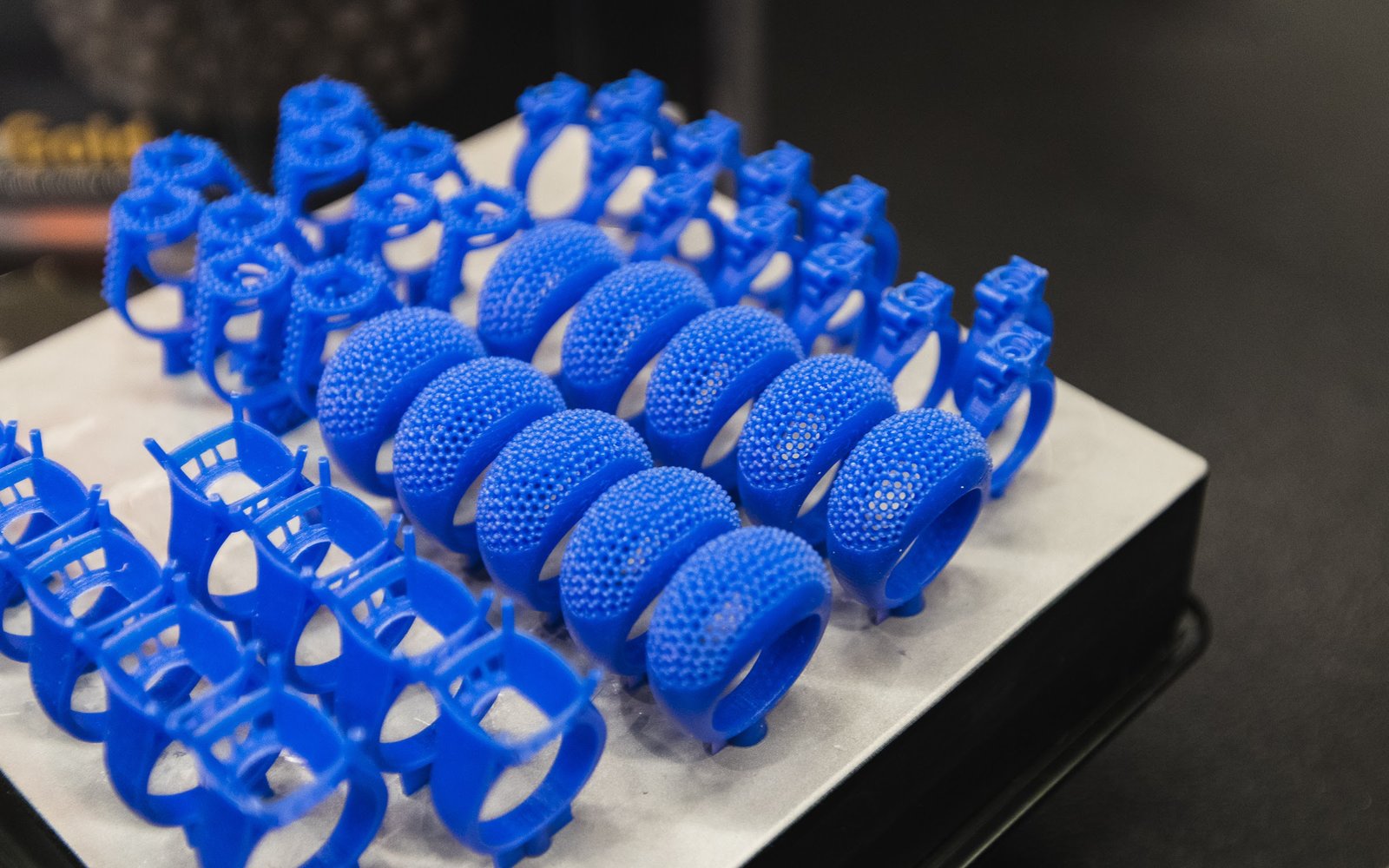

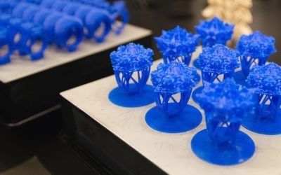

SLA/DLP
SLA and DLP are both vat photopolymerization techniques that photocure a UV sensitive resin one layer at a time to produce a solid part. SLA and DLP are capable of producing smooth, high detail parts from castable resins that have a very low remaining ash percentage after burnout. Both SLA and DLP require support to accurately print parts. Support material generally has a detrimental impact on the surface of a print it is in contact with and must be removed once the print has been completed. Some of the more common SLA/DLP investment casting materials are presented in the table below:

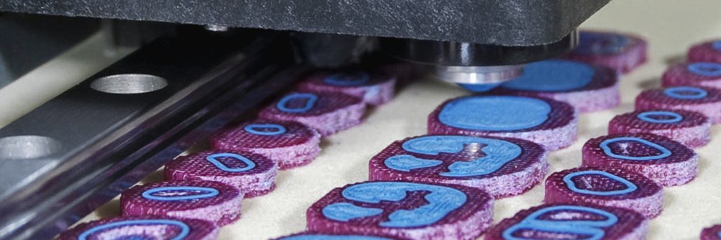

DOD
Drop-on-demand printing is a material jetting technique that uses 2 print jets; one to deposit a wax-like material over a build surface and another to deposit dissolvable support. The wax is deposited one layer at a time and a solid part is built up. DOD printers print at very high level of detail and offer several advantages over SLA/DLP printers including:
- Dissolvable support resulting in less post-processing and a better pattern surface finish.
- Patterns are printed with a wax-like material meaning the pattern is melted rather than burnt out eliminating the issues that arise with resin ash.

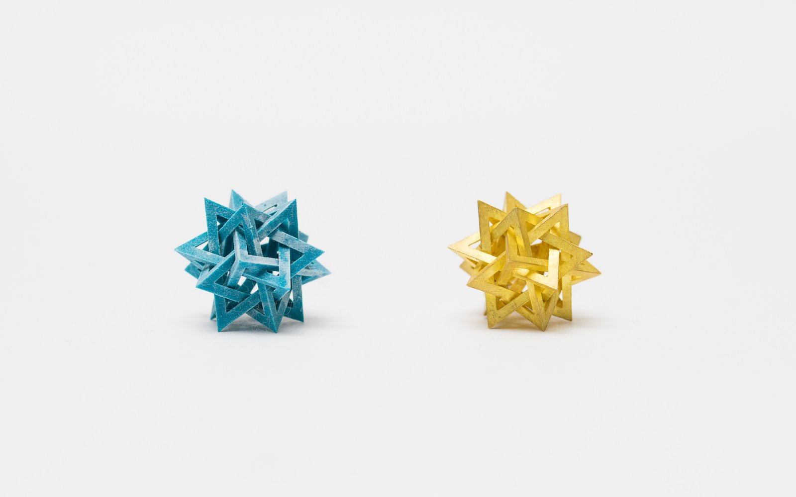

Direct printing

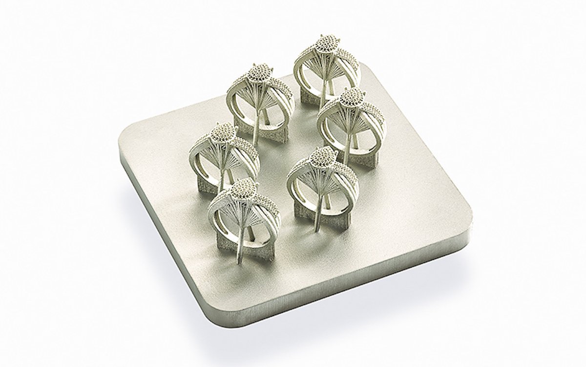

A much less popular method of producing jewelry via 3D printing is directly printing parts from metal powder. Parts are able to be printed via gold, silver or platinum alloys and then require a significant amount of post-processed to an appropriate finish. Direct printing of jewelry is generally more expensive than investment casting, even for one-off pieces, and requires a very high level of precious powder management.
DMLS/SLM
Direct metal laser sintering (DMLS) or selective laser melting (SLM) are powder bed fusion techniques used for the production of metal parts. To accurately produce parts DMLS/SLM require a significant amount of support to be included on the part during printing. High temperatures result in high levels of stress meaning parts are often susceptible to warping or deformation. This leads to significant post-processing being needed to remove the support and finish the surface where it was attached.
