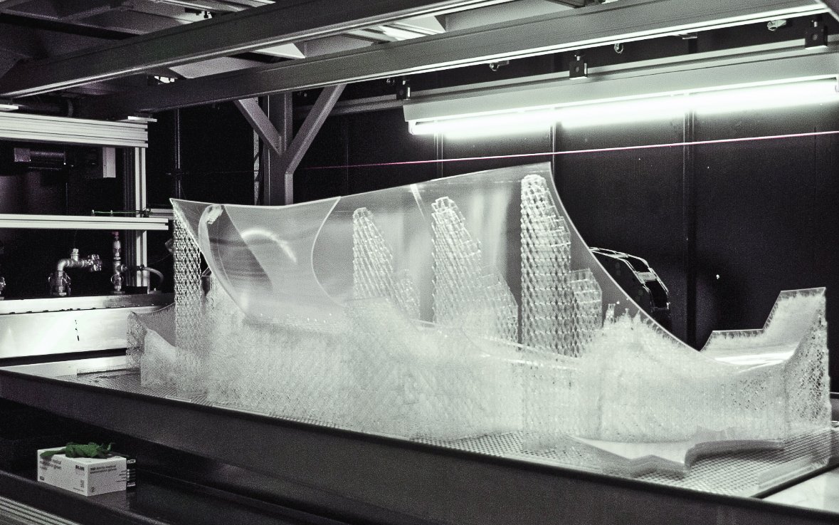

Accuracy
Industrial SLA and DLP printers are capable of producing more accurate parts than desktop machines. Industrial machines typically produce parts in a controlled environment, use machine specific materials and are constructed from high cost components. While desktop SLA or DLP are able to produce parts with a tolerance of 150 - 300 microns (with this increasing significantly over larger parts), industrial machines are capable of tolerances as low as 30 microns for any build size.

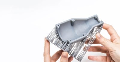

To accurately produce parts both SLA and DLP desktop and industrial printers require support material. If accuracy of part is critical, optimising support location and geometry is very important. Advice on designing parts for SLA can be found here.
Selection tip: Industrial SLA or DLP printers are more accurate than desktop and maintain better accuracy over larger builds. All prints produced via SLA or DLP require support.

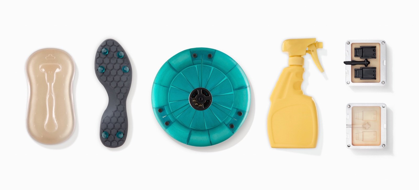

Materials
One of the biggest advantages of industrial SLA/DLP over desktop machines is the range of materials that industrial printers are able to print with. While desktop printers may offer a flexible resin, industrial machines offer a large range of flexible resins each with varying mechanical properties (Shore Hardness, high temperature etc.). SLA and desktop machines offer the most extensive range of materials out of all of the 3D printing technologies.
One of the limitations of most industrial machines is that they produce parts using a top-down approach resulting in the need for large resin tanks (over 100L). This makes swapping between materials difficult and can increase lead time on parts. This also makes these machines more expensive to maintain.
All SLA and DLP resins are susceptible to UV degradation over time, however, coatings applied after printing can help to mitigate this.
Selection tip: For designs where appearance is more important than function desktop printers are generally adequate. If engineering properties like temperature resistance, castability, transparency etc. are required then industrial properties offer a greater range of solutions.

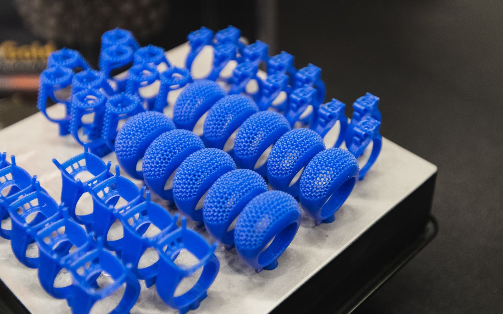

Production capabilities and cost
One of the benefits of 3D printing is that the layer by layer method of production allows for multiple parts to be created in a single build. One of the advantages of SLA and DLP printers is that there is no loss of quality when producing multiple parts on a single build platform. The parts produced are generally homogeneous and do not experience any of the anisotropic issues that relate to other 3D printing technologies.
Compared to desktop printers, industrial machines are designed for repeatability and reliability. They can often produce the same part over and over again and do not need the high level of user interaction that desktop machines typically require.
Industrial SLA and DLP machines are also capable of printing models without visual build lines requiring almost no post-processing (other than support material removal), which, when compared to other 3D printing technologies can greatly reduce lead time. Desktop printers require a high level of user maintenance and more post-processing of the prints.
The ability to batch produce intricate, customized parts make industrial SLA and DLP a popular method of manufacturing small parts, low-run production.
Selection tip: The bigger build volumes offered by industrial printers has seem them adopted as a viable means of batch manufacturing in the dental, jewelry and hearing aids industries.

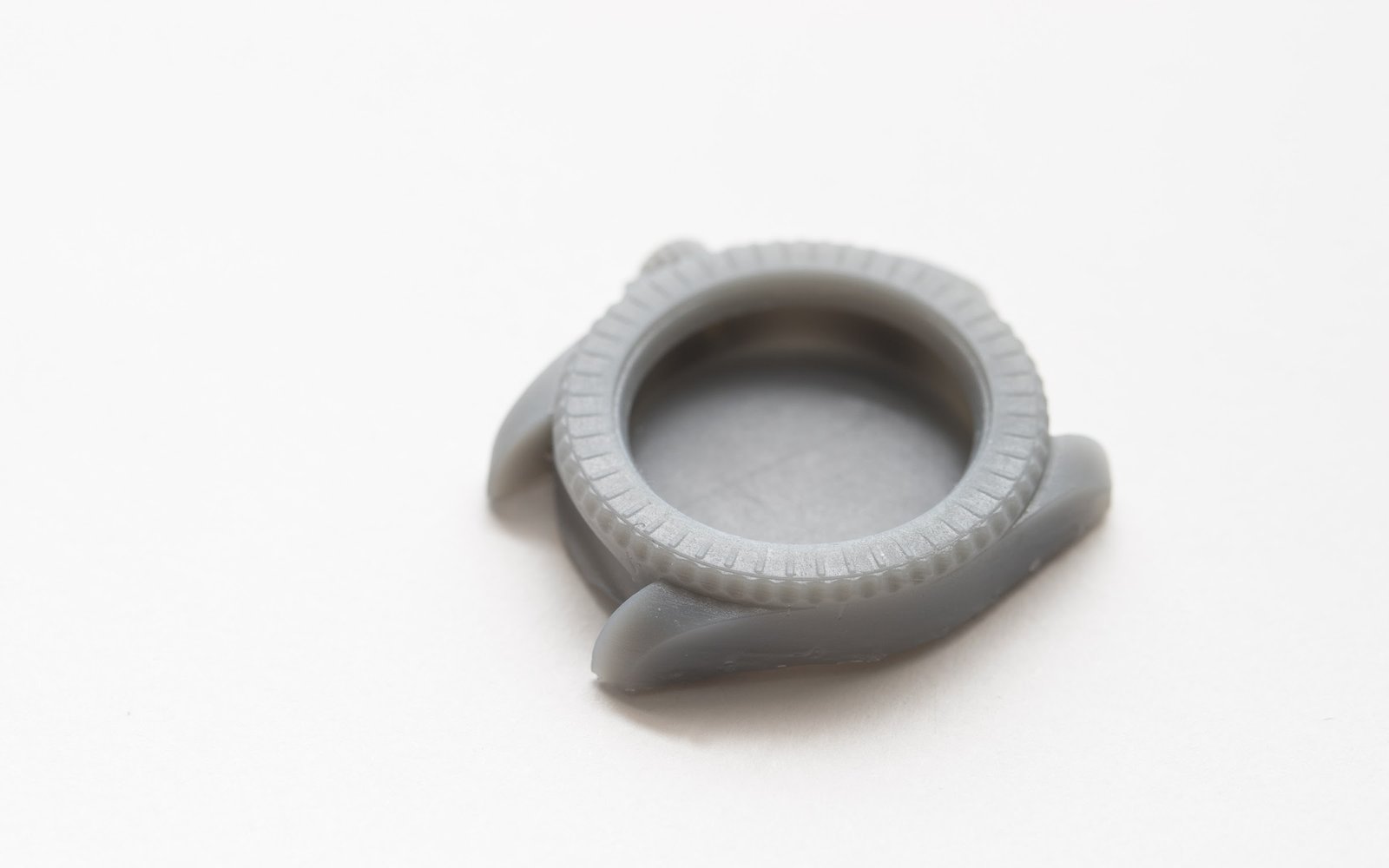

SLA/DLP expectations
SLA and DLP produce parts with smooth surfaces and high level of detail. Prints are often brittle making SLA and DLP best suited for non-functional parts or visual models. The requirement for support means that post-processing is always required. Industrial SLA/DLP machines are capable of printing finer supports with greater overhangs resulting in less post processing and better surface finishes.
