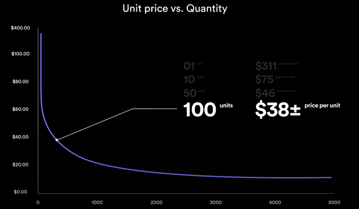

Tip 14 - Taking advantage of Economies of Scale
Take advantage of economies of scale by ordering higher quantities or placing a repeat order.
In CNC machining, the quantity greatly affects the unit price. This is because the startup costs are relatively high and, when quantities are low, they represent a big percentage of the cost. BUt for large quantities, the startup costs are almost eliminated as these costs are divided over many parts.
In this graph, we summarized the average unit price of 12 different parts machined in Stainless Steel 304. The drop in unit price is almost exponential: even a small increase in quantity can decrease the unit price by a lot. Notice that ordering very high volumes (> 100 parts) reduces the unit price by 5 to 10 times. The effect of economies of scale are noticeable also for low volumes.
