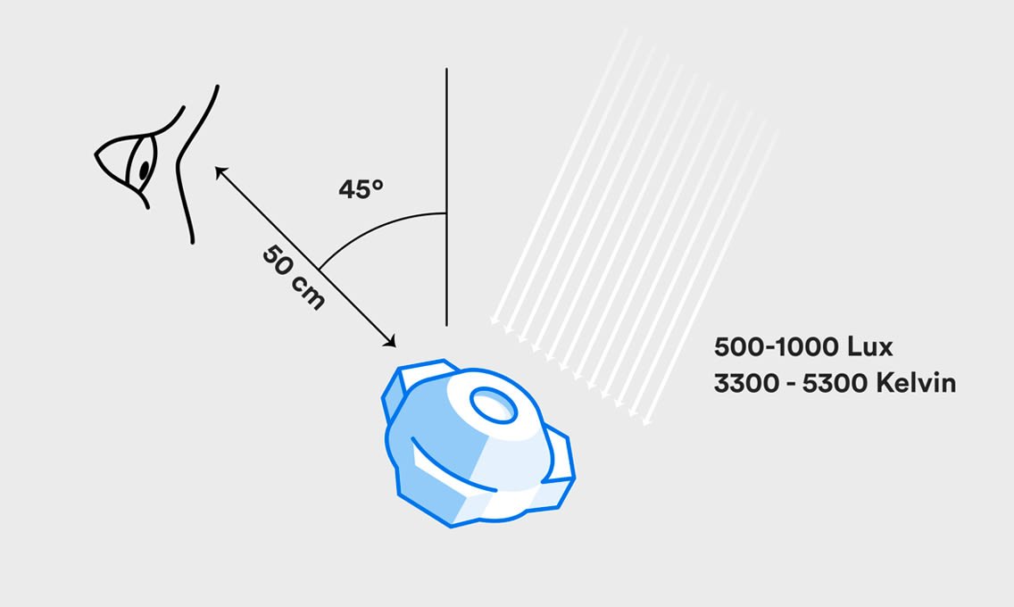

Visual inspection conditions
Surface quality on our side upon receiving will be visually inspected with the following conditions.
| Distance | 50 cm +/- 10cm with a 10/10 vision (or corrected) |
| Incidence angle | Approximately 45 degrees in all directions |
| Lighting conditions | 500-1000 Lux, color 33000-5300 Kelvin (neutral white) |
