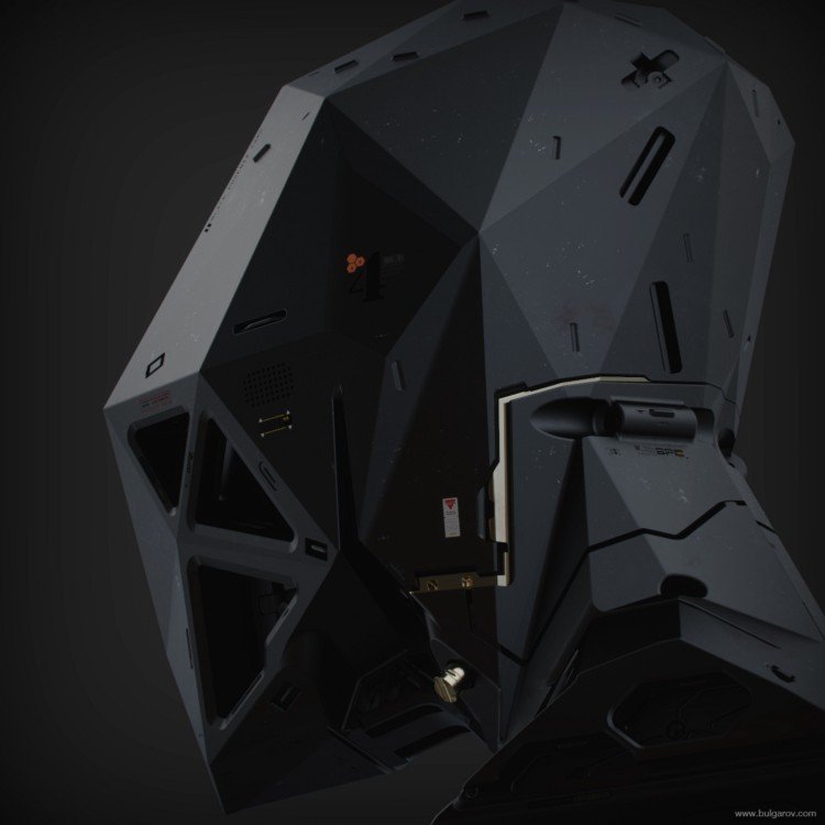

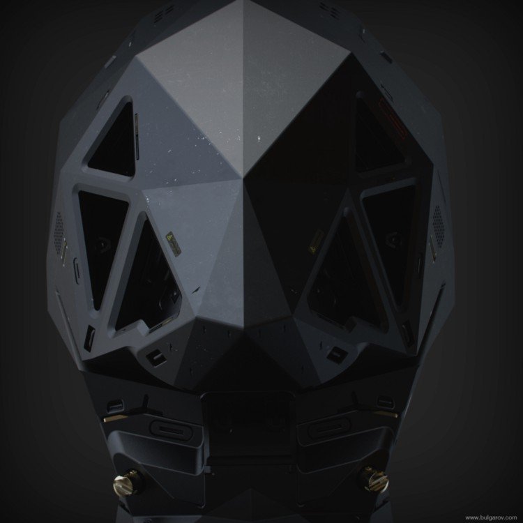

Working alongside Los Angeles-based 3D Hub Bulgarov watched his Ultraborg Stiffneck concept go from a simple drawing to a fully realized high-detail physical object:
3D renders of the final design

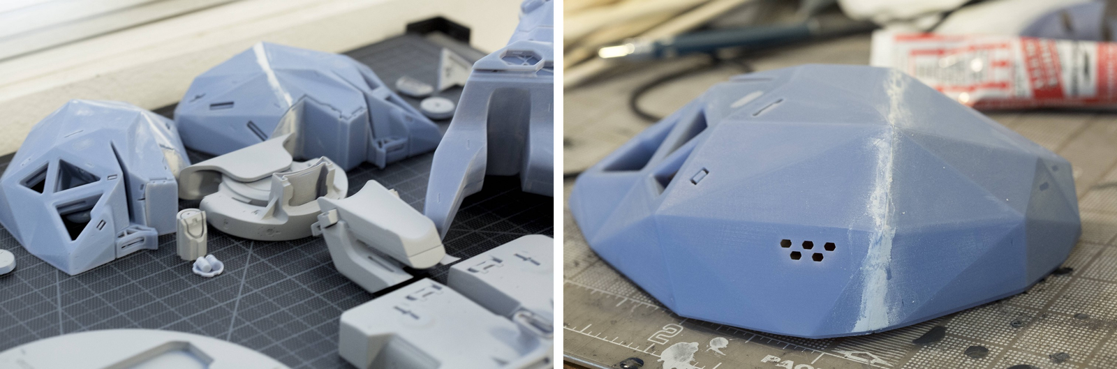

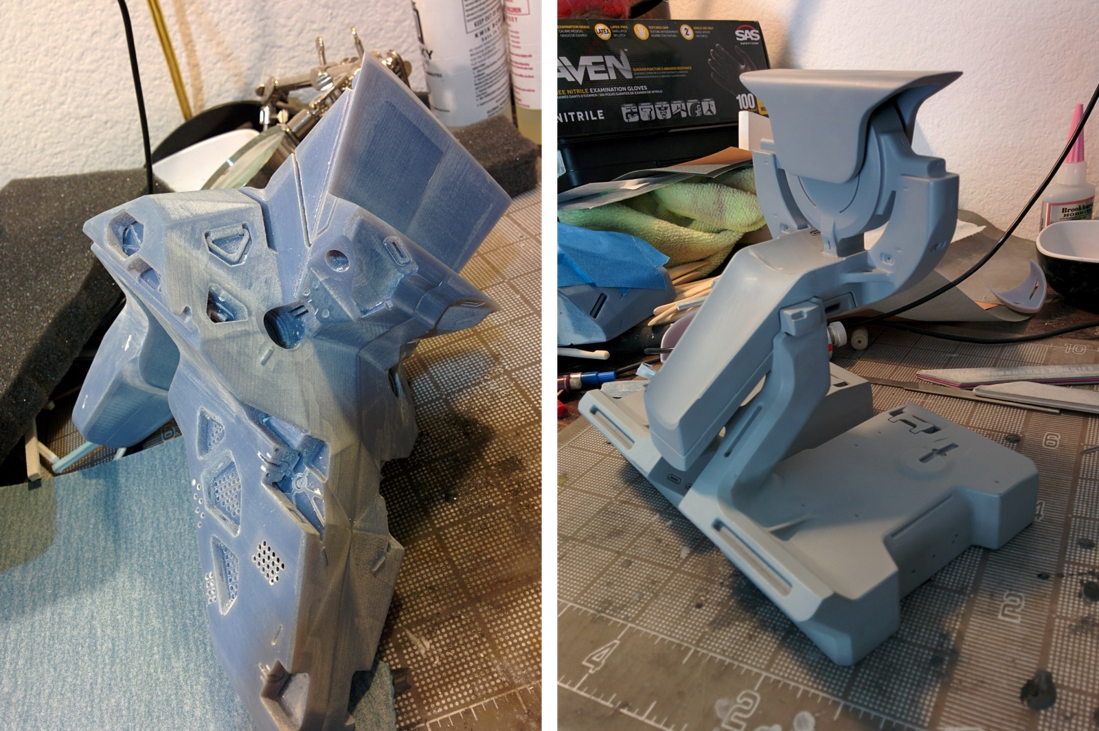

Cleaning and sanding the surface to get the perfect finish. While this isn’t necessary for all 3D prints, this design in particular needed to be perfect.
To cut down on costs, parts were split in half so they could be printed hollow, then be reassembled using epoxy. Once the assemblies were clean and dry, they were coated with several coats of primer.

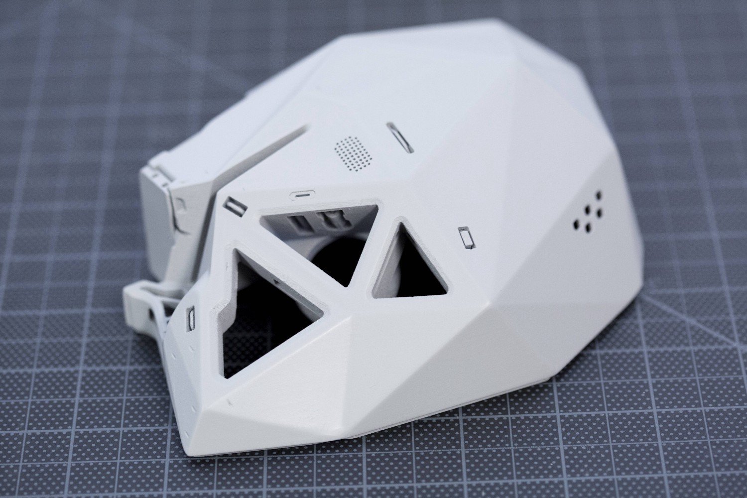

To achieve the final look of their 3D printed cyborg project, the team at Factor31 added between 4 and 8 coats of a special epoxy paint developed for using with firearms. Additionally, several small detail parts were given a chrome effect using glossy black paint and graphite powder.

Needless to say, the result is absolutely stunning and goes to show how quickly a concept design can go from a computer sketch to a usable physical object in a film or even for a cosplay costume.
The finished piece
