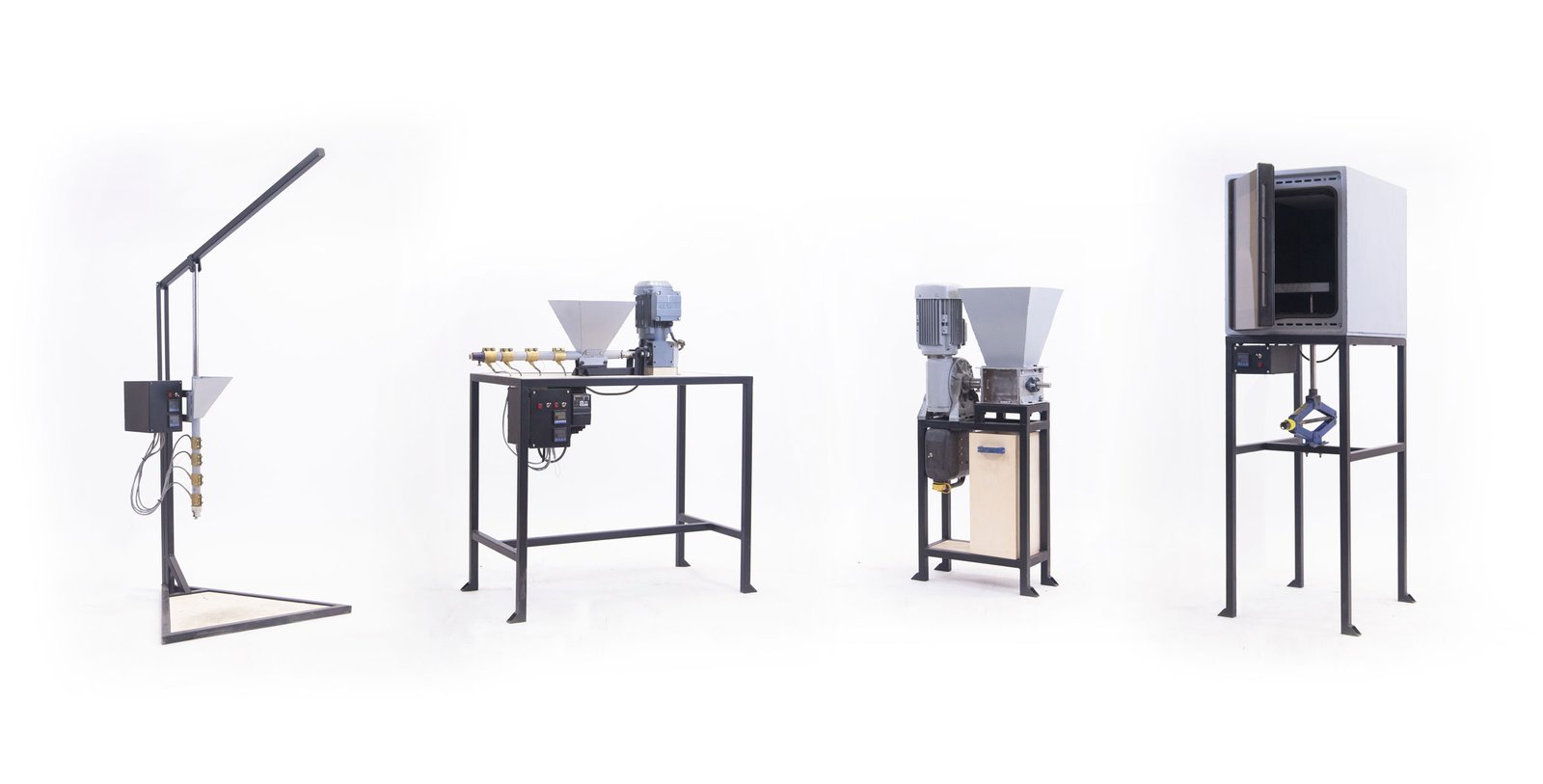

The project centres around empowering people to create their own plastic recycling centre, wherever they are based. Through this initiative, there are now 100's of locations worldwide taking old plastic and turning it into new innovative products for the environmentally conscious consumer. These centres utilise the open source range of machines, developed by Precious Plastic, including all the information on their assembly and operation.
The V3 collection of Precious Plastic recycling machines including (from left to right) an injection molder, extruder, shredder and compression machine

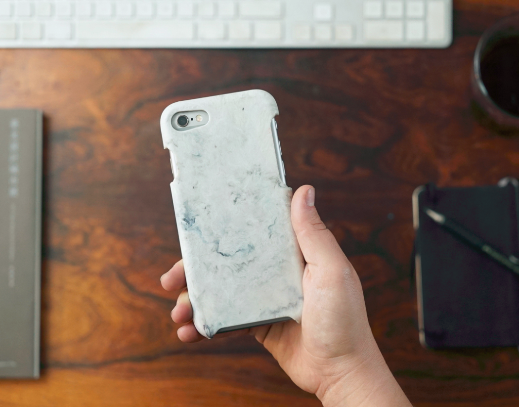

The recycled iPhone case was done to showcase the value of waste plastic and stimulate people to see it as a free resource. By combining high-end technologies with recycled plastic it shows you can create high-quality products that go beyond being a "recycled plastic product".

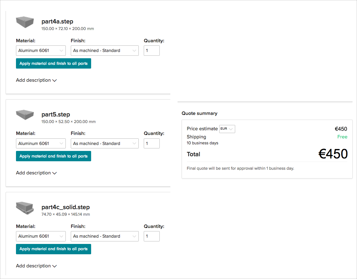

The quotation for parts

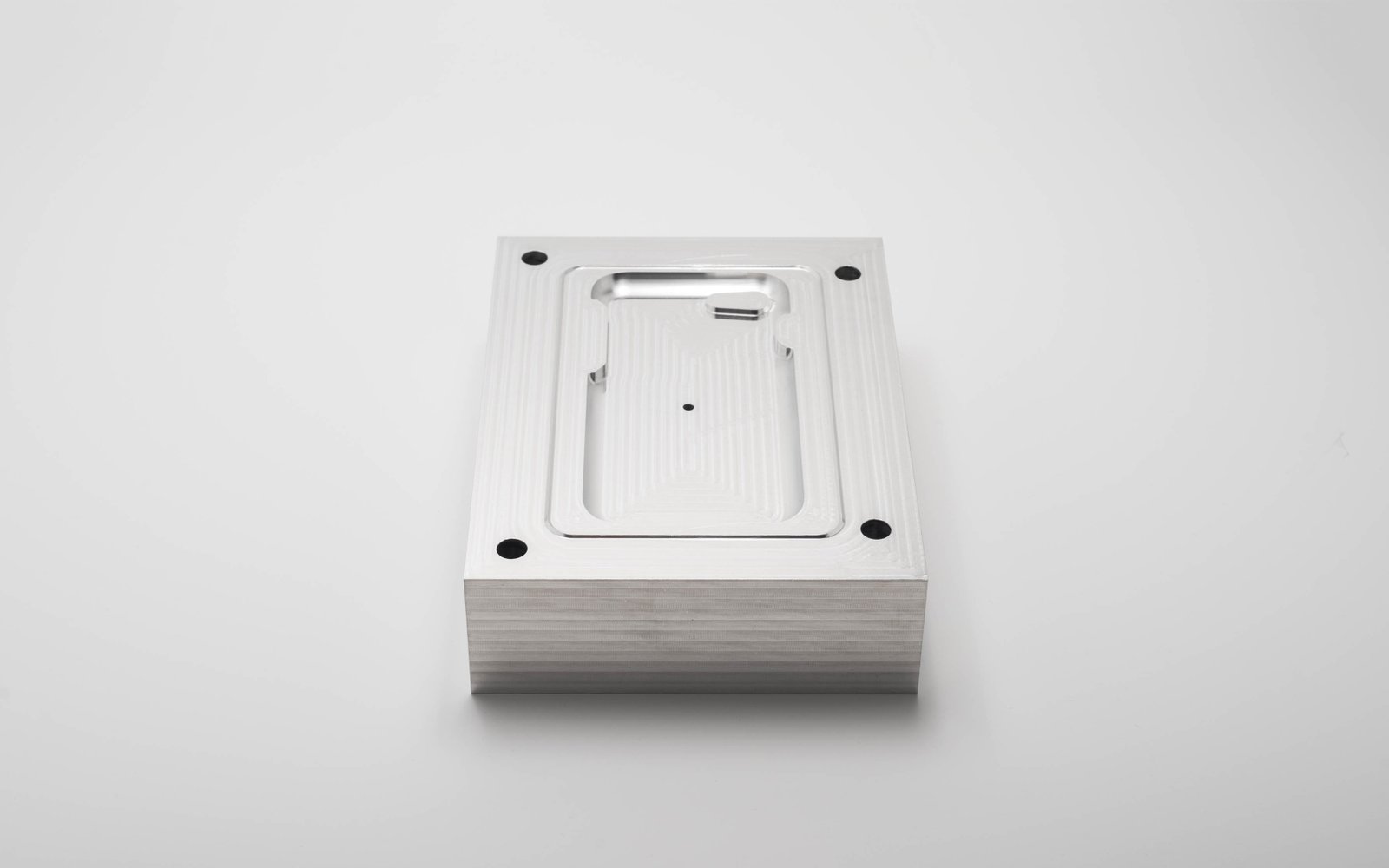

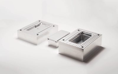

Jerry De Vos was the designer of the iPhone mold. He used a standard CAD file of an iPhone online and basing the design of the mold around it. Jerry knew that the parts he created for the mold could be easily machined due to their simple geometries. The reason CNC machining was used as the manufacturing method was a combination of the high dimensional accuracy (±.125mm) and the materials available (Aluminum 6061 used) that can withstand the heat/pressure of 100's of shots.

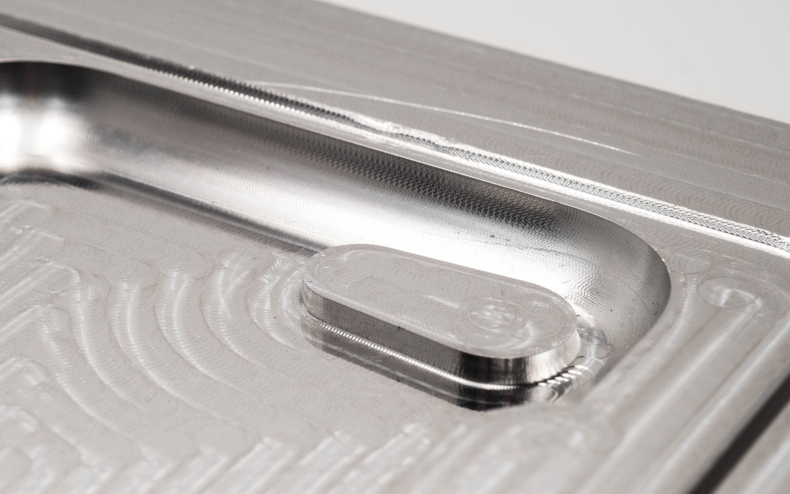

Top: Back of the mold. Bottom: A close up of the as machined finish of the part
An alternative approach could have been to use 3D printing with laser sintering (SLS) , but the price would have been a lot higher than the €450 they paid for the mold. Finally, using metal 3D printing (SLM) to print the molds directly was not a real good option as the designs were easily machinable and the added benefit of 3D printing was thus low. CNC machining also had the added benefits of being far more accessible not only in price but in regional availability.

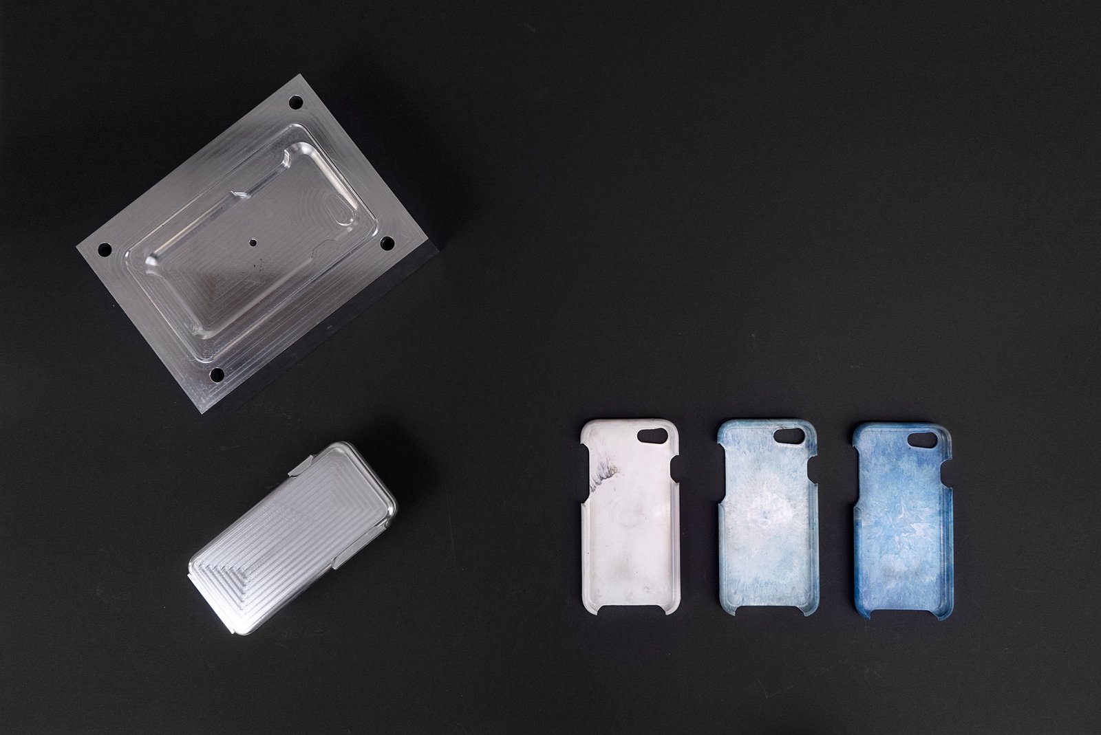

After the team received the mold they finished it off by adding threads, screws and some final touches before it was then attached to their home built injection molder. With one big push of the handle, the plastic pellets are pushed through the nozzle at the base forming into the shape of anything your mold is cut to, in this case, an iPhone mold.

Top: The mold alongside some of the iPhone cases created. Bottom: The iPhone case in use
The mold files are already being replicated across the world, with more molds being designed and shared with the Precious Plastic community. The product is then sold by their creators online, at markets and in stores from Lithuania to Kenya.

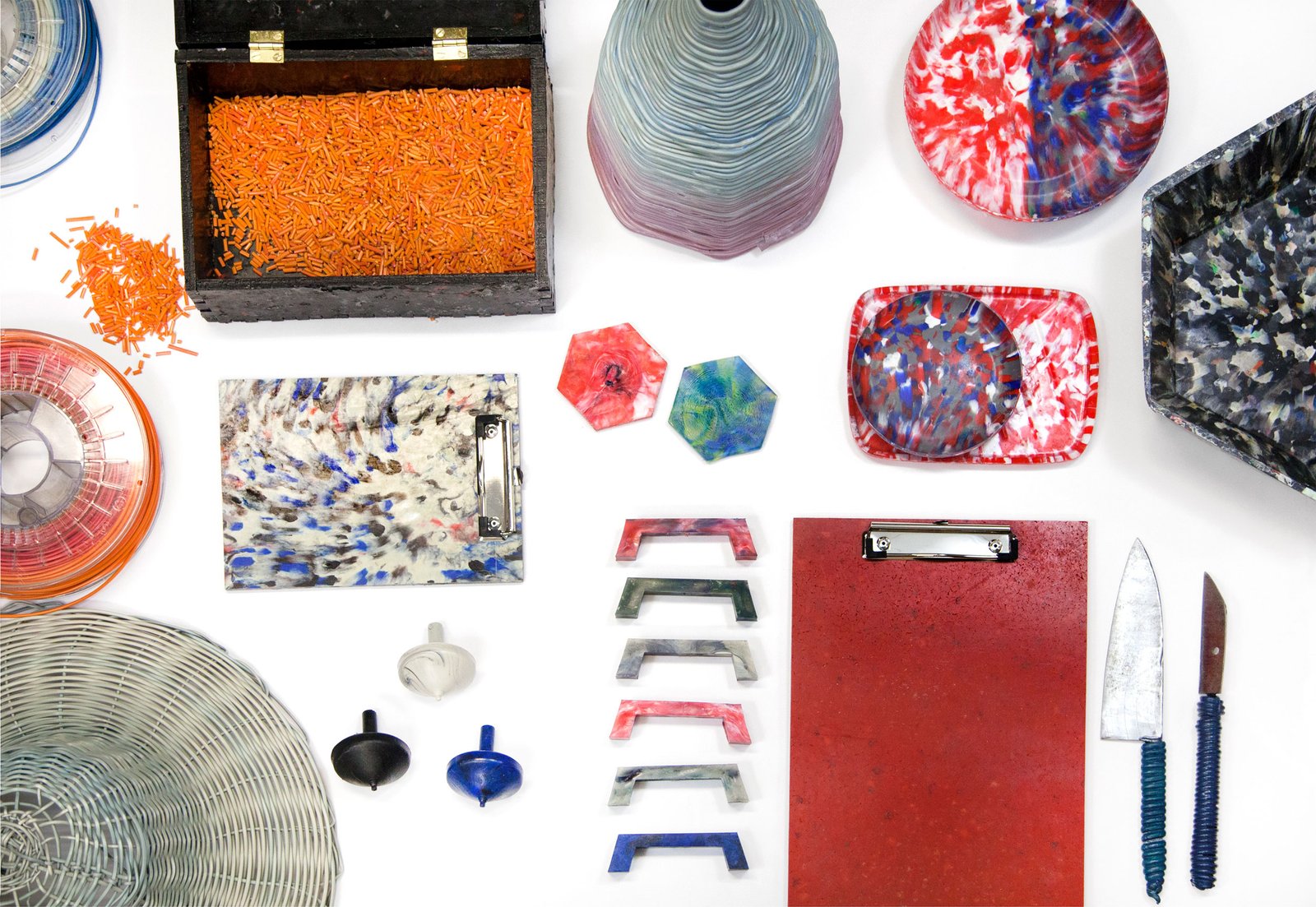

A selection of the current products being made by the Precious Plastic community
