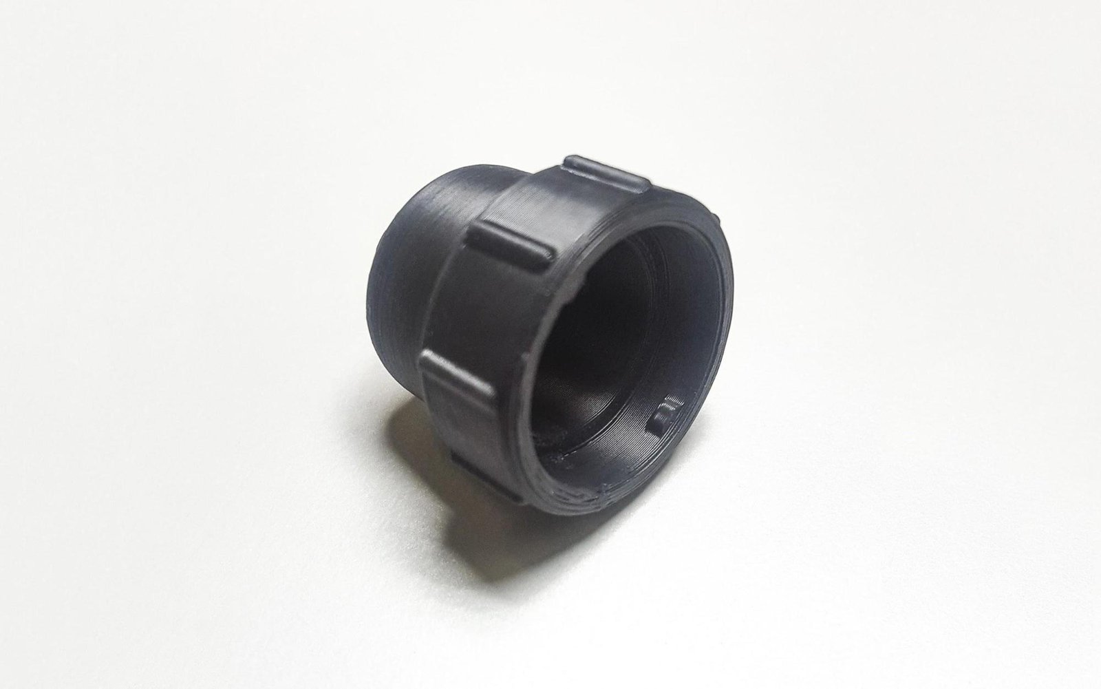

Due to the application of the part, high tolerances and a smooth surface finish were required. Even slight variations in the design would result in a part that would not fit as intended. Based on the geometric features of the cap, Peak Additive also needed to make sure the proper resolution was chosen in order for any features to be clearly defined.
Figure 1.1 - The details and features on the cap were easily reproduced using FDM printing
“The customer’s primary focus was to ensure the cap fit properly. Due to the accuracy of the Fortus 380mc, it held +/- .005” (0.127mm) on all critical dimensions. Through the Protolabs Network communication format, it was easy to have a back and forth conversation. This resulted in faster delivery of a high quality part for the customer. At the industrial level, this type of communication is integral to the overall process both for the customer and vendor.”

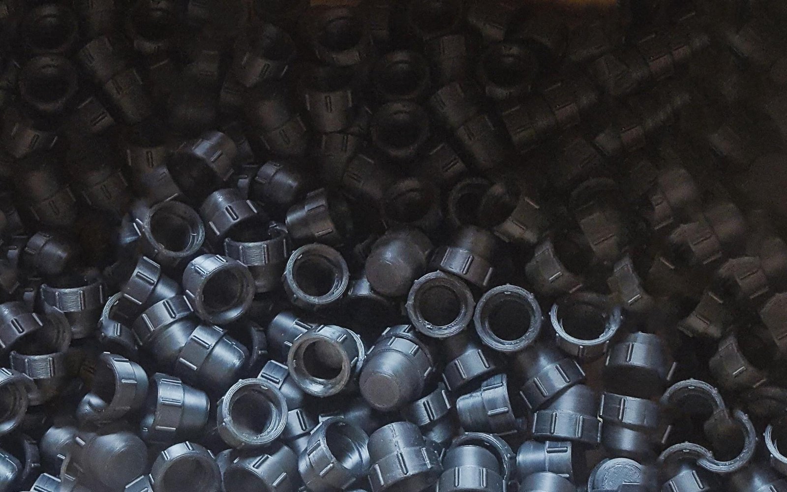

The end result was a part that was suitable for SureFire Electronics with a lower price than the same part made from Nylon 12. Based on the quality of the prototype and cost per unit, Peak Additive have obtained the contract to produce 200 - 500 parts per year after the initial run of 150 is complete. The project also generated additional discussions with SureFire Electronics about other parts that can be produced using the same process.

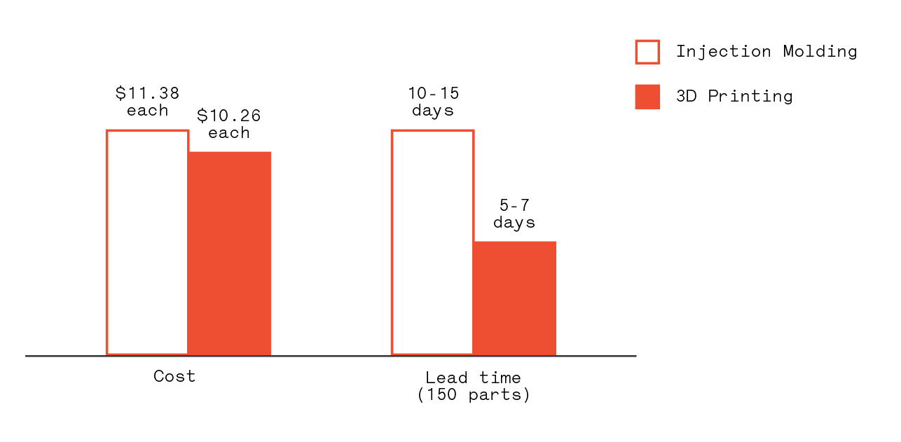

Figure 1.2 - Injection molding vs 3D printing cost and lead time comparison for the production of 150 USB caps
Total savings from 3D printing - $168 and 7 days lead time (not including the initial tooling cost for the injection molding)
Figure 1.3 - The final caps printed from ASA via FFF. Image courtesy of Peak Additive
