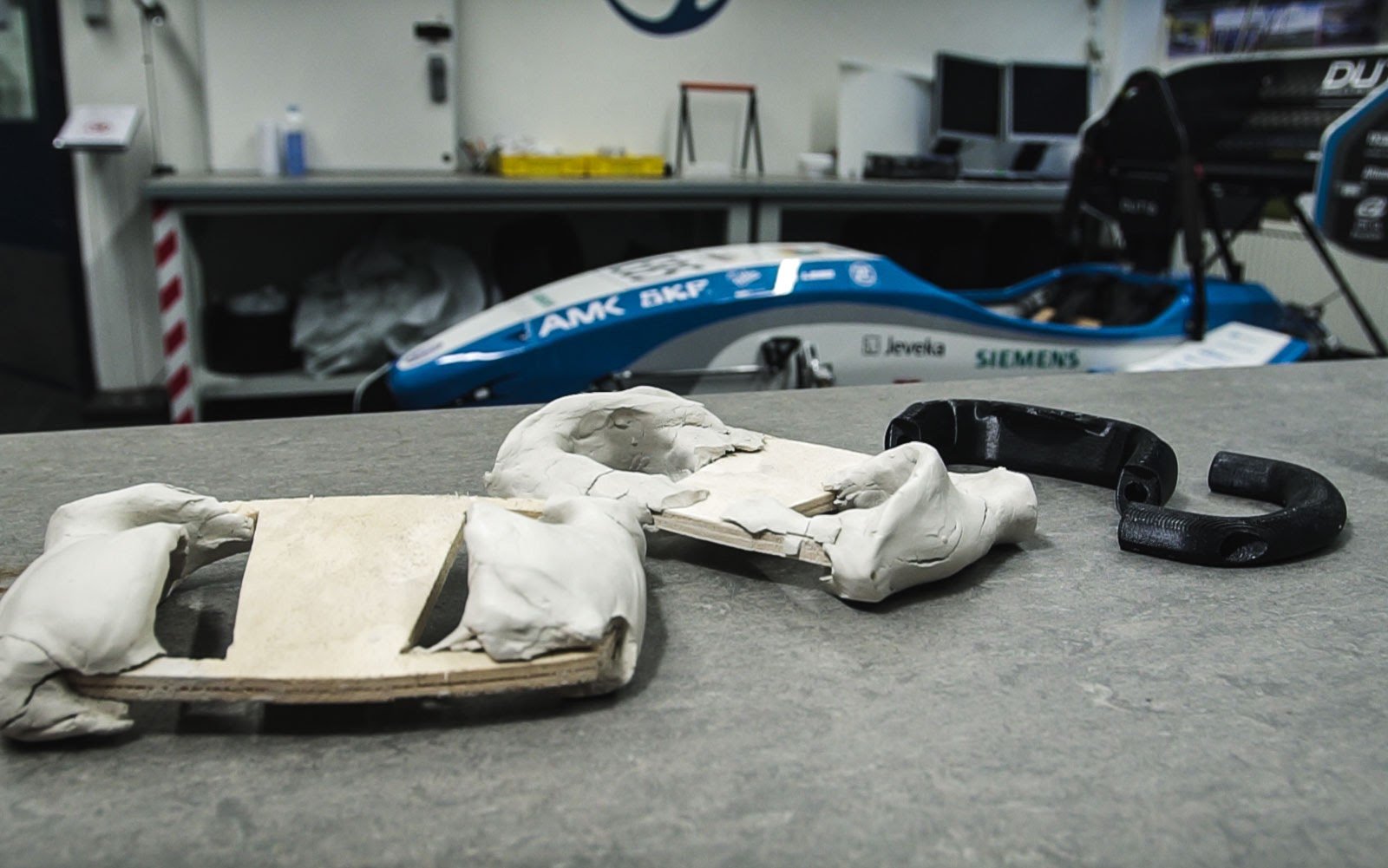

The process of creating the steering wheel began with a very rudimentary laser cut piece of wood, with clay stacked on top of it. This was then pressed with driving gloves on to create a rough outline and 3D scanned into modelling software.

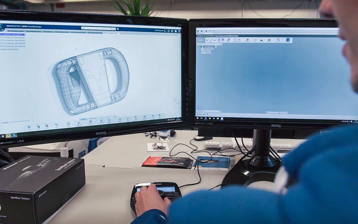

During the modelling process, they wanted to create a steering wheel that didn’t need supports so that it would print in a short amount of time meaning those iterations could be churned out as drivers tested them. The three drivers that tested the wheel were all found to be using the steering wheel very differently, with some of them using under-grip, over-grip and standard grip respectively.
Designing the steering wheel in Solidworks before prototyping it with FDM technology

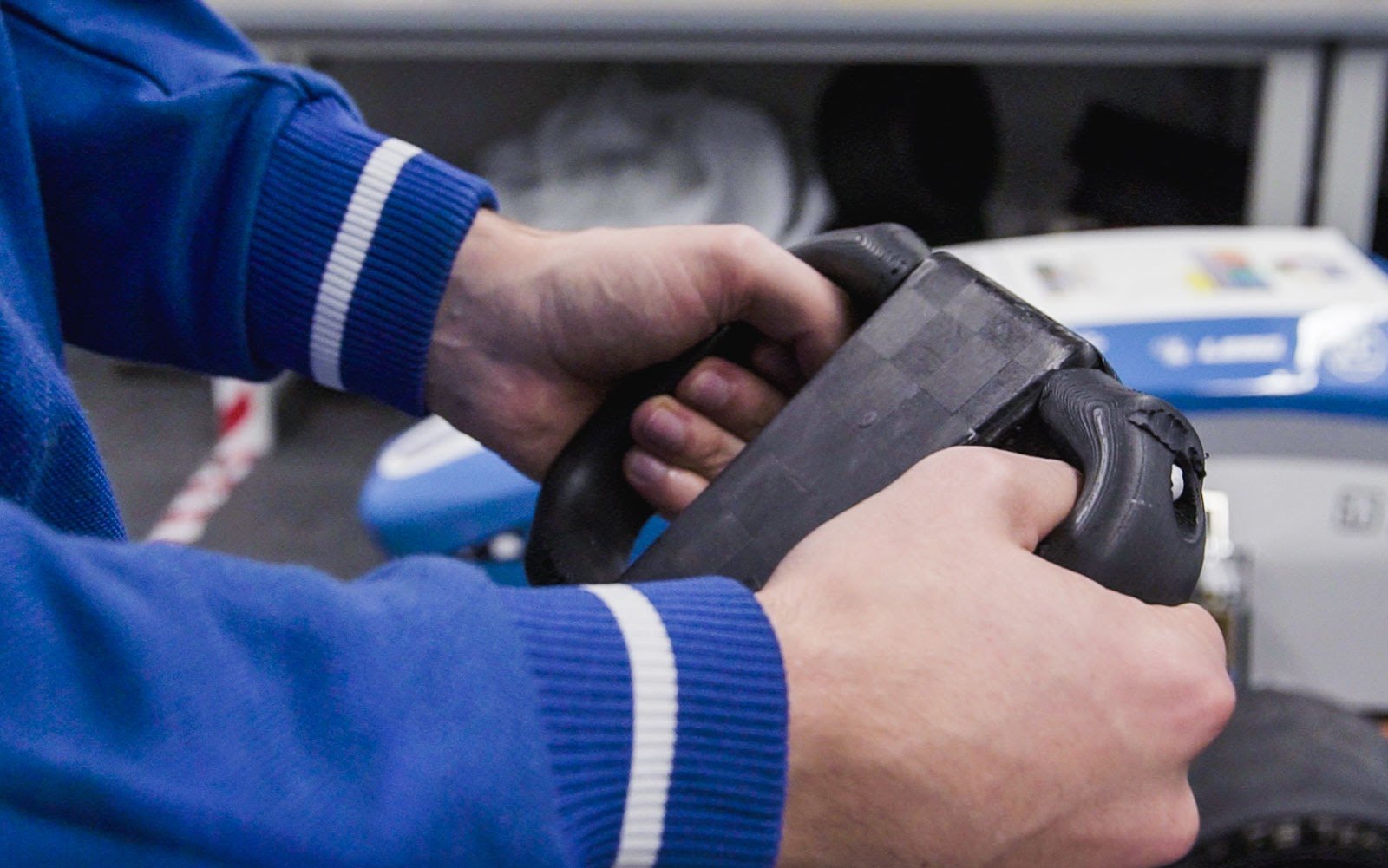

“The steering wheel is in a narrow space and needs to be able to deal with lots of force, drivers need to be able to really dig into the shape and apply force around corners. It being strong and having a good grip instills confidence in the drivers.”
The clay models that helped design the contours of the steering wheel

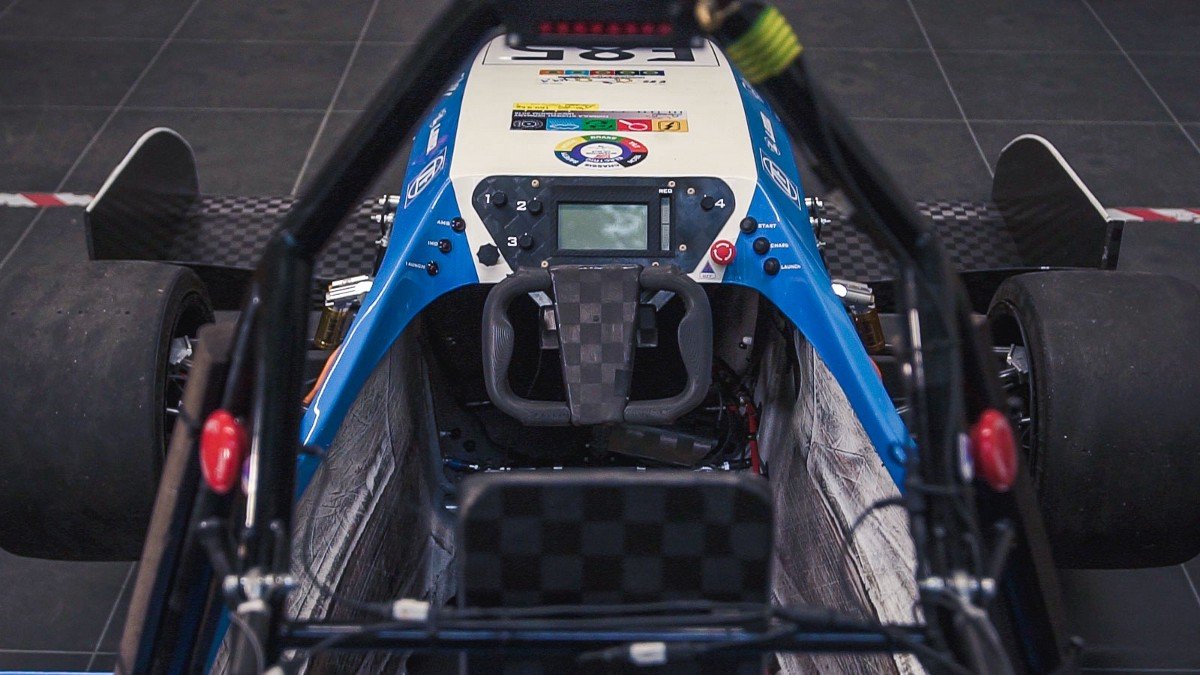

The material journey of the steering wheel went from clay, FDM PLA, FDM Colorfabb XT and the final end-use part was made with FDM Colorfabb XT- CF20. These are some of the reasons why XT-CF20 was chosen:
- High Flex Modulus (6.2 GPa) / twice as stiff as PLA
- Moderate strain at break (8–10%)
- Good dimensional accuracy and stability
The steering has held up for all of the current 2016 season, with no signs of giving way helping the team to 2 out of 3 podiums this year. A great example of 3D printing offering versatility in its unique ability to adapt with low lead times and low cost.
The finished steering wheel built for all three drivers grip styles

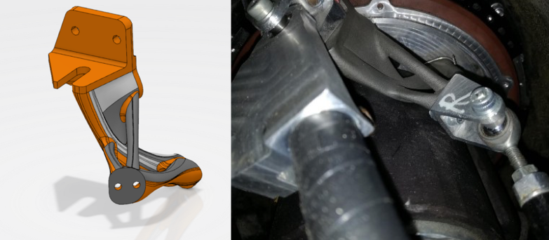

A less visible part of the car also used the benefits of 3D printing but for a different reason than price/speed. Metal 3D printing, a more familiar technology for the automotive industry, was used to create an integral bracket which connected the steering rod of the inner wheel to the front of the vehicle.
This part was created in Titanium using a process called direct metal laser sintering (DMLS) whereby a mechanical arm spreads a thin layer of fine titanium powder down onto the print-bed while a powerful carbon dioxide laser melts the powder and fuses the titanium together.
Due to the powder bed technology of the printer, the geometries that can be made can be extremely complex. Having a complete bed of powder that is sintered means that the object doesn’t need complex support structures as it’s surrounded by powder, unlike FDM which is extruded, not sintered. Jonas explained:
“The reason we used titanium 3D printing for the part was that it simply couldn’t be made in any other way, we needed very specific geometries for the loads that were being applied”
The cad model of the bracket next to the bracket in action
Consideration was given to the compression forces and heavy vibrations components would be subjected. The component traditionally would have been a relatively large assembly but thanks to the design freedom, they were able to create the bracket in one piece making it lighter without comprising strength.
This shows two clear benefits:
Reduce the number of components in the application resulting in faster assembly and lower requirement for parts.
Complete design freedom compared to traditional manufacturing constraints.

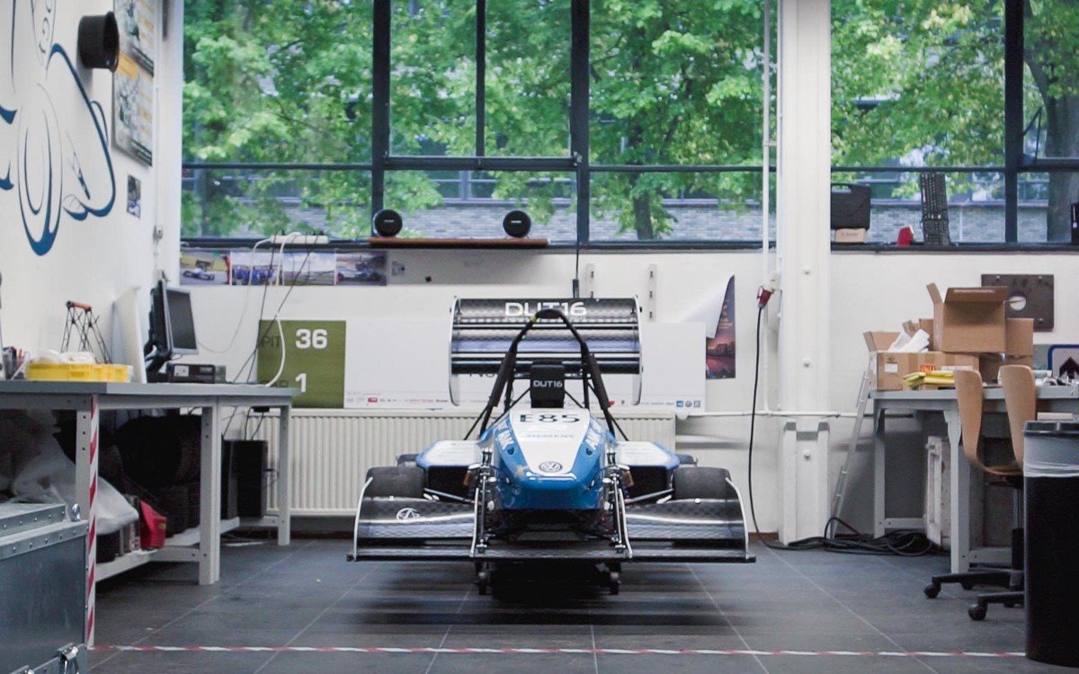

Front view of the race car displaying its aerodynamic build
