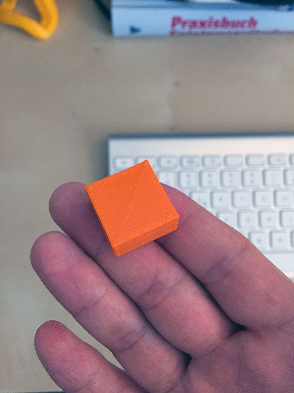

Take a look at the attached images. Resonable tollerances?
That’s nice, but it’s not very convincing. The top surface looks slightly over-extruded, which isn’t a problem when you print with infill, but can be an issue when you print something at 100% solid. Maybe that’s not a big deal. But look at those corners – they are both rounded and bowed. Print a cylinder that’s 2mm OD, and another that’s 80mm OD, and compare the error with the model. Print a hole that’s 2mm ID, and another that’s 80mm ID. Print a part that’s 15cm long and 2mm wide. Print a part with supports. Print an overhang without supports. In my experience, these machines do not hold the tolerances that the bigger machines do. That’s why they still make them and charge so much.
You don’t have to sell me on an UM2, I have one and love it. But I’ve had machining equipment, and done injection mold design, and worked with industrial 3D printers (FDM, SLS, PolyJet, etc). The UM2 is an awesome machine, but we need to be honest in this conversation.
