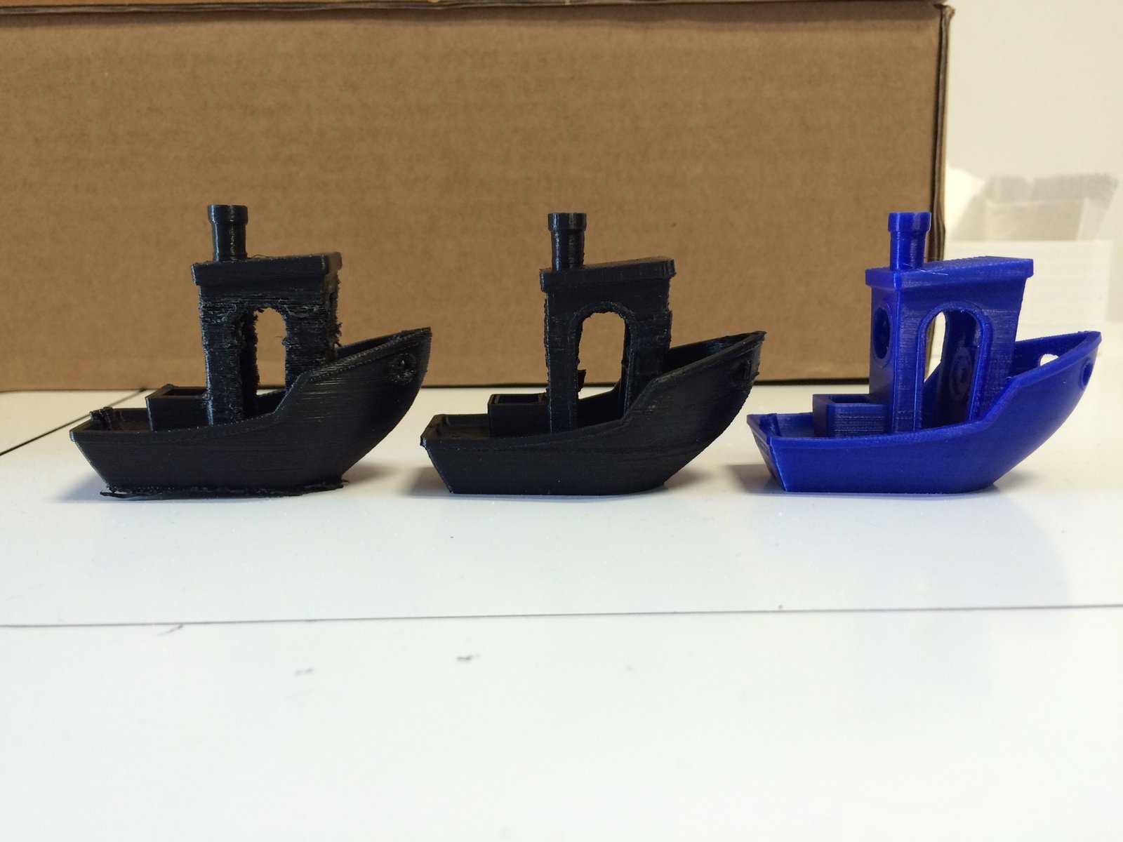

from the left: #CubePro (PLA with INF), #CubePro (PLA), Makerbot (PLA)
