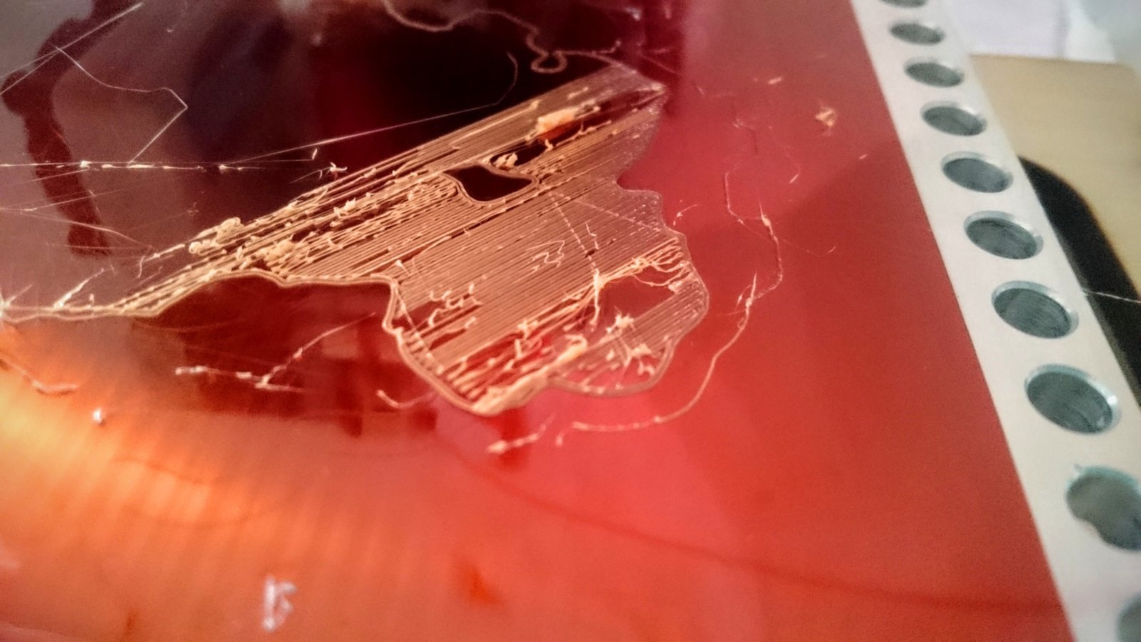

To me looking at the photo it almost looks like the nozzle is too close to the print bed causing the nozzle to drag across the print and lifting what has already been put down.

I thought the same initially - but raising the extruder wont make a difference…

This looks like the Jr V2 with the Aluminium Extruder upgrade and I have worked with one of these for ages and they’re quite stable. Have you tried different sliced models? do you have some previously sliced GCODE that you can try and print with?
The first layer does normally print slower, but parts of the print look okay, apart from a little squashed and not sticking particularly well (which is why I asked the first question).
