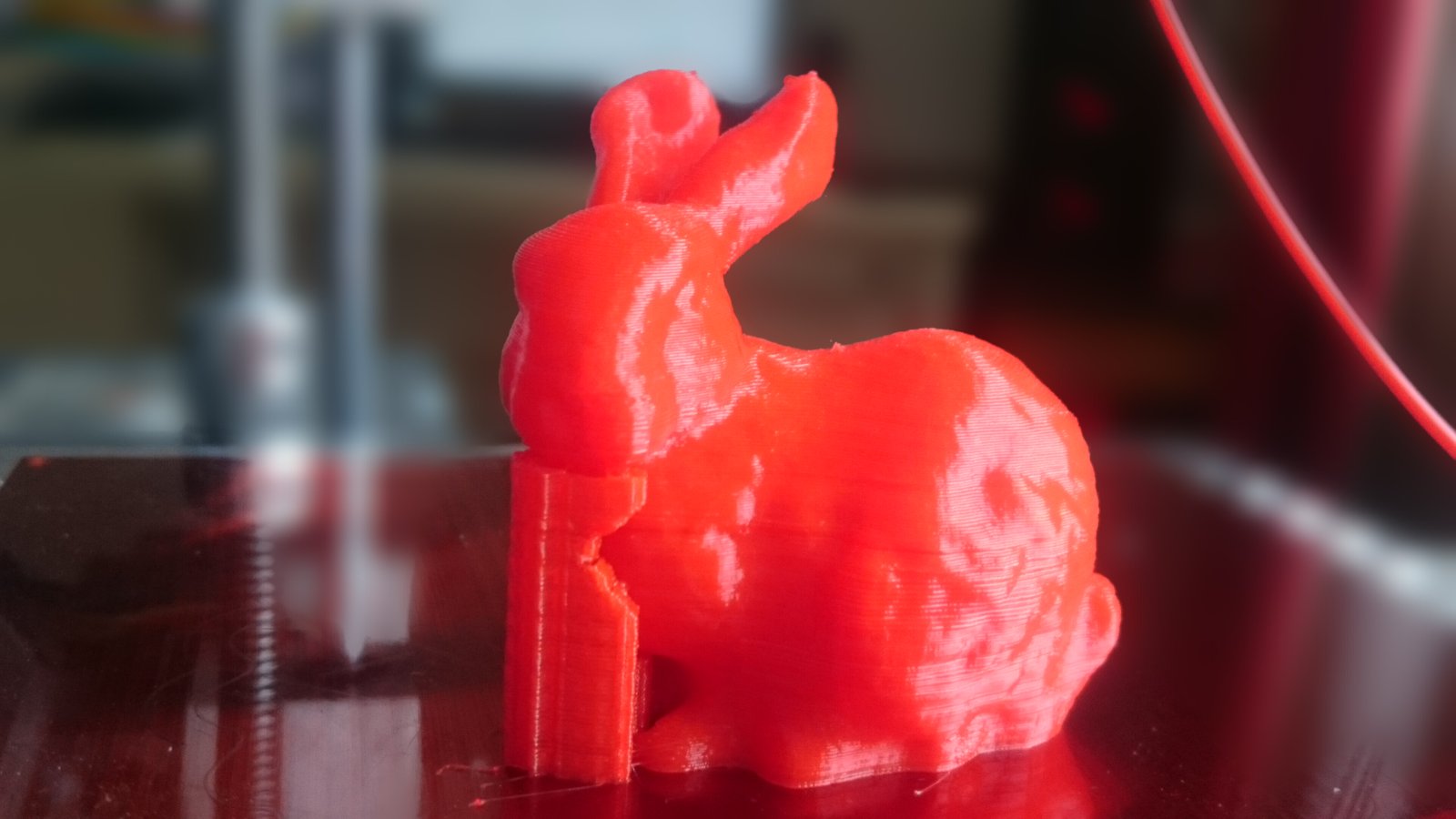

UPDATE: as many suggested I removed the nozzle and cleaned it out. Same for the the ‘screw’ part on the extruder. I checked every screw and tighten it where needed. Furthermore I took the ‘tensioner’ apart and screw it back together.
That worked!
Here is a freshly printed bunny to thank you all for your suggestions!
