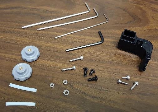

I also just picked up the same PowerSpec 3D Pro 2 printer yesterday at MC. It’s all together but I do have a few parts that I can’t figure out what to do with. There are screws, nuts and 2 little thumb-wheel grey screws with brass inserts.
Are these just spares?
Also there’s the little black piece that I have no idea what it is for. The “sensor” cable shown in the pdf manual didn’t come loose in the box and looks like it’s possible already installed. Guess I will find out on that one.

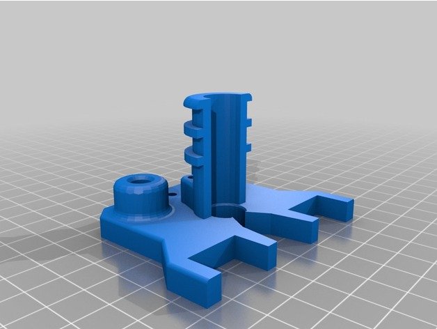

There are tons of spool holders on Thingiverse, but I’m attaching the ones I came up with. These plug up the side handle holes, plus allows you to put the spools on the sides. They are designed to handle the large-hole spools that Microcenter sells. I generally feed the filament around back and under the same-side, back factory-installed spool holders, then up into the filament guide tubes. Haven’t had an issue after printing dozens of spools through the printers (I have two PowerSpec 3D Pro printers).

Sounds great, thanks for that tip! Any idea what the 2 white tubes and the little black plastic piece are for?
Still scratching the noodle on those.
Two white tubes are replacement Teflon tubes that go up inside the print head just above the tip. These eventually brake down from the temps the print head runs at, especially at 250c for PETg. Don’t change the length. Will have to review the image again for the black parts you mentioned.
The black part in the image is the fan duct for cooling freshly printed layers of PLA. Install that.
