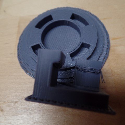

I am attaching my first few parts.

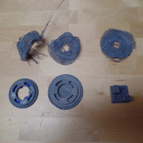

The first pic is a progression. Top left is the first print. Bad. The bottom left is the 4th print. I tried painters tape since I was having a really hard time getting parts off the bed. Doesn’t work very well with the heated bed at 100C!!! It also wasn’t right size wise.
The next print to the right is after I bought Simplify3D and found all the parameters for bed temp, raft layers, etc. It popped off pretty easy and fits. These were the spool adapters.
The last print bottom right is the glass bed clamps. They turned out pretty good except for the drooping.

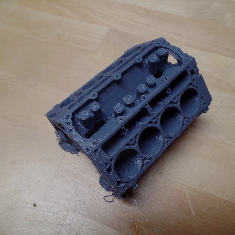

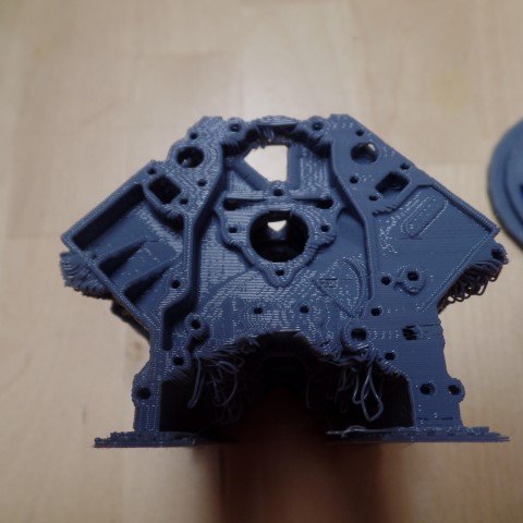

The engine block I printed on fast, .2mm layers, 60C bed and 205C nozzle. It’s ok but the drooping is bad. I printed this before the glass clamps so I thought the clamps would be ok.

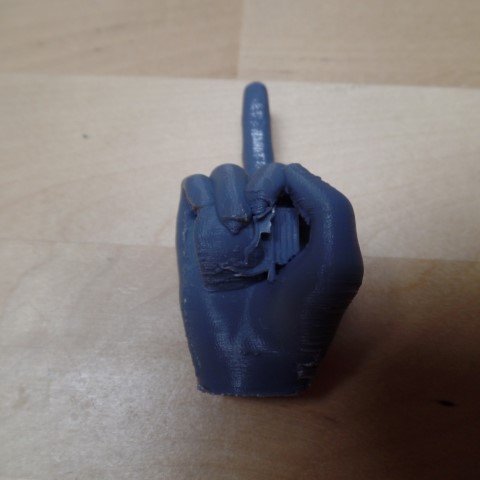

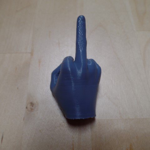

The FU hand pics show the better quality of a smaller layer level, better temp control, and supports.
The main questions I have now that I learned a bit about temps feeds and supports is
1: Why would the finger have such a different texture than the bottom? (granted, this was before I put the duct on the fan)
2: What could I change to make the clamps without adding supports? Or is that not possible since it is a 90 degree overhang.
3: What do you use to get the supports off? Some snap off, but the ones inside the palm of the hand look like a problem. I do have a few dremel tools and various bits but when I tried some they grab and dig in.

Bed at 60 for PLA, 65 for PETg, 100 for ABS. The fiver texture (if PLA) is simple because the plastic was not cooled and solidified yet before the next layer was printed; cause things to move and printing like this; hence the need for the cooling fan. This is especial true as you transition into a smaller printed area because the entire layer completes faster and moves to the next layer because there is less to print.
No cooling on ABS.
Support material removal: Hand tools like pliers, picks, small hand drill bits for pockets. Also set Simplify3d to print supports every two layers so they are weaker and easier to brake out. Change the pattern every couple layers also so they don’t fall over on really high support prints (45,45,45,-45,-45,-45)

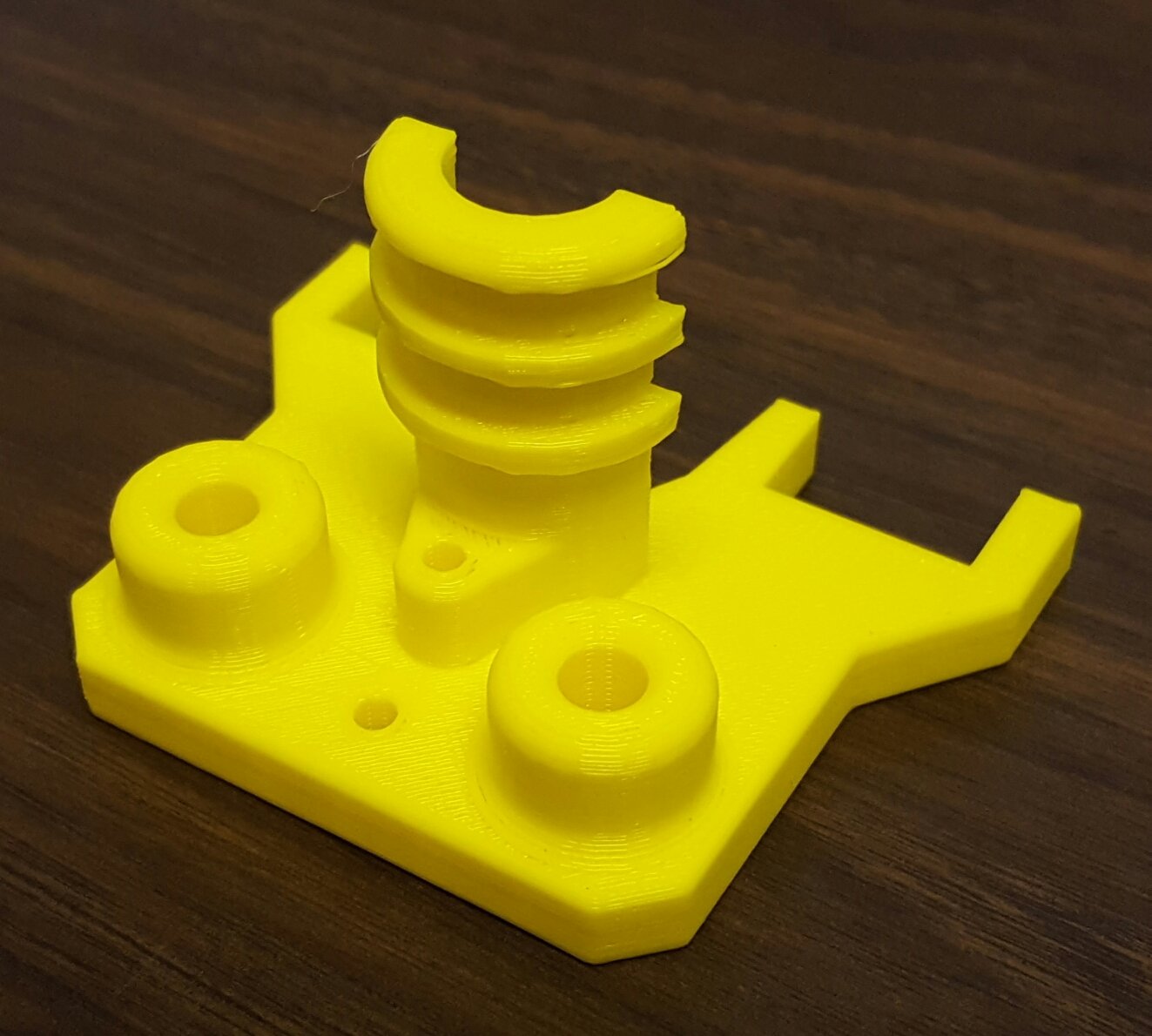

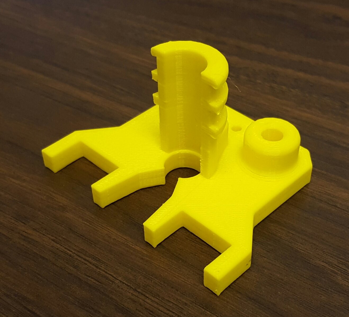

Would not have believed it if I had not printed it myself, but here’s the strain relief part printed from the file shared by dmyers7.
What I mean is this was only my 3rd print and first real part from the machine. The first two were the little calibration cube…
I Purchased and installed the Simplify3D program late last night and after a few minutes looking things over I decided what the heck lets try one in the PLA filament that is loaded already.
I wish I had recorded a video. I watched till about 30% then headed to bed. Later I was up and saw it had finished, taking about 1:20 or so I don’t remember exactly. I peeled it up and started removing the supports structure. I couldn’t stop and put it down. My wife saw it this morning before I was up. Even she was impressed!
I almost aborted the print about 20% into it realizing I had not added in any supports. I did have supports turned on so that’s what saved my a$$ on this one I think. While it was printing I went back to the pc and started playing with the manual supports. Ok this is awesome and I see how it works now. I’m somewhat familiar with MasterCAM CNC and Cut2D along with many other programs over the years.
It takes a lot to impress me most days and I’m a stickler for quality in general. I almost printed a “copy” just because it is so cool and came out so well but the old man had to get back in bed for another hour or two and get through the Friday.
Nice model dmyers7 and thanks for sharing! I did join the thingiverse but not really all familiar with the proper process for credits etc. I was in a hurry to get to it. I’ll jump back in with comments once I get the piece installed.
