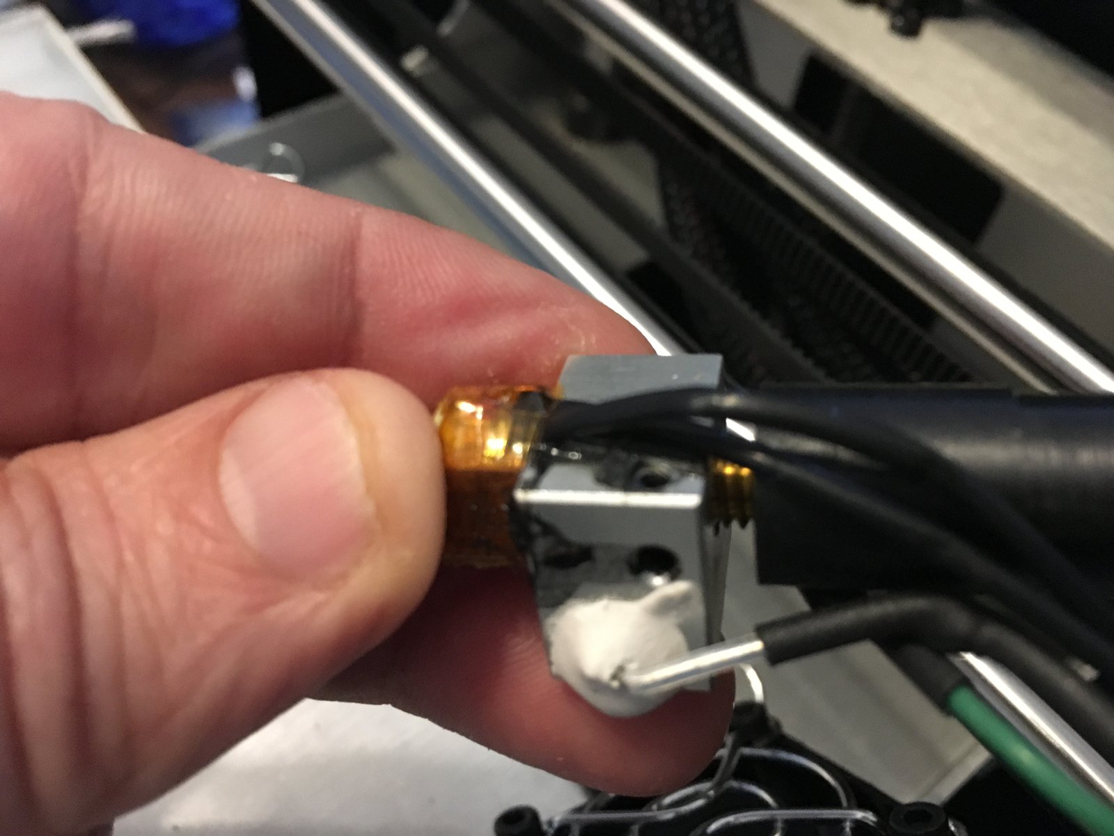

After some more disassembly, I think I have a better idea whats going on. I had to remove some insulating tube that was shrink wrapped around the head. I don’t know what material it was, but even the maintenance videos on the Solidoodle site don’t show the tape on the print head, so I’m assuming it isn’t needed.
So it seems like the nozzle is not seated well against the threaded tube. I believe the plastic is leaking up the threads and out these holes on the heater block. (see attachment) The nozzle seems tight against the heater block, so the easiest exit is these holes. I don’t know what they are for, but if it wasn’t here, the leak would be where the threaded tube enters the heating block. I’m thinking now, I need to remove the nozzle, and put it back on tighter, possibly with some Teflon tap, Then use some Kapton tape to re-attach the sensor.
I might be able to loosen up everything and tighten it all up without removing the sensor, but that seems risky.
It’s too bad that both of my extruders are having the same problem. It might be a production issue.
Those holes are for the temp sensor right?!
no, the sensor is taped to the side of the nozzle.
I’m surprised that they sell the barrel and nozzle. It kind of implies that it’s OK to do my own repair work on this. So looking at this picture tells me there is no heat break. What did you mean by a cooling issue? Can this be fixed by changing printer settings?
I see that but someone drilled holes in the heater block for a sensor. If plastics is coming from those holes this hot end block is ruined.
It came that way, new from the factory. Like I said, if the plastic is leaking up the threads, this is just the first place it can escape. If the holes were not there, it would leak out the top where the barrel enters the heater block. I may be wrong, but the real problem is the plastic is leaking up the threads, which indicates that the barrel is not seated well in the nozzle.

After watching the guys videos I see the brass tube through his “holes” and hes TApIng the sensor. Is that the official solidoodle design? If you ask me, I say stop taping everything and do it right.
Do you think this will seat the nozzle against the barrel better? I don.t see any leaking between the nozzle and the heater block, so I am assuming that they are already as tight to each other as they can be.

Maybe the barrels bevel isn’t meeting with the nozzle’s bevel?

That’s what I’m thinking. The reason I posted the video, is that is hows how to break it down and build it back up. Maybe some Teflon tape on the threads would help as well. If I break this down further so I can re-seat the nozzle against the bevel, I think I will need to get some Kapton tape to re-attach the sensor.
