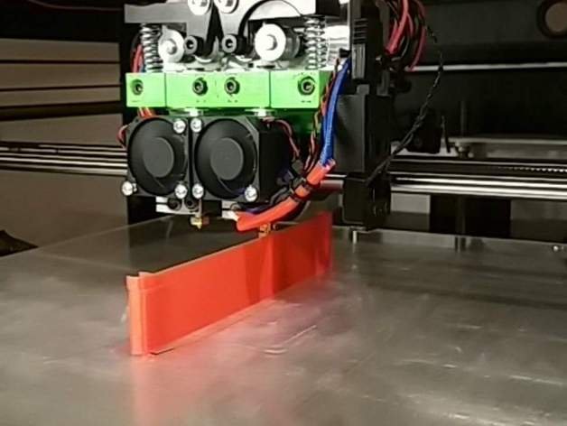

I have decided to upgrade my hot ends with E3D V6. I will be using this mount
