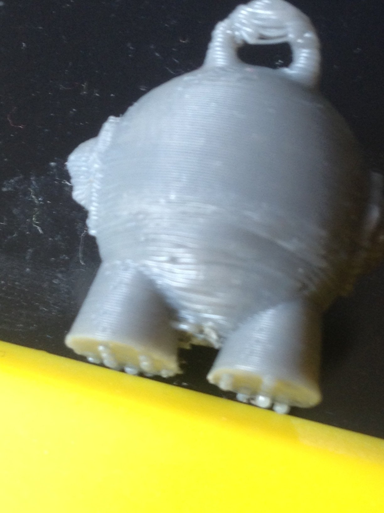

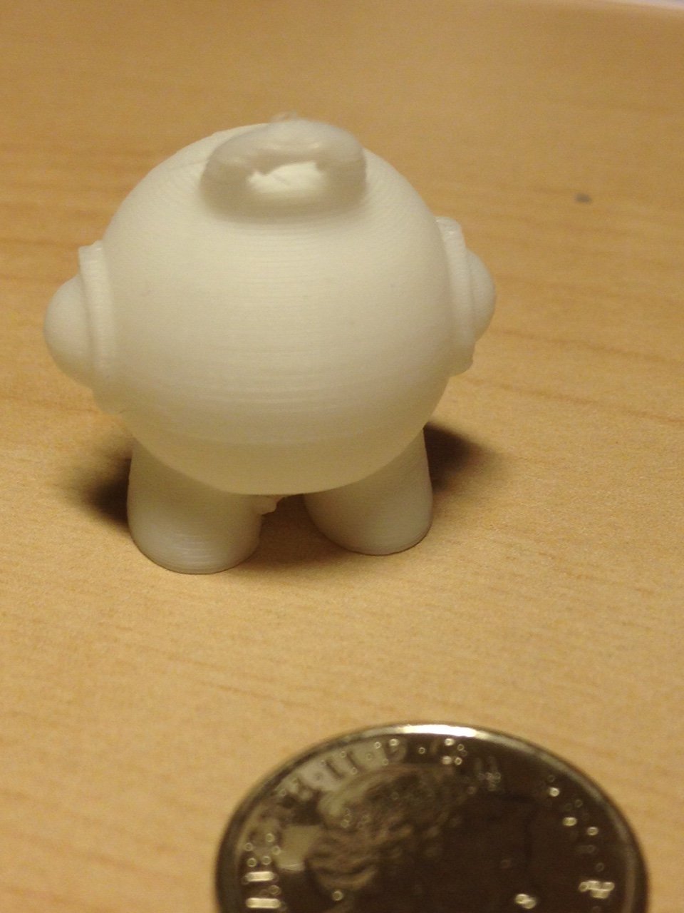

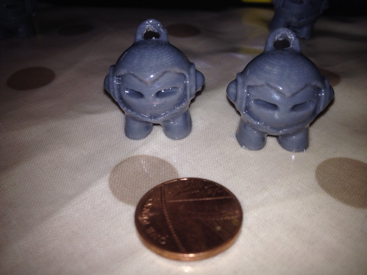

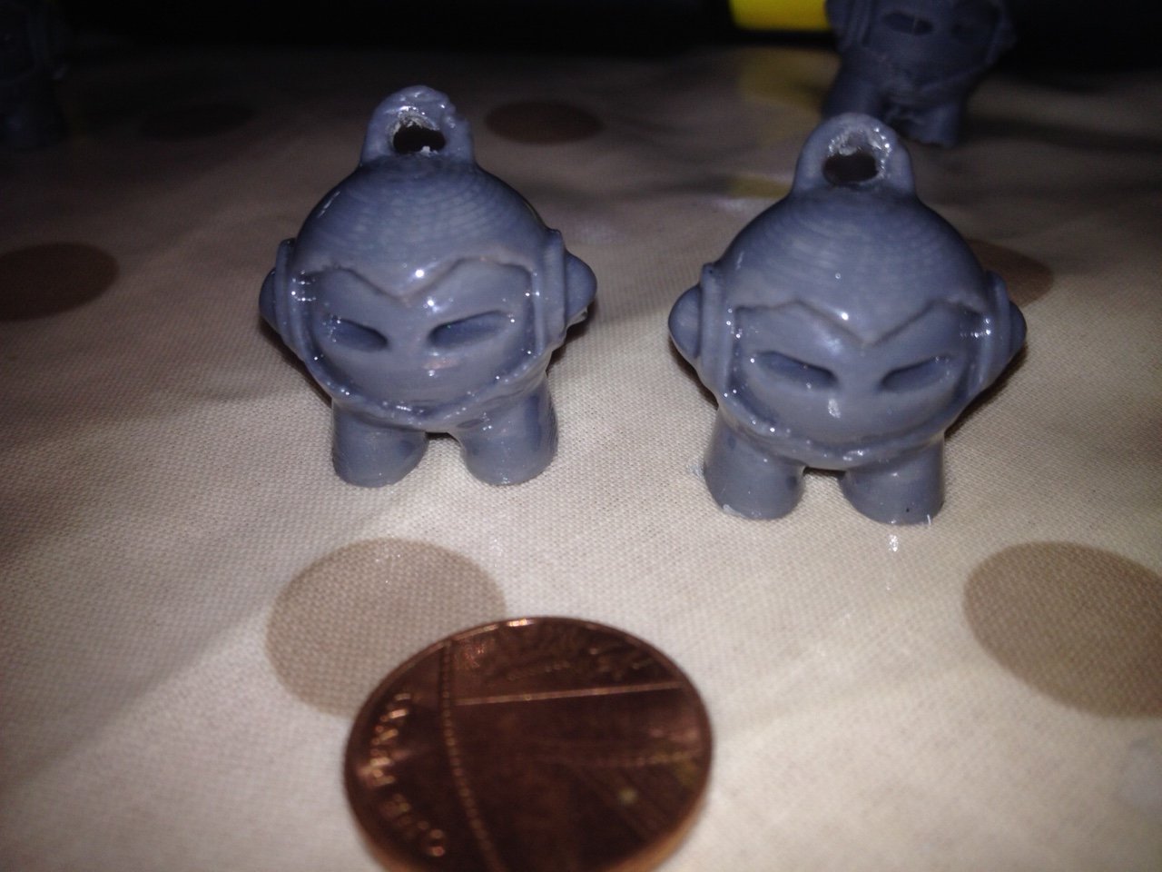

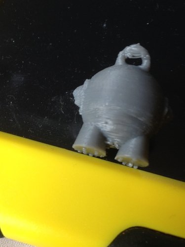

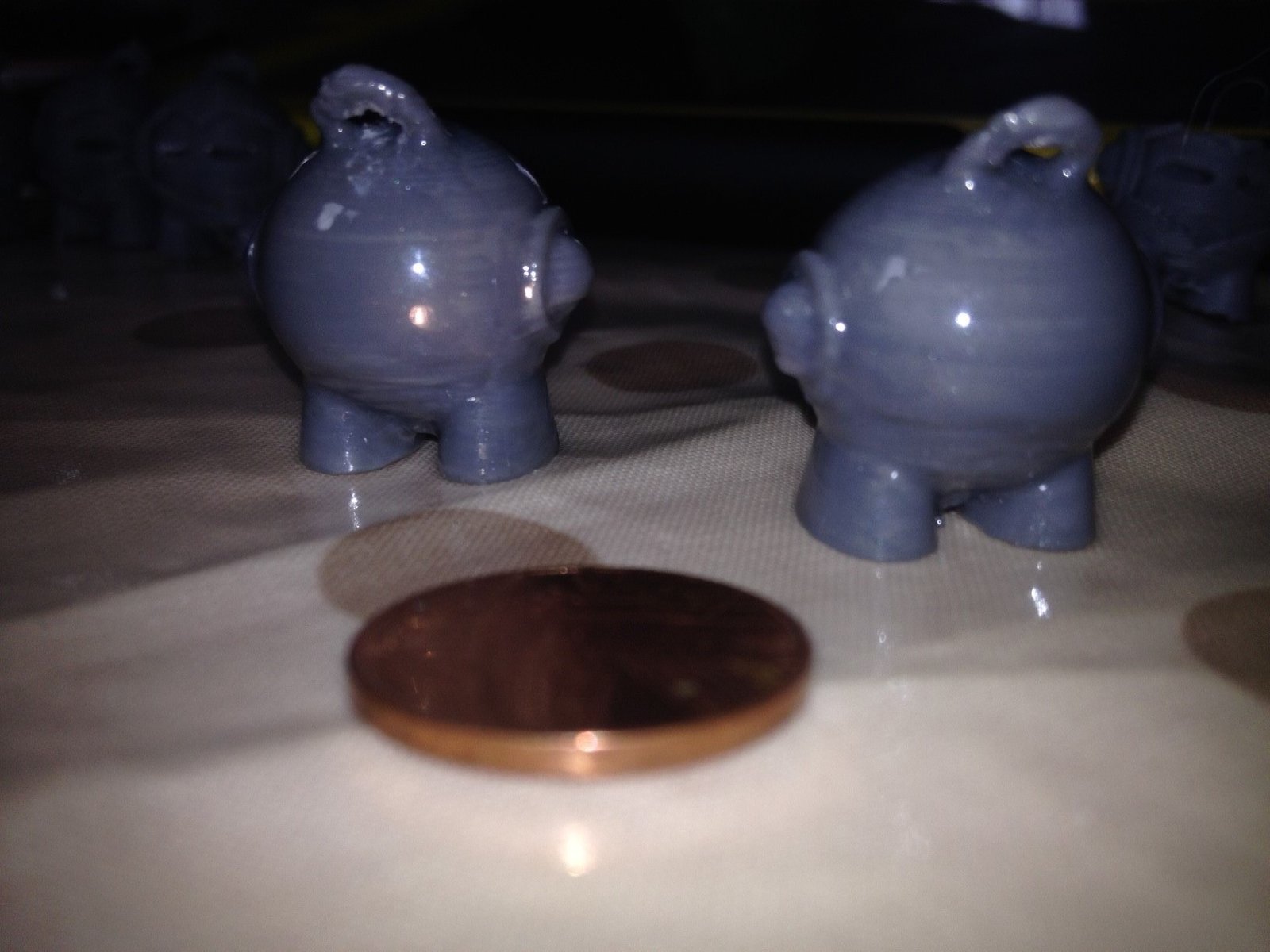

A bit like myself marvins abs and rear are not very toned when I try and print him, the upper half is all fine though, the legs are fine, I wondered if it might be a support issue, has anyone come across this before please. I’m also trying to print him in different areas of the plate to see if its a heat near the bottom thing, its ABS and on an up mini, any help appreciated. Thanks
up mini settings 0.2mm layers minimum fill and no support, cant configure many settings on the up mini. I did try treating them to an acetone vapour session to see if it made it look better, what do you think ?

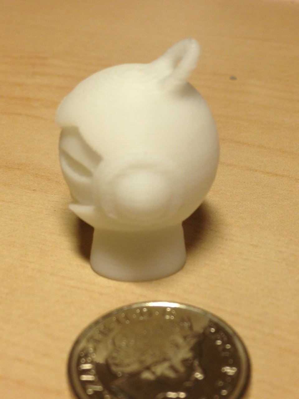

What kind of filament brand do you use? I did a few Marvin with white ABS from UP! Premium filament and it worked well (see picture on my hub page). I read a few times that other filament brands can be difficult to print on the UP Mini due to high printing temperature for UP! Premium filament. And the parameters setup on the UP Mini are fixed!

I was seeing this very thing on my FFCP and played around with many different settings. The problem I noticed was warping. The previous layer warped up and interfered with the current layer and marvin’s butt just looked flat. I also noticed the same problem under the ears and, to some extent, in the eyes as well.
The changes I made that helped the most are as follows (listed from least improvement to greatest):
1. Slowed down the print speed.
2. decreased the print temp as much as possible.
3. installed an active cooling fan (I am not sure if this is an option on your machine).

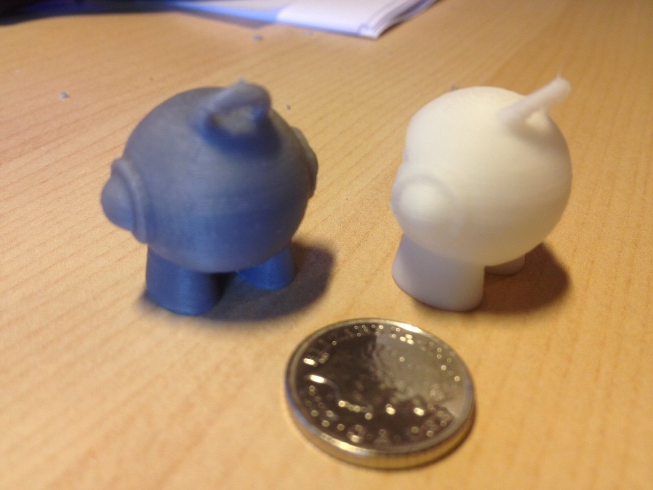

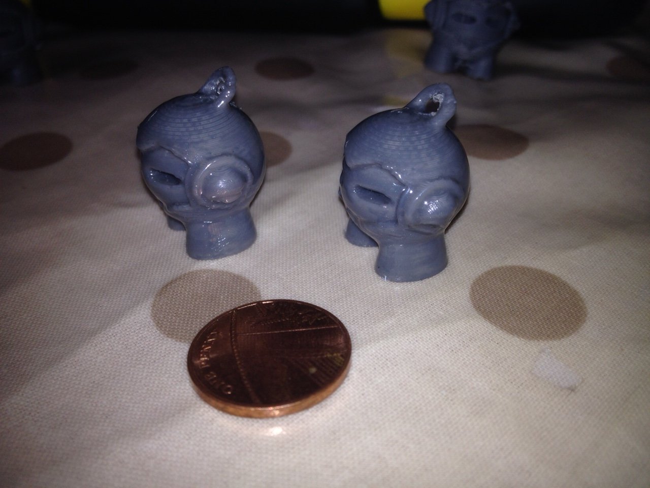

I do have the temp software mod and lowered the temperatures a bit and they seemed to print a bit better on the backside, see images on my hub page. I also tried one in each corner of the plate/mesh all at the same time on fine sped setting to see if it was a warping thing (heating element is on centre of plate, I have modded that from 50c to 90c for larger prints).

The problem with the Up is the software was designed to work with support so it does a poor job with bridging because it doesn’t know to print a little faster/cooler when bridging. Your biggest issue here is being too hot for your filament. If you search the Up forums there is a software hack to allow you to lower the printing temp. Alternately, if you prefer a hardware solution you can build my hardware mod for under $10 http://www.thingiverse.com/thing:528396
Once you have a temp mod you can print with or without support just like it is Up genuine filament.
While you don’t have a temp mod having the fan door open (handle in the up position) will also help but usually I don’t like to print that way for ABS as it will make bigger things than Marvin warp. Also printing on Fast will help that bridging but you will need to the fan open because those layers may not cool fast enough otherwise.

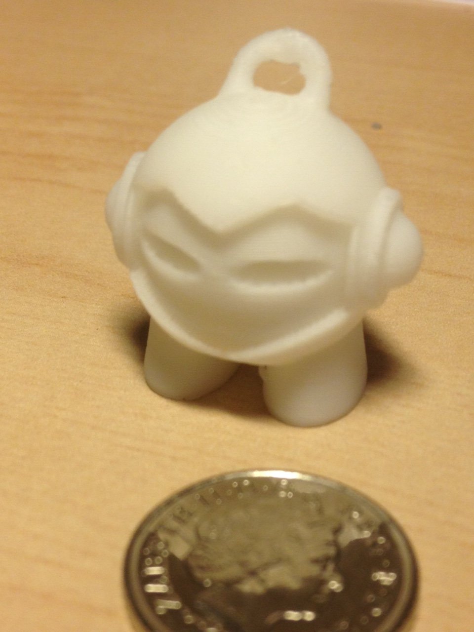

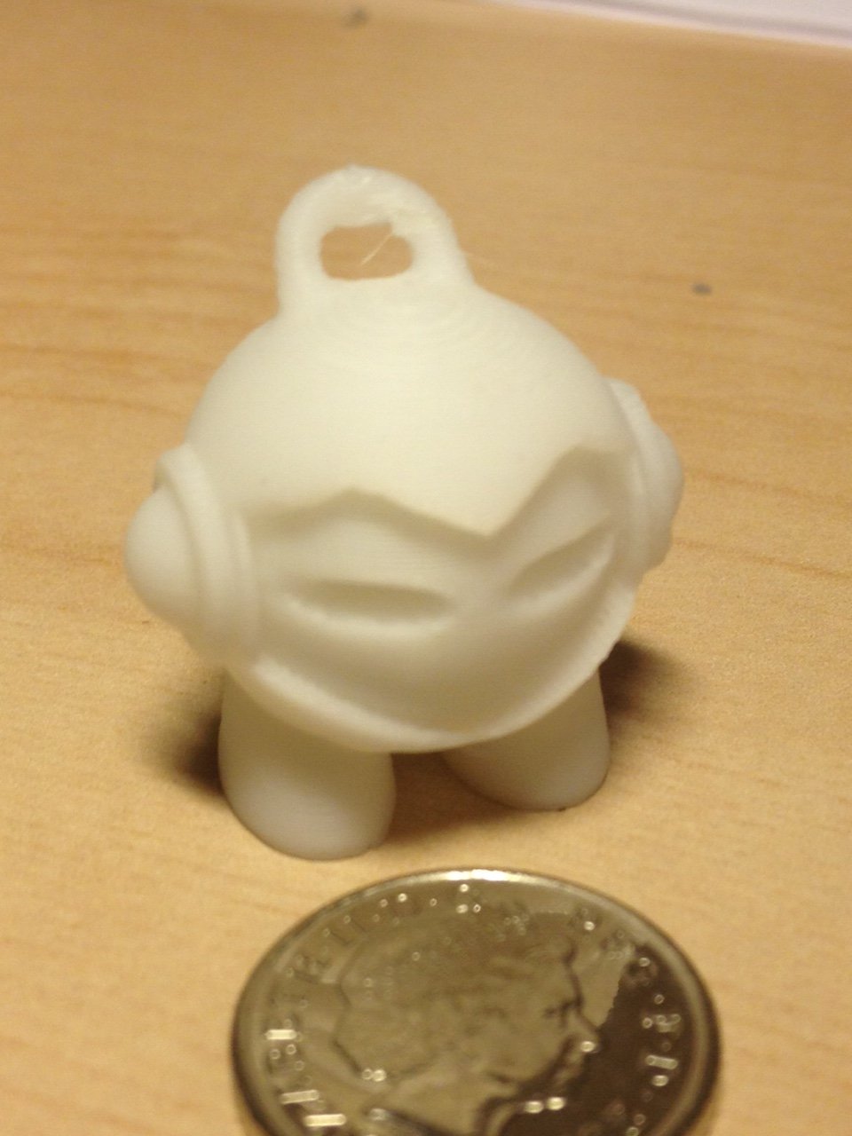

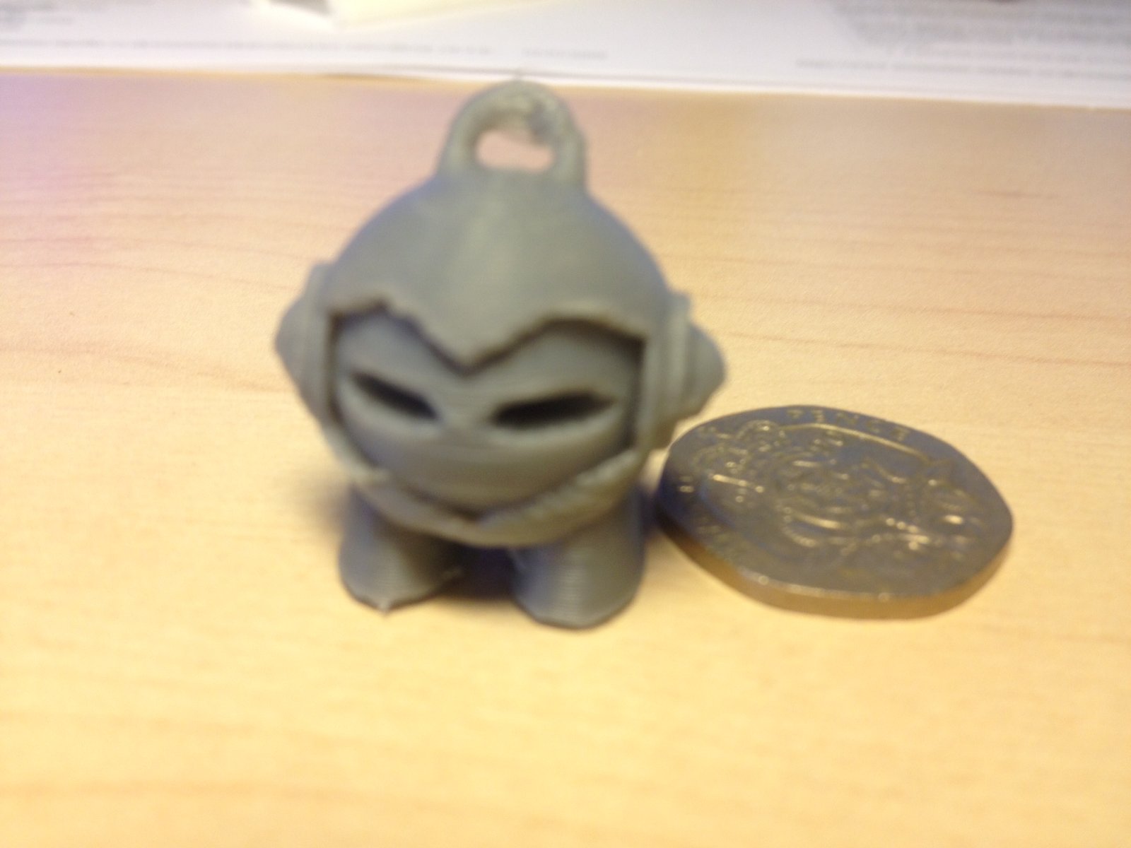

So printed with the OEM white, door open, lid open and fan switch on and a USB fan blasting in (same as I do PLA) results phenomenal…well at least I think so :slight_smile: I will now try the same with the non OEM silver and temp mod down to 230c and see if the outcome is as good
Your Marvin looks amazing! What fill setup, layer thickness and printing speed have you used?

It was the UP abs filament, 0.2, standard temp settings, minimum fill, support base only, with raft add support for 10 degrees or more 3 surface layers.

I think your black marv looks spot on !
I have now run the OEM white Marv as uploaded lastnight and today the silver Marv with extra cooling and tweaking temperatures a bit, I’m really happy with them. I am as we speak printing off an orange PLA version again temperatures tweaked through the s/w mod and a bit of rapeseed oil with the filament load(I have read it keeps PLA sweet in the Up! box, I did have an initial bit of clunking when it started but not since on the 20min print in fine mode all fans)
