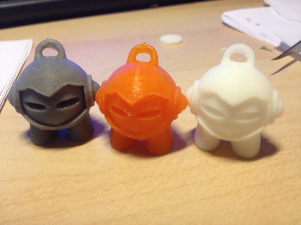

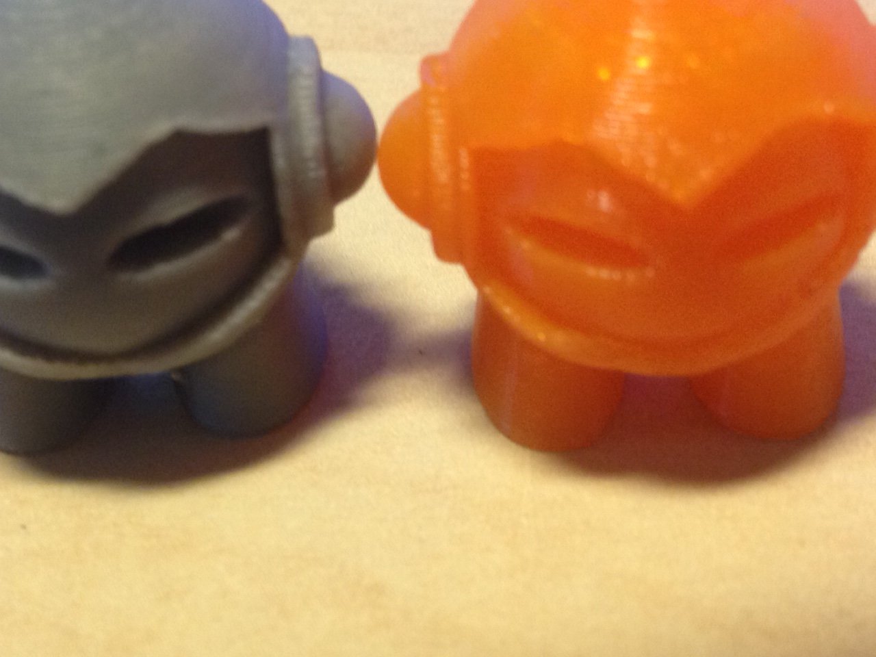

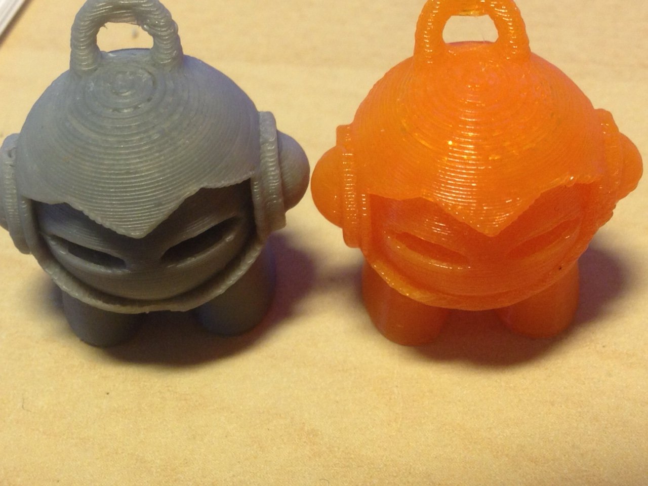

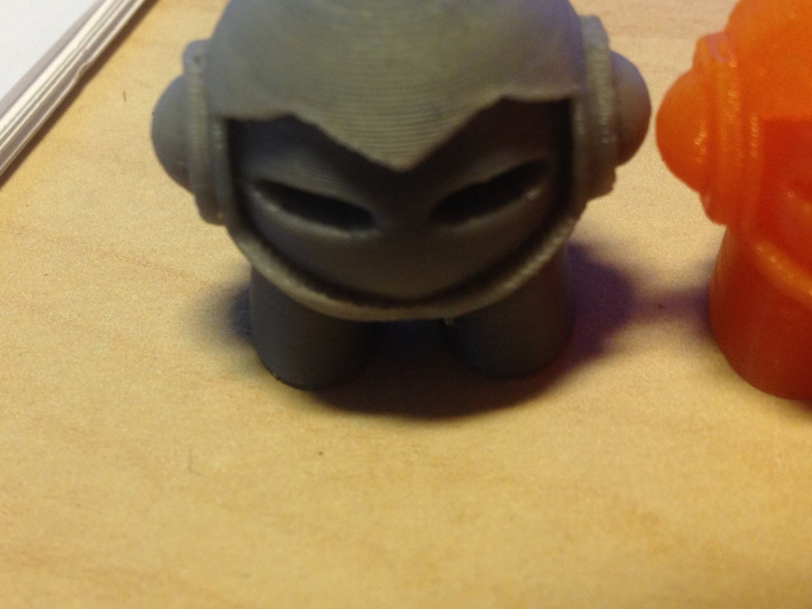

well here is the orange PLA (faberdashery) the first one didn’t print too well using standard UP temperatures, I changed the print temp to 230, the under extruding problem seems to have gone now but its just not quite as sharp on the bottom of Marvs helpmeet, its the only place I notice it really, grey and white are ABS ,PLA orange in the middle, welcome any thoughts on sharpening up the edge of the helmet in the PLA
You should eb able to go lower on that temp - 230C is more an ABS temp. Faberdashery stuff is usually a better grade of PLA so it would be on the higher end, like 210C. Just listen for a jam towards the first few minutes so you can catch it early if it’s too low and save yourself having to clean out PLA dust form the jam.
Other than that, front and top open of course and a fan direct on the print (wind barrier fan is not enough). If you can’t direct it well on to the print insulate/screen your hotend and nozzle as best you can. Forcing the hotend to work harder can result in more heat working up in to the top of the extruder.

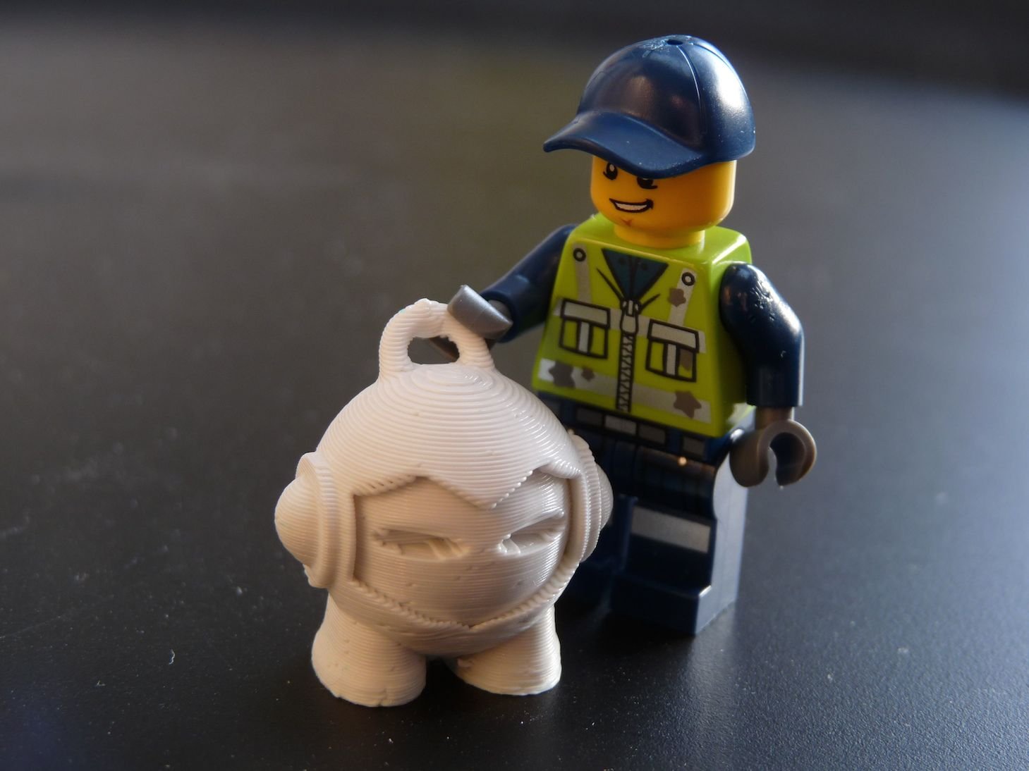

Thanks for the feedback. I watched a few YouTube clips to learn the process. I have never dipped or had any physical contact with the acetone with my ventures. I use an old electric hotplate (camping one) and an old coffee peculator glass pot. I heat the glass pot gently and then add some acetone (not much at all), I only heat it enough to see the vapours running down the outside of the pot (not coming out the top) and then hang the print in there for about 30 seconds and then take out to dry, the finish is as per glossy marv above, I have not seen any loss in detail as yet, though I accept sharp straight edges may become slightly rounded depending on the level of exposure

If the Marvin’s “privates” has still bad printing, it is good to check if it prints the first layer between legs into air. I noticed that Simplify3D does this. So I added a support between his legs.
