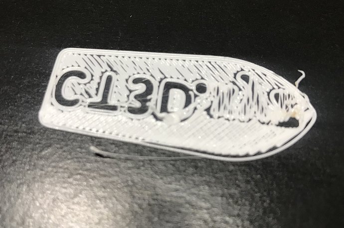

Wirly, The FF finder doesn’t have a heated bed. I had read that it was better to use a raft because of this. I just tested the same print again without a raft and it started doing the same thing again. Luckily I was able to stop the print before it completely clogged the extruder again. I’ve tried attaching a picture of the print without the raft to show what it looks like.
I didn’t realize on the heated bed.
First thing the picture tells me is the gap from bed to nozzle is too much.
You want to see that each extrusion is getting slightly squished to create a more solid layer.

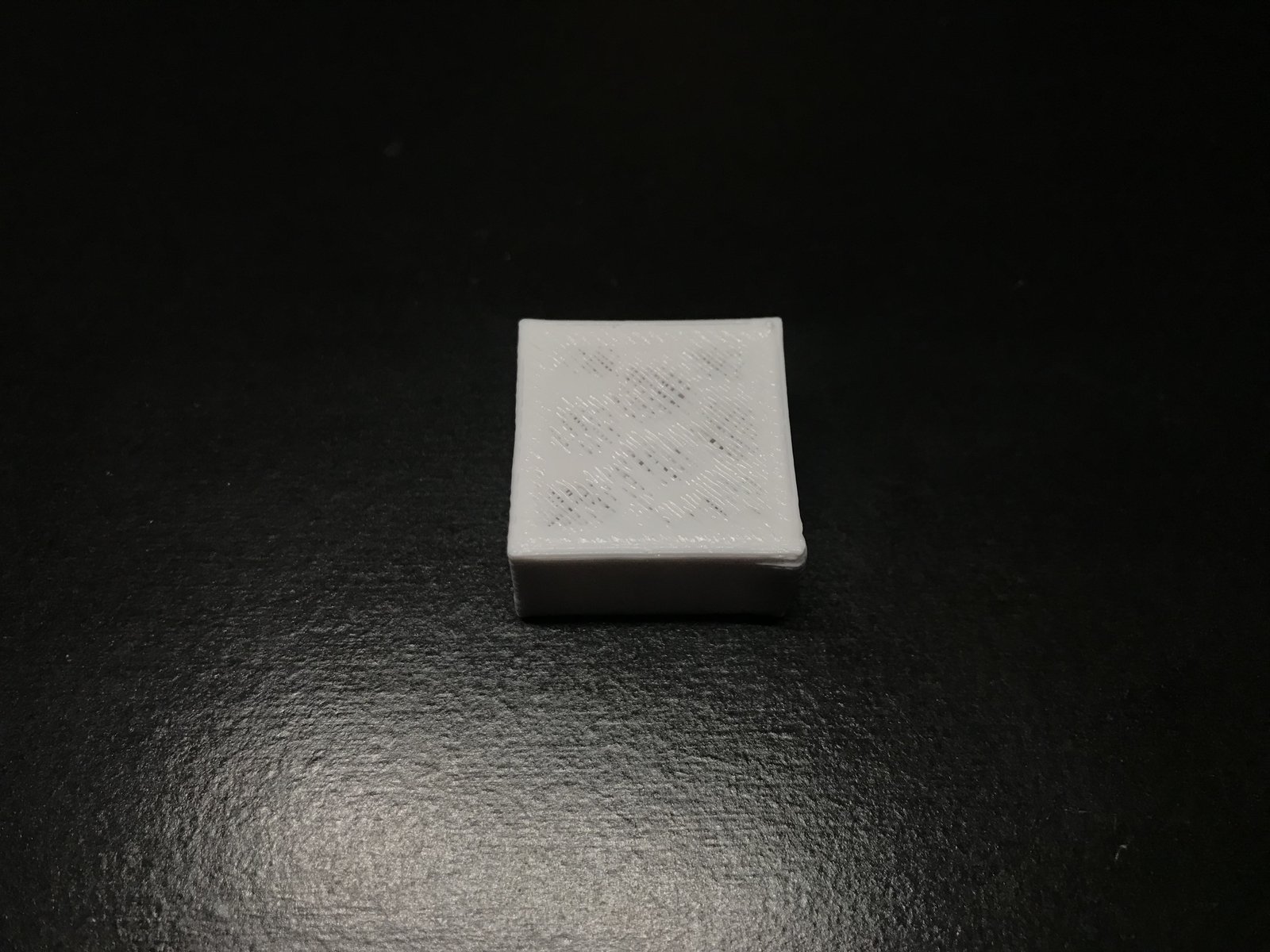

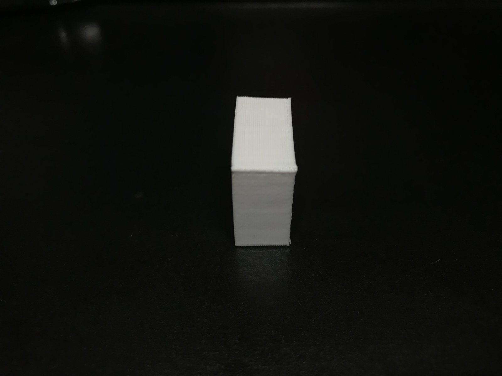

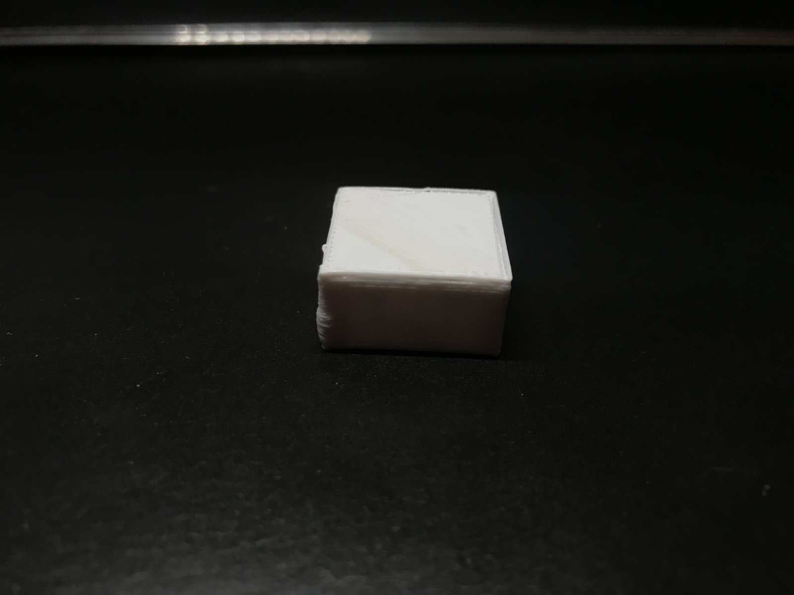

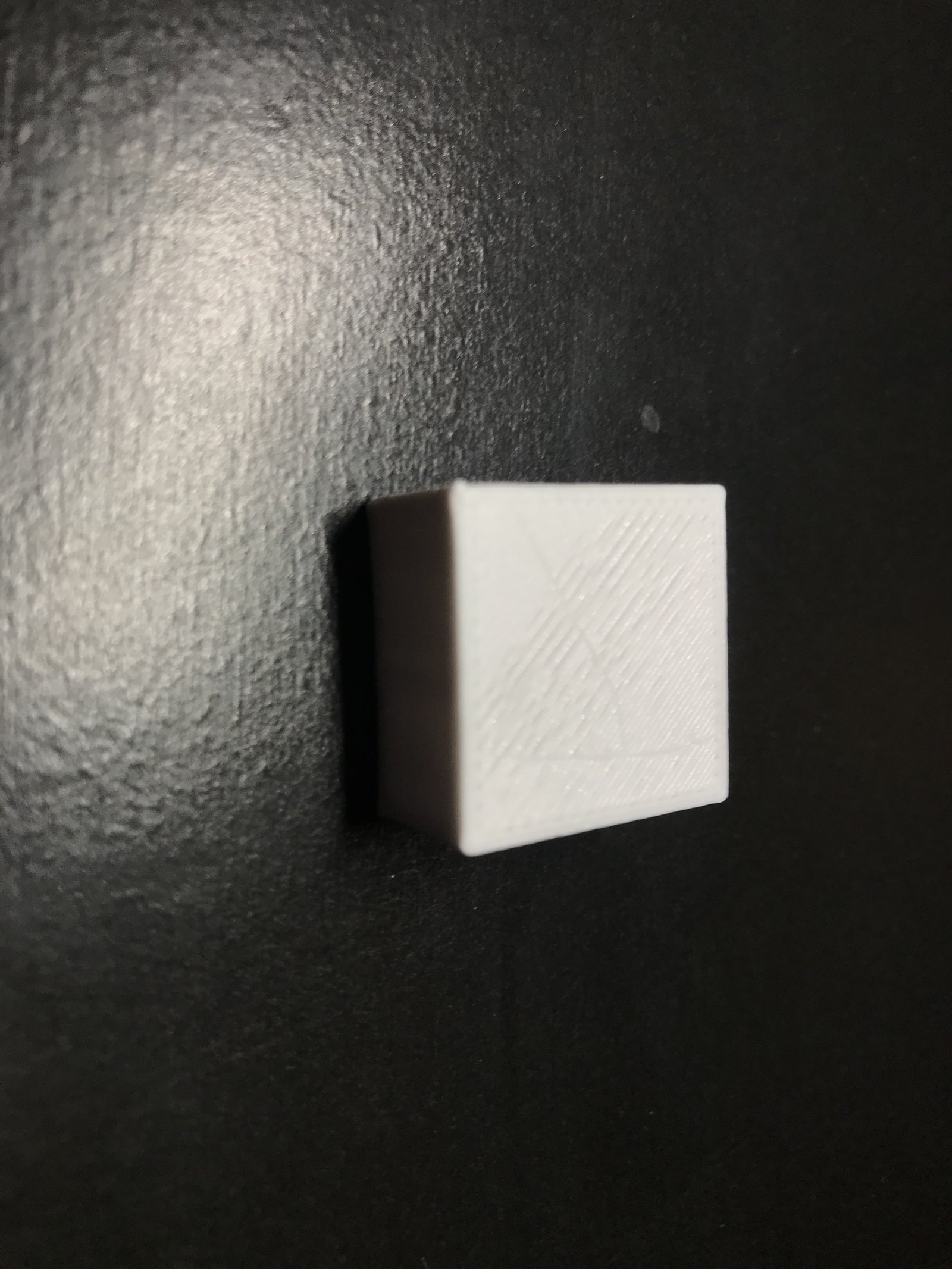

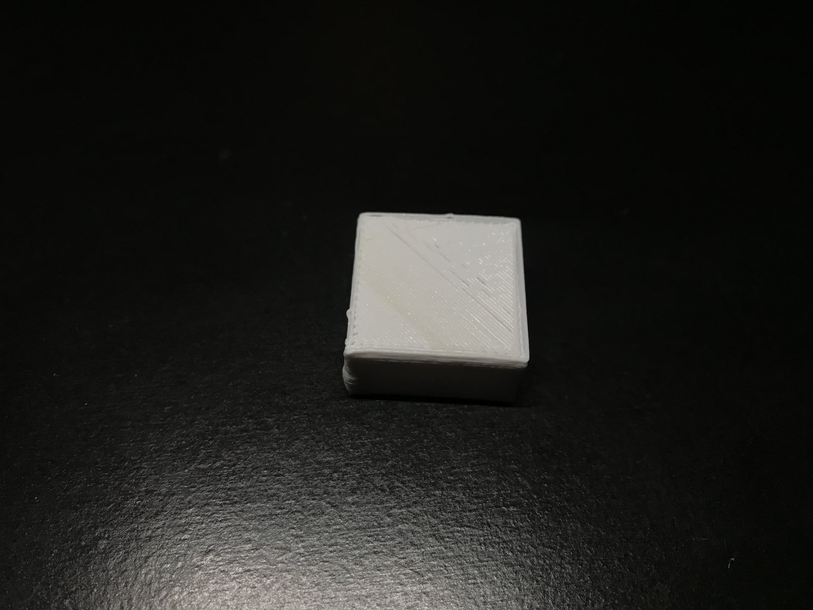

Ok, so I’m making progress. I had emailed Flashforge support a couple of days ago and they were quick to get back with checking the firmware. They did tell me there was an bug in the existing FW that could cause some issues similar to what I was experiencing. Turns out I had the latest FW, so wasn’t anything with that. They emailed back and told me to reset the print settings in Flashprint, level the bed, and print the test cube from Flashprint. I did that and to my surprise, it printed complete in about 9 minutes and NO CLOGS! Wooohooo! Now here is what it looked like. I need to make some adjustments of some sort, just not sure where at exactly. Maybe the bed isn’t exactly level since the corner looks a little deformed. I am guessing the benchy I was trying to print is a corrupt model or something which is why it kept clogging up as it was trying to print.
Temps and speeds?
Looks hot and needs a few other adjustments.
Remember how I said to level. Only over the leveling screws.
On a 20mm cube I’d go with 30-40mm/s.
PLA at 200 max.
infill 20%
3 top and bottom layers.
Extrusion multiplier maybe 95%
The default settings have the temp at 220, extrusion at 109%.

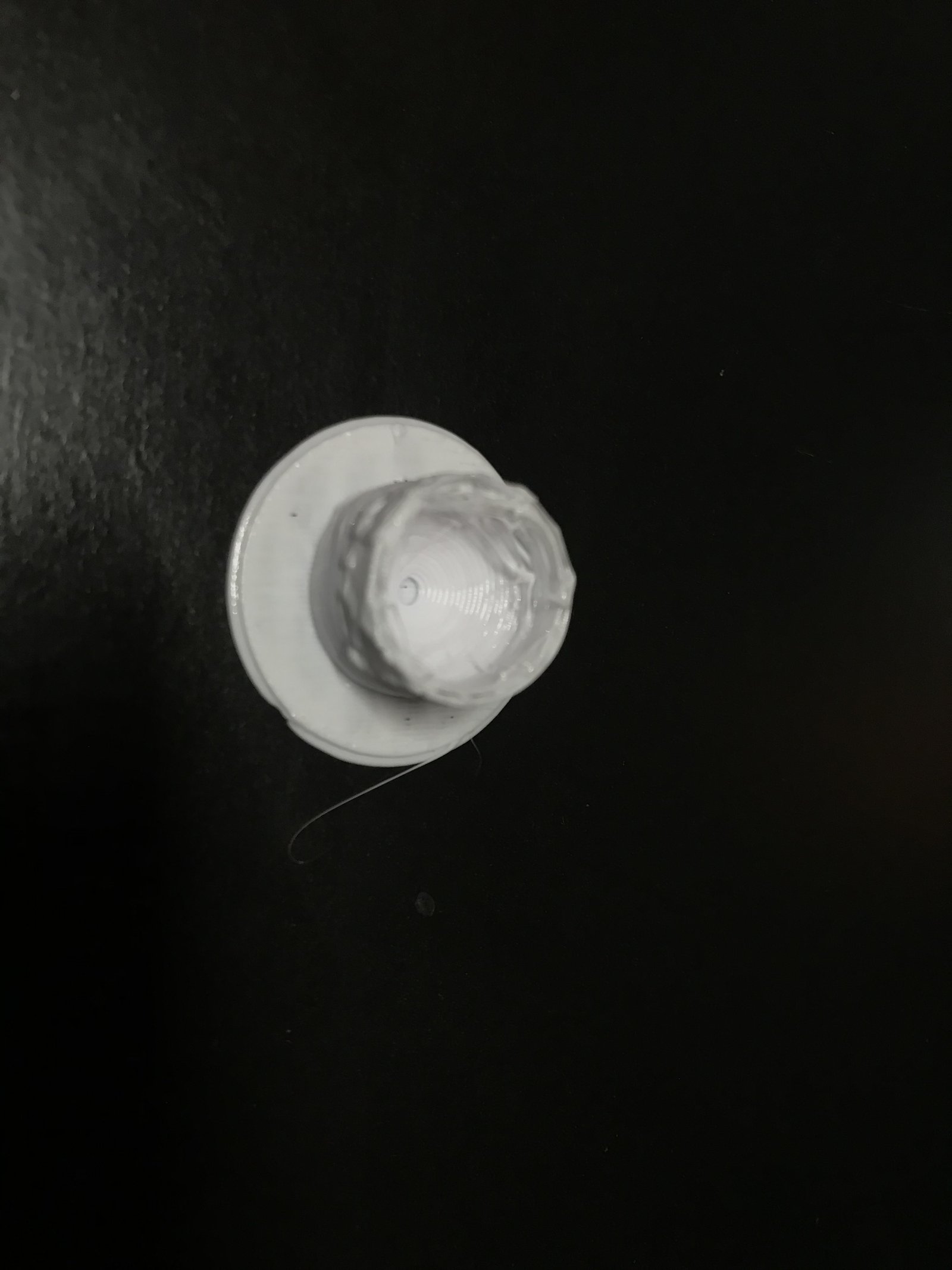

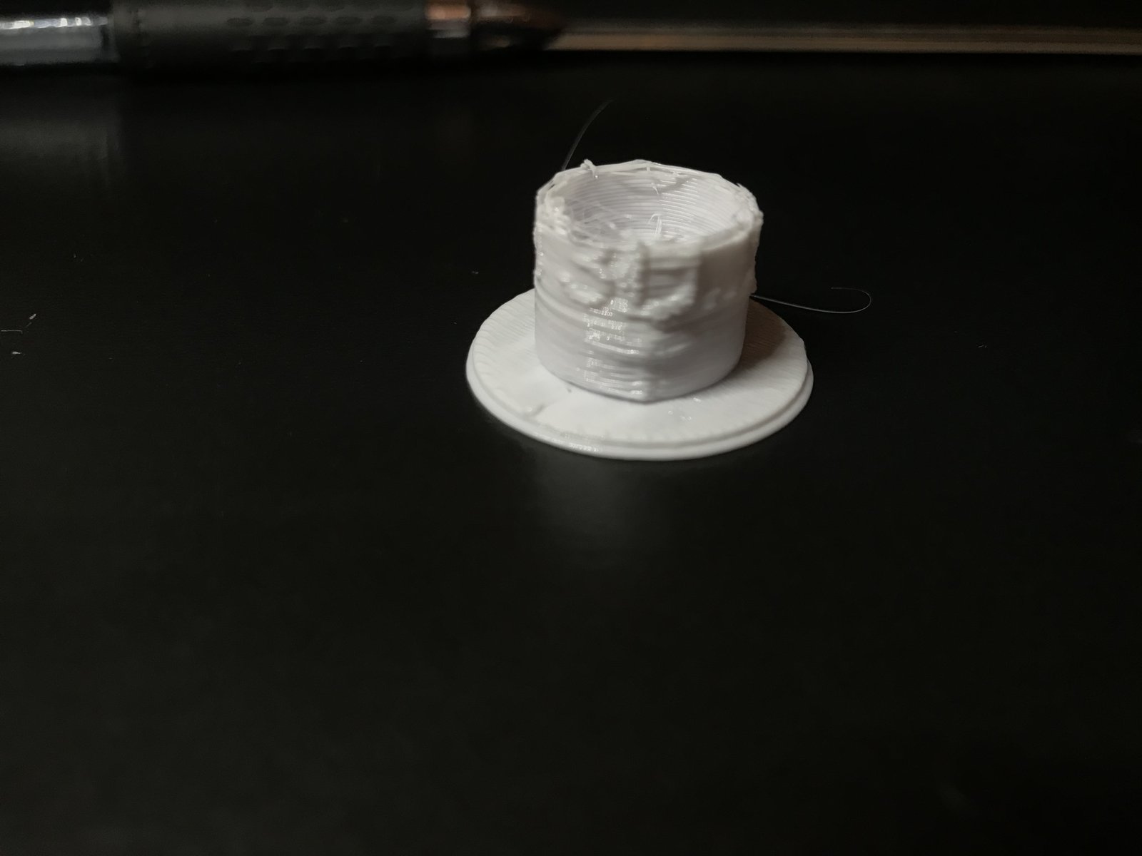

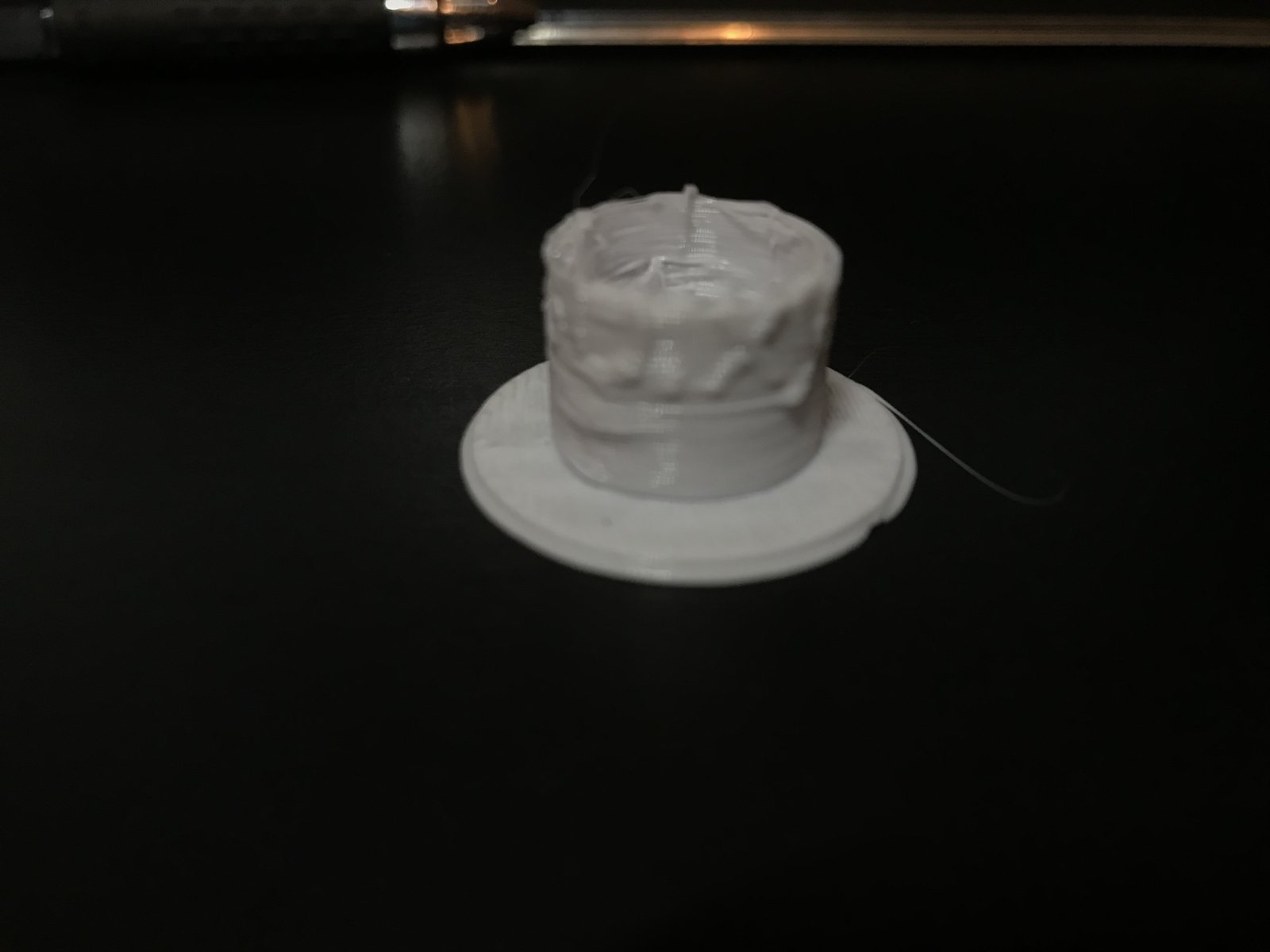

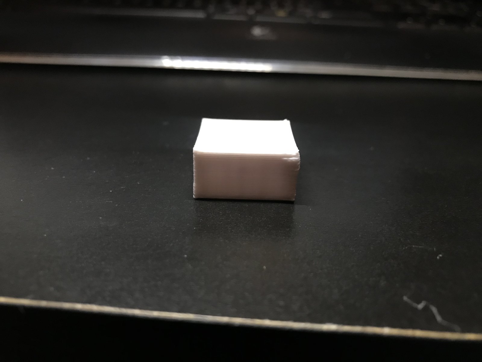

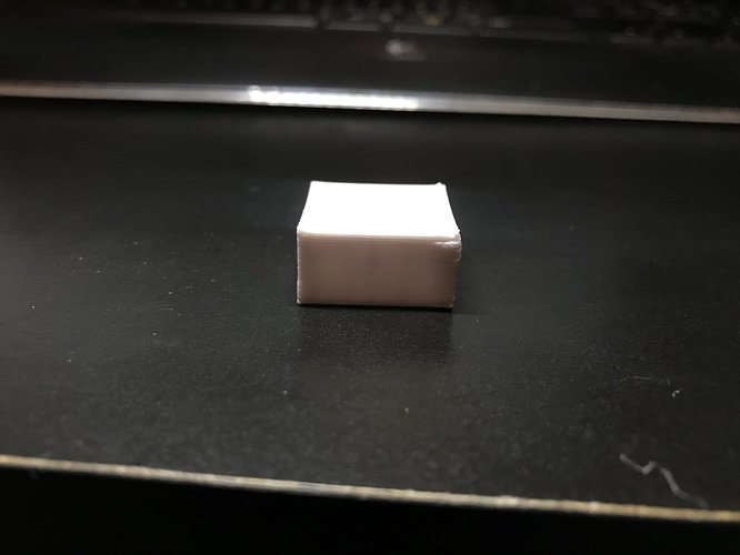

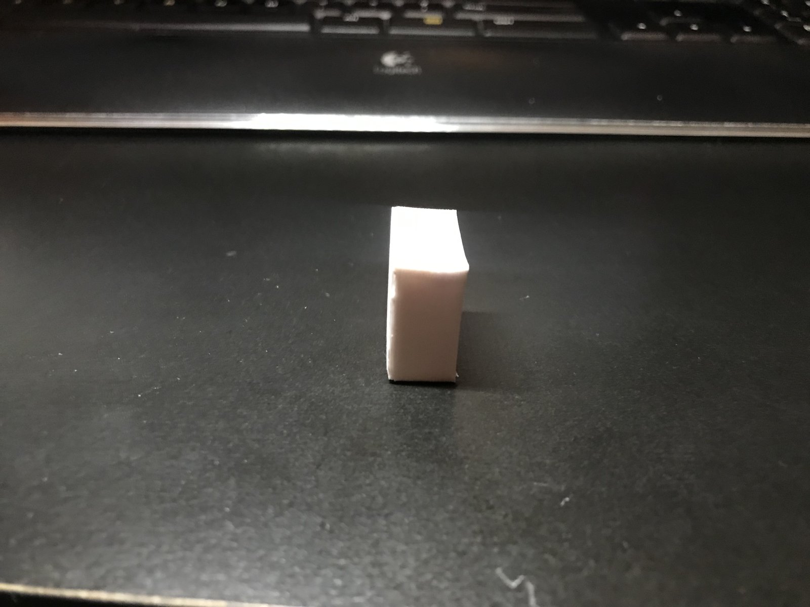

I did relevel the bed again only at the 3 points where adjustments can be made. I also lowered the temp to 200 and extrusion to 95% and printed another test. It looks a little better than the first. I then decided to try to print one of the pieces needed for a spool holder to clip on the FF finder to use the 1kg spools. I printed at same settings (200C 95% extrusion). It didn’t look the best starting off and then it started slowing down coming out of the extruder and ended up clogging the extruder up. The pictures show the piece. It is supposed to have some raised lettering around the sides. The file I downloaded already had a raft, so I left it as-is.
As I was heating the extruder up to 220 to melt some of the clogged filament out, I heard the printer fan get louder and then I realized the extruder fan just started working and that fan noise added to the case fan noise I’m used to hearing. It hasn’t worked the entire time I’ve been messing with the printer over the last week (probably about around 16 hours in all) and I never paid any attention to realize it wasn’t working. I messaged FF support and was told the fan should come on at 50C. I’m guessing that issue may be why it was returned possibly. It’s been a rough start, but I’m surely learning more and more each day.
I’m calling it a night, but will be doing more testing tomorrow to play with the settings a little more. I think I’m going to try to increase the temp to 205 or 210 and see how it looks. It appeared the PLA just wasn’t melting fast enough and that’s what started the clog.
