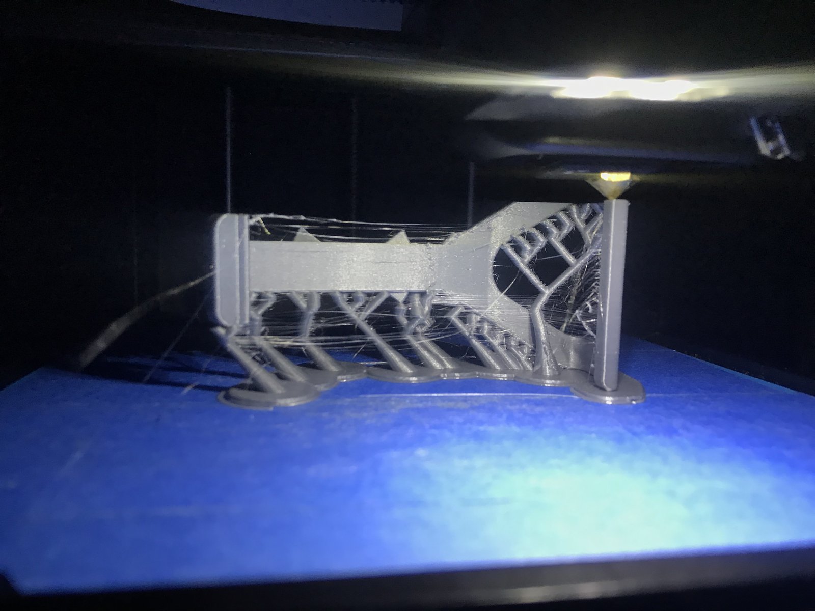

So, on the circular part above there are a few things going.
What do you see? Melted looking so too hot. What to do about it?
Is there a part cooling fan and is it running full? Not the extruder cooling fan.
What is the temp at for the material? Can it go lower?
What is the bed temp (if you had one)?
What is the print speed and is it too fast for the size of the part and material?
A second look also shows it may be over extruding a bit.
Lower the extrusion multiplier a little like from 95% to 93-94%.
Make a change and re-print. Lots of test parts in this game!

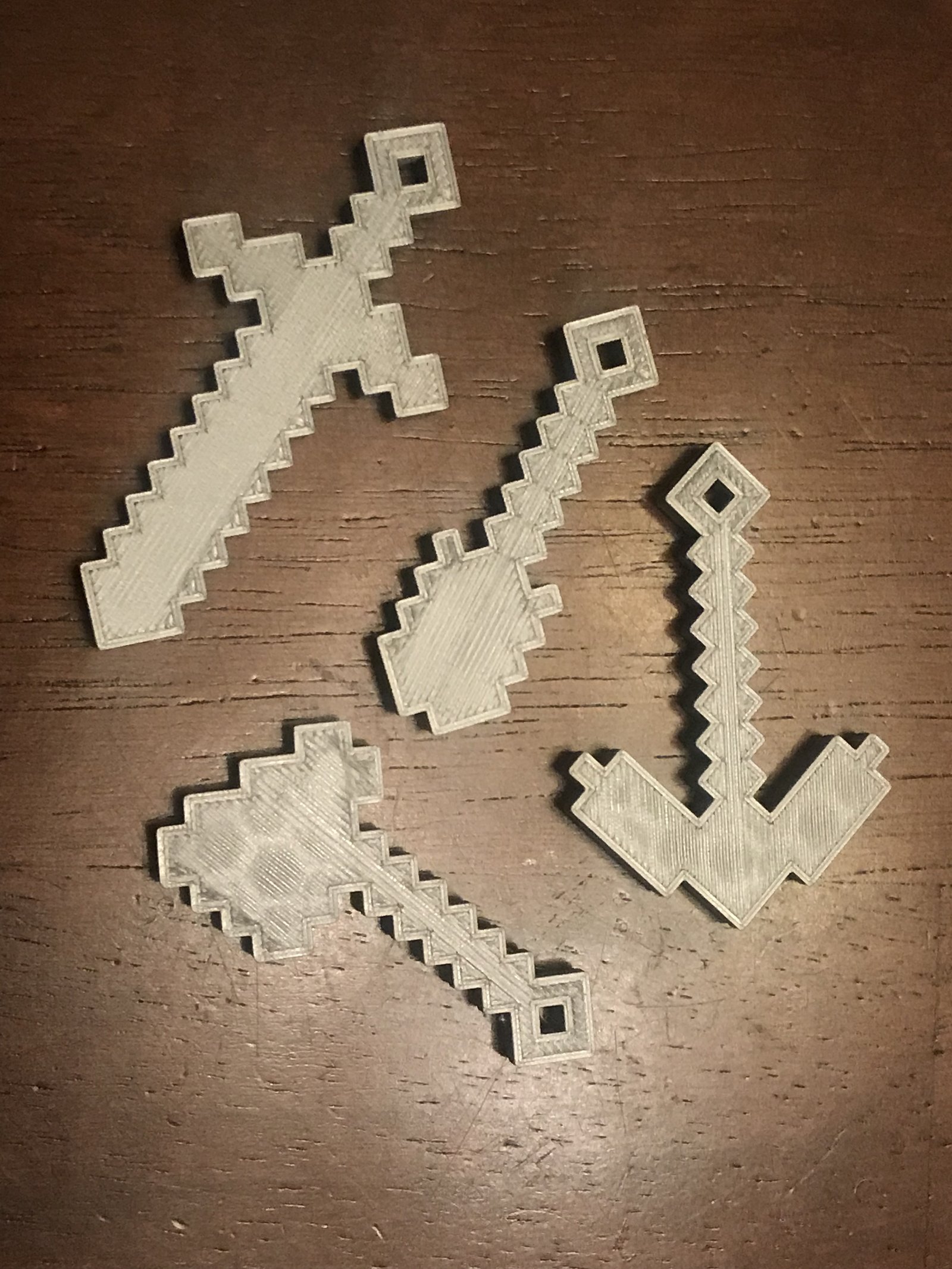

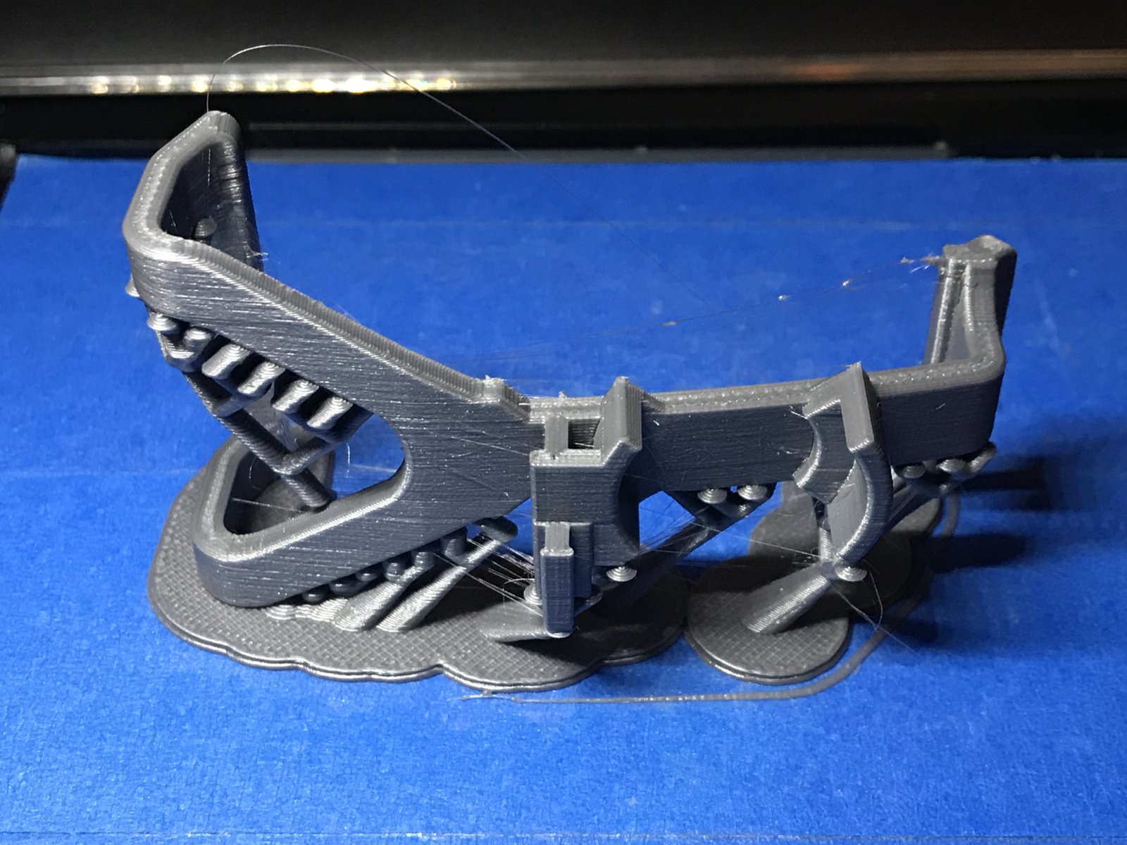

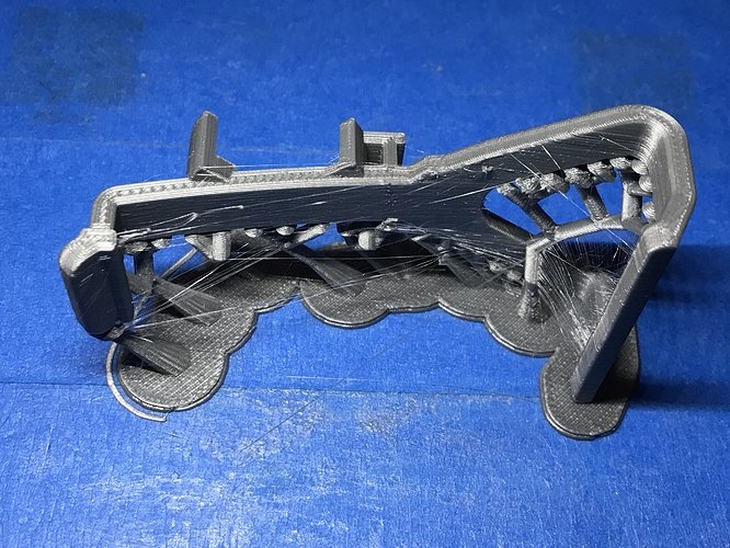

Here are a few prints I made after replacing the fan. The minecraft items turned out pretty well. The other piece had to print with supports and a raft. It’s the main piece for a xbox one thumb racing wheel attachment for my sons xbox one controller (attaches over the exist controller to make a mini steering wheel). There is a bit of stringy-ness to it, which I presume is from the temperature being a little high maybe? I really have to go back through all the settings one at a time and see what I need to adjust. I basically started all over again with my slicer settings after I replaced the fan.
Looks good.

Print temps will affect stringing a lot. Some brands and colors also are just more stringy.
If you are mostly getting the stringing on supports then I don’t worry so much about it.
I would get the slicer back to defaults with the first changes being - speed at 40mm/s or so until you get comfortable with how speeds work in relation to materials and part sizes.
Extrusion multiplier maybe mid 90’s for PLA and 100 for ABS and work from there. I don’t know why they put it so high.
Also you will need to measure the diameter of the filament in a few spots and take the average. On other slicers you can enter this but not on Flashprint.
So if your filament is at 1.68mm then you may need to raise the extrusion multiplier a tad to compensate. It will just take a little time to get the feel for it.
