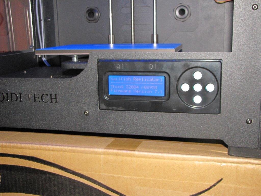

Let me know how you get on with 7.1, and I’ll try and answer any specific questions you have while doing it. After that, we can try and get the higher versions to work. I attached a couple of images showing the firmware version, as well as my custom machine name in the main menu. :slight_smile:

Using Makerbot Desktop, I was able to step through their firmware from 7.2, 7.3, 7.4, 7.5 in order. But I still can’t get it to accept Sailfish 7.5. Are you absolutely sure you have Sailfish 7.5 and not just the Makerbot 7.5? If you go into the version info on your LCD screen, does it say Replicator or Sailfish?
Adam
Ah! I’m sorry, you might be right. It just says firmware 7.5 does not say sailfish
