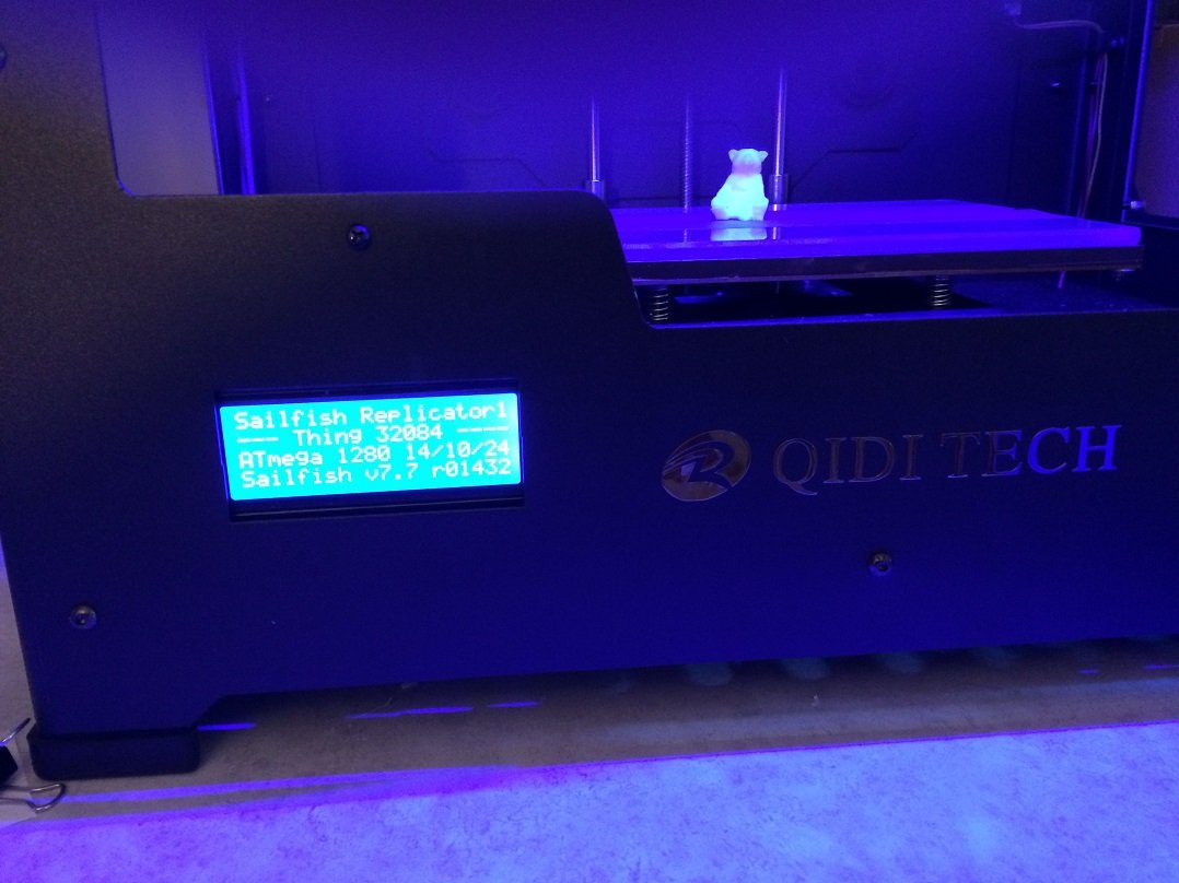

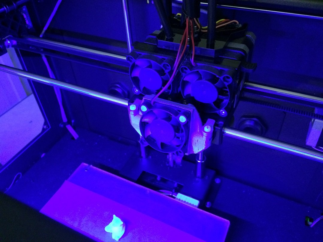

I bumped up to SF 7.7. SF 7.6 was working fine but thought I would test this out next. I was able to get an external PLA cooling fan working OK also (commands M126/M127) with SailFish. (24V/44mm Fan + Thingiverse
Active Cooling Fan Duct v2 for Replicator 1 / Duplicator 4 / FlashForge / CTC by thruit00 - Thingiverse). Just soldered the leads to the “Extra” connector on the controller board. Turns on and off under software control. Have a different fan on the way, blower style, to see if the PLA cooling works out better.
Let me know if anyone else was able to do the SF upgrade with the ISP fuse changes.

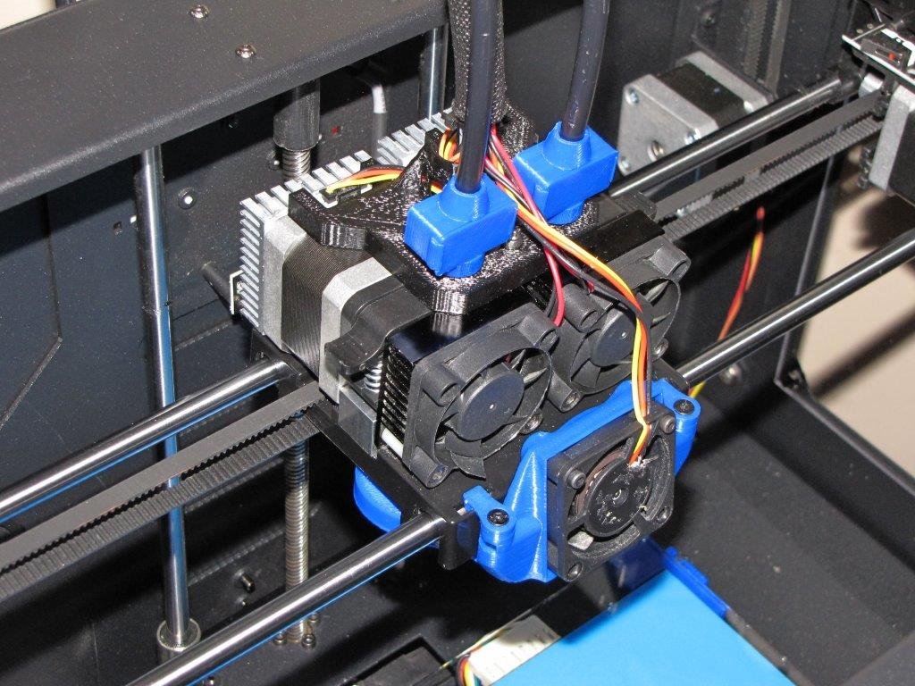

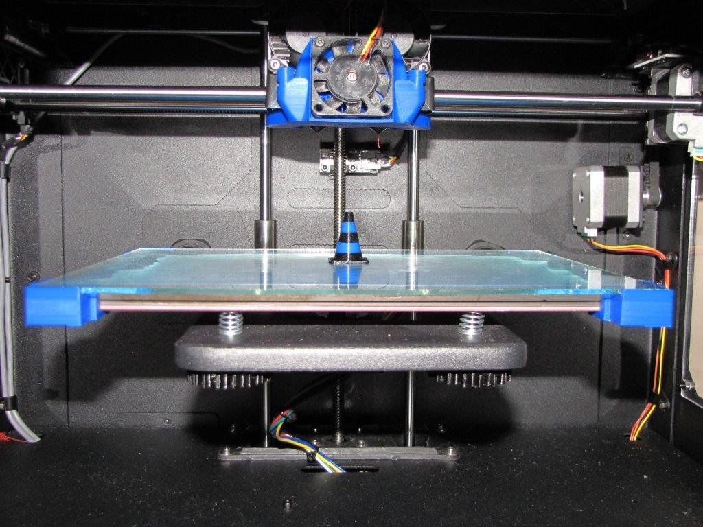

For mods, I also have an active cooling fan (same one as yours), a new filament tube holder above the extruder steppers, dual filament duster/oilers, heatsinks on extruder stepper motors, filament guide on rear of machine, glass bed with corner clips, bed adjustment thumbwheels, rounded bridge top for the upper enclosure, and reversed the power toggle switch (to make it easier to reach from the left side of the printer).

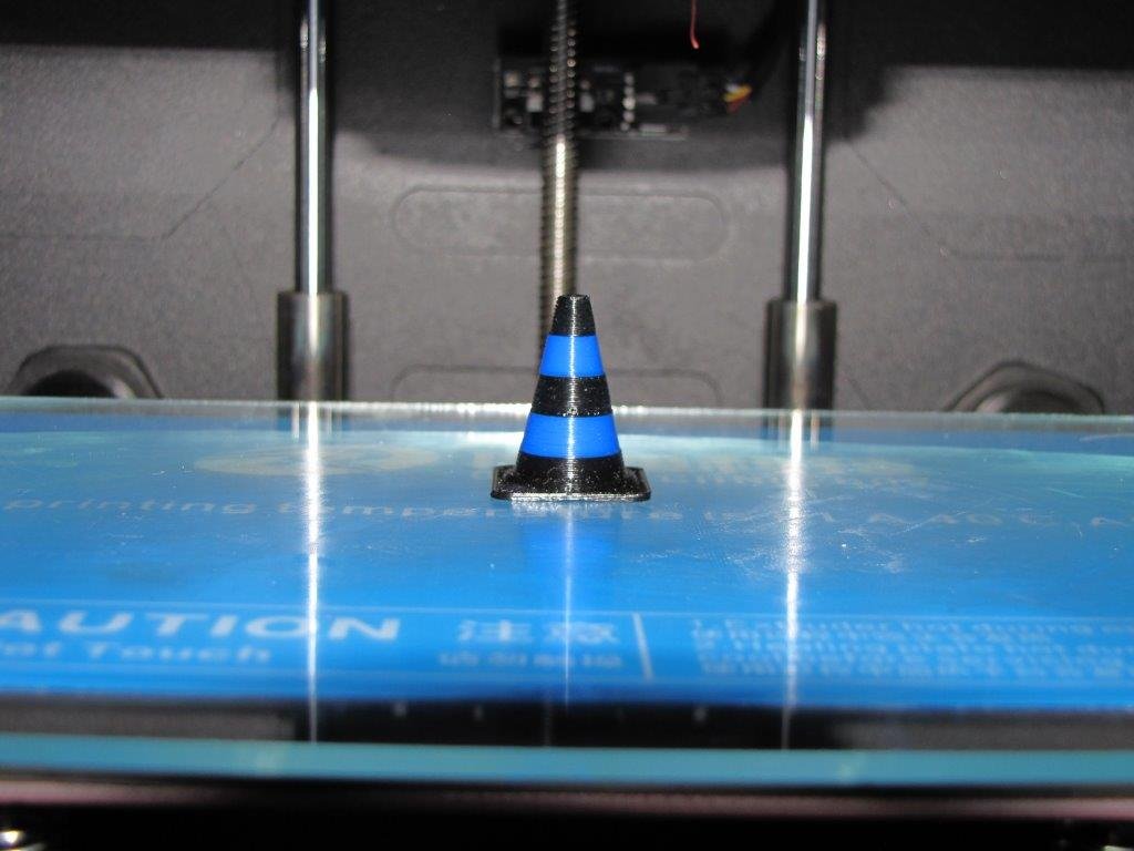

Out of interest, have you tried a dual extrusion with it? It took me a while to get the toolhead offsets to something I’m happy with (-1.19 X and 0.096 Y), but it seems like it could still be a tiny bit better. Looking for someone to share their experience with this and let me know if I’m on track with it.

Awesome looking set up. I did print the filament guide also, a truly wonderful thing. I have done a few dual prints but just some dual color figurines and the like. I see that #3DBenchy has a dual color torture test, which I think I will try. I will let you know if I get any results from that. Benchy is a minor obsession.
The cone looks pretty dead on, maybe just a tiny bit of shifting on the top two layers (or that could just be the photo). I have taken to clamping my glass bed (made some little stainless steel clips from old windshield wiper blades) because occasionally it would slip and produce funky print results. I would love to dampen the frame a little bit to reduce the hard jerking of the print head.

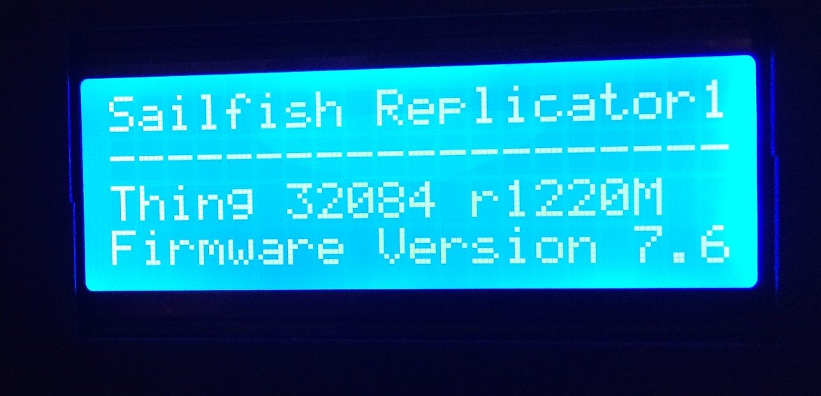

My report on a successful upgrade to Sailfish 7.6.
Or why can’t I just leave things alone instead of putting myself into these situations.
I tried using AVRstudio version 4-7 but was unable figure out how to get it to recognize the usbasp programmer http://www.amazon.com/gp/product/B00AX4WQ00?psc=1&redirect=true&ref_=oh_aui_detailpage_o03_s02 with http://www.amazon.com/gp/product/B00CW80MP6?psc=1&redirect=true&ref_=oh_aui_detailpage_o00_s00 10 to 6 pin adapter.
What I succeeded in doing was totally erasing the programming from the board. (@&$#)

Using a program called AVRDude google it and a couple command prompts I was able to reload the hex files giving the board back USB functionality and then the bootloader which had the added benefit of setting the correct fuse bits. I’m not going to go in to detail on how to do It. It’s all in the MakerBot Operators thread.
