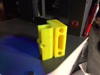

Hi All
I know that some of us are having issues with this printer, however if you do manage to get it to work here are some tips.
Firstly forget the slicing system in the printers software just use it as a way to connect to your printer, send the g_codes.
download
Meshmixer at www.meshmixer.com
Slic3r at http://slic3r.org
Meshlab at http://meshlab.sourceforge.net
Now I use Meshmixer to add the support structure to the Model, Slic3r to generate the g_code then upload with 3d create and print.
now Meshlab I use to convert the sketchup file to stl as sometimes the sketchup plugin fails.
Here are the settings for PLA in Slic3r I use which seem to work.

When you do load the G-code the printer will tell you the bed is heating , But it will not mention the print head. Just let it run.
Now as for the Printer
That square PCB build plate get shot of it as it is useless.
Get hold of some sheet Aluminum the same size as the PCB. Rough the surface with some 80 grit emery paper.
When you get ready to to print spray the Aluminum with cheap Hair Spray, this will help combat warping.
I have added a Photo of the results.
Do search for tutorials on the software packages I have mentioned, but ultimately get a better printer for half the price we had to pay for this thing.
