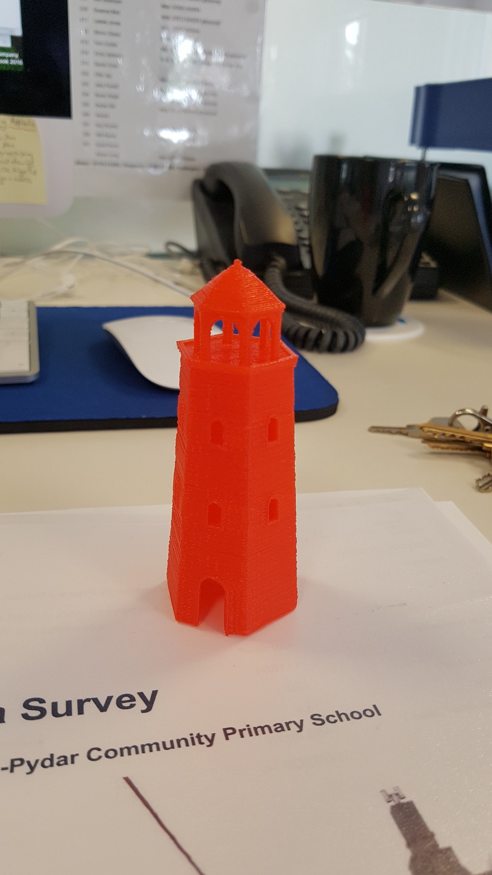

I have actually managed to print a couple of items the first being a āsimple light houseā it was after that first light house that i started to experience all my problems!

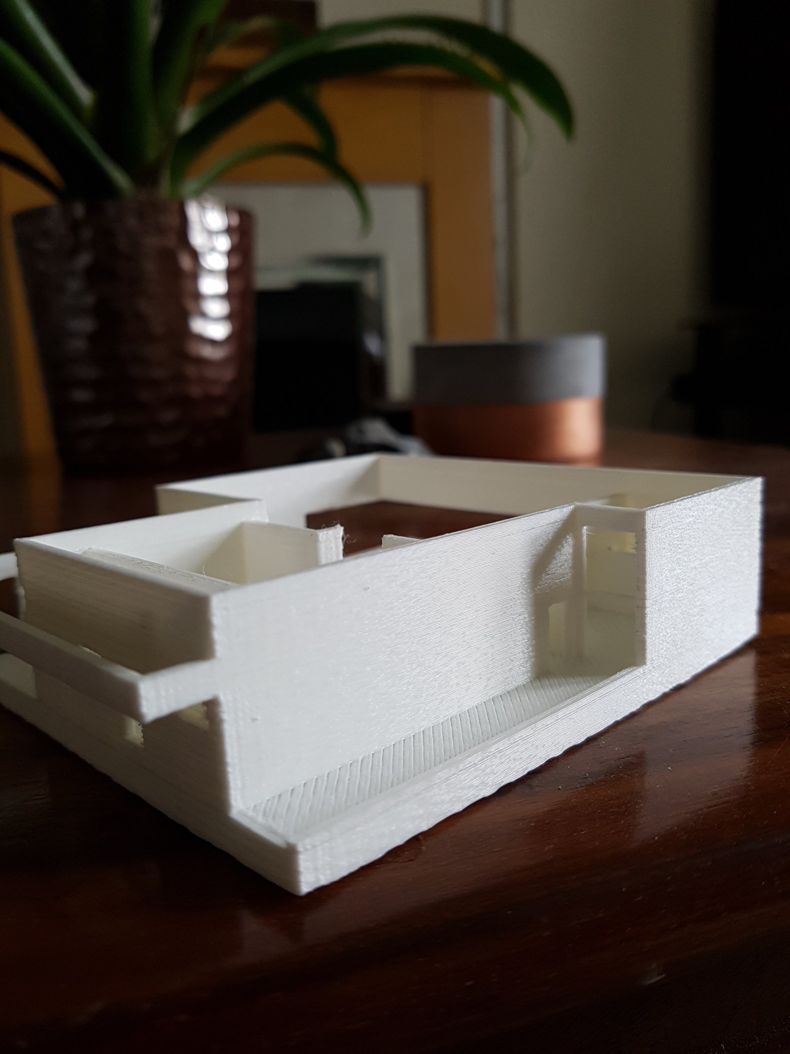

Looking at the picture the belts are too slack and need to be tighter. If they are tight then slow the printer down.
I have this printer which to be honest is very poor, and a CTC PRUSA I3 clone. i will print that lighthouse on the CTC so you can do a comparison. The cost of the CTC is around £160.
Your right. However that was on quick settings. I printed a model on the fine settings and got got this result

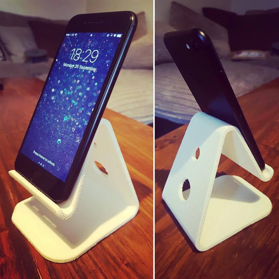

Ive spent some serious man hours attempting to perfect the printer and as far as Iām concerned, i have got it working as well as it will. as you can see in the pic, this is the best print Iāve had so far.
