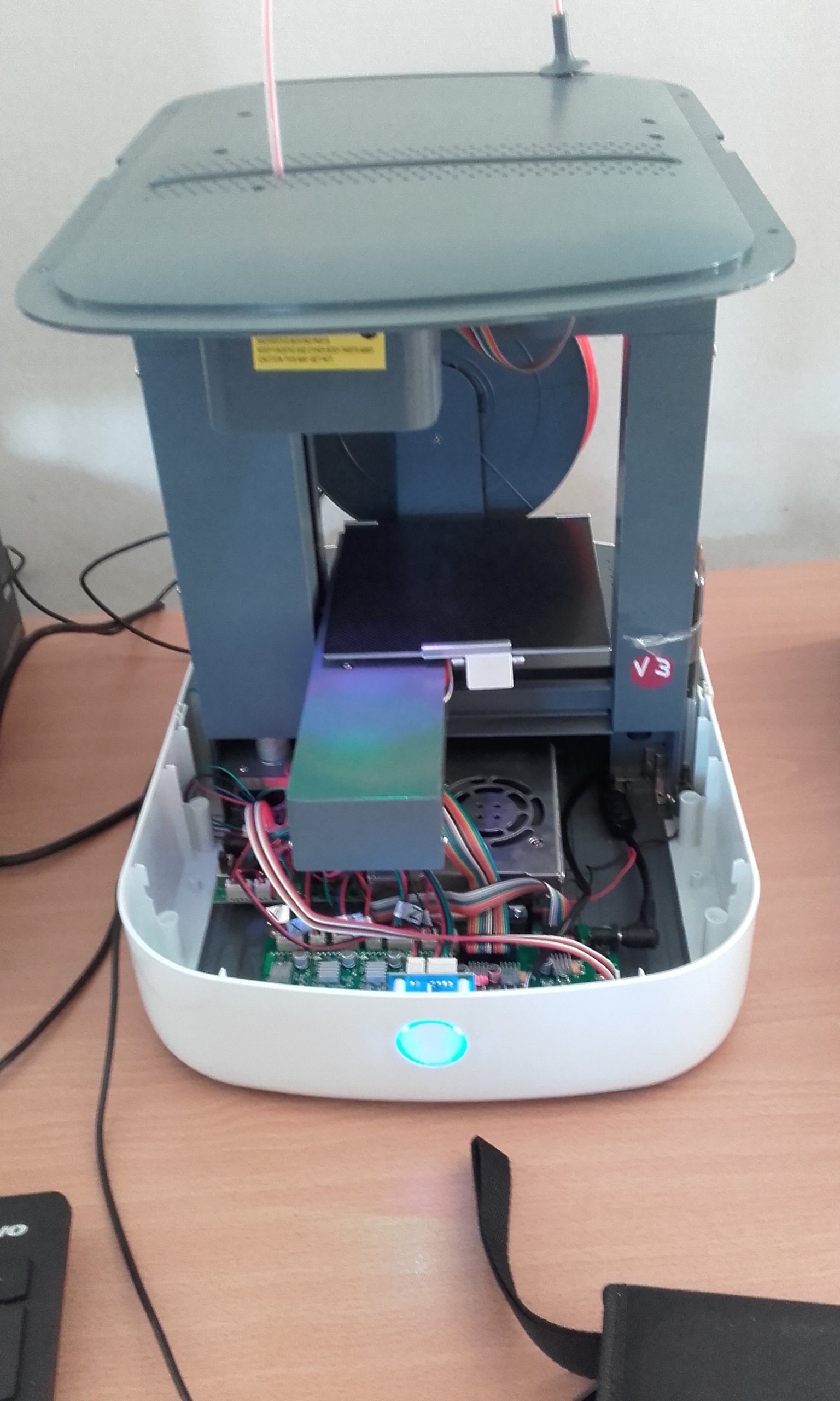

For info our build is shown in the attached. The base cover is off because I anticipate that a new board is required - can’t update the firmware on this one.

I was also diagnosed with a faulty board.
It took them around 6 weeks to send out a replacement, which solved the original problem.
Unfortunately the new board came ready with its own problems which differ to the original problems!
