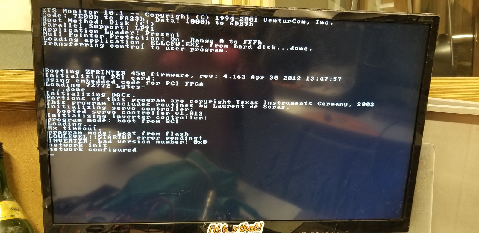

Replaced the fuse and the cartridge (because it melted). I keep getting the, 'Inverter: bad version number: 0x0". I used a slow blow 20A ceramic fuse. When I start it in boot mode, everything runs properly when I run the tests but it just takes me to the error reboot window when I start it. I attached a photo of what my logo says on start up.
Do I need to do a reset? If so how is that done?
I just need to fix this so I can continue work.
