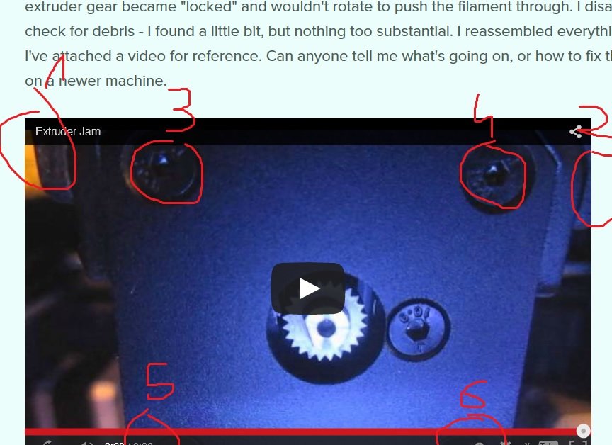

I’m a new Zortrax user. I’ve done about three prints so far. Last night, I set a project up to print and came back in the morning to find it had only printed halfway. I started again to find that the reason it had cut off is because the extruder gear became “locked” and wouldn’t rotate to push the filament through. I disassembled the housing to check for debris - I found a little bit, but nothing too substantial. I reassembled everything, but the problem persisted. I’ve attached a video for reference. Can anyone tell me what’s going on, or how to fix this? It’s frustrating, especially on a newer machine.
(In the video, you can see me inserting and removing the filament on the right)

u must screwing 6 screw: 1 on the left and 1 on the right. And 4 on the front. (look attachment)
And inside should be small pieces of filament from last print. U must taking out.
next time if you will be changing material put another time unload material and then is good to use hand to pull filament.
u must be carefully. If something left inside u must again screwing out 6 screw and remove old material.
This is normally thing. Dont worry.
Good luck.
