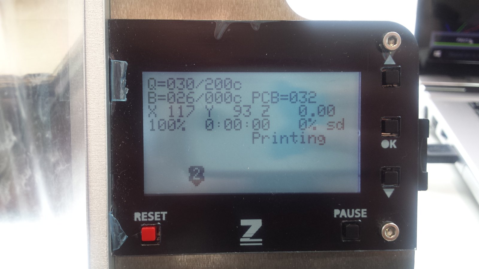

3. Once we try to print ,after reset and arm the laser (red light on), the head starts to move , as if it were printed the file, but the laser beam does nothing over the carboard. It is like if the laser was not enough powerful to cut or make the any work. I attach a photo from the INFO SCREEN during “printing” process
At the screen, It seems that the machine temperature or laser strentgh is too low to start the work. Could it be this the problem? If not, what can it be and how can we solve it?Thank you in advance.

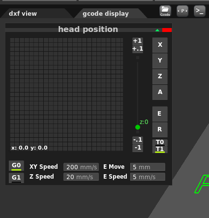

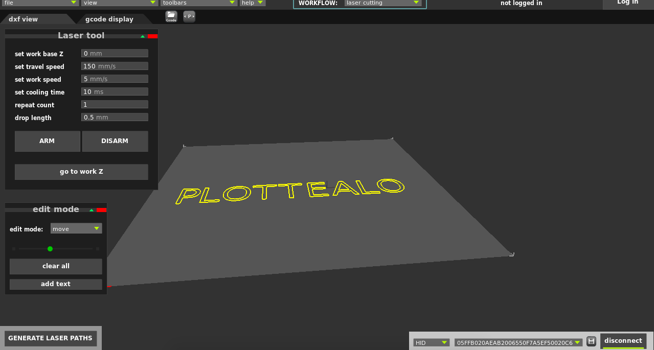

The SET TRAVEL SPEED (in voxelizer dxf view) is 150 mm/s. The GCODE DISPLAY (in voxelizer) has the following parameters speed: XYZ Speed (200 mm/s) Z Speed ( 20 mm/s) E move (5 mm/s) E speed (5mm/s).

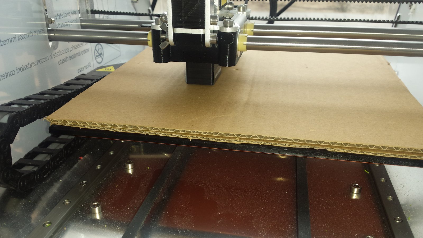

The material is a 2mm brown carboard (I attach a photo). The other carboard (also 2mm) is for protect the crystal base.

I have talked with the zmorph support techniques and they told me to reduce the work speed ( to 2mm/s for example), but it there is no difference.
There is only a tiny blue light (like a powerless one) but it doesnt make any marks .

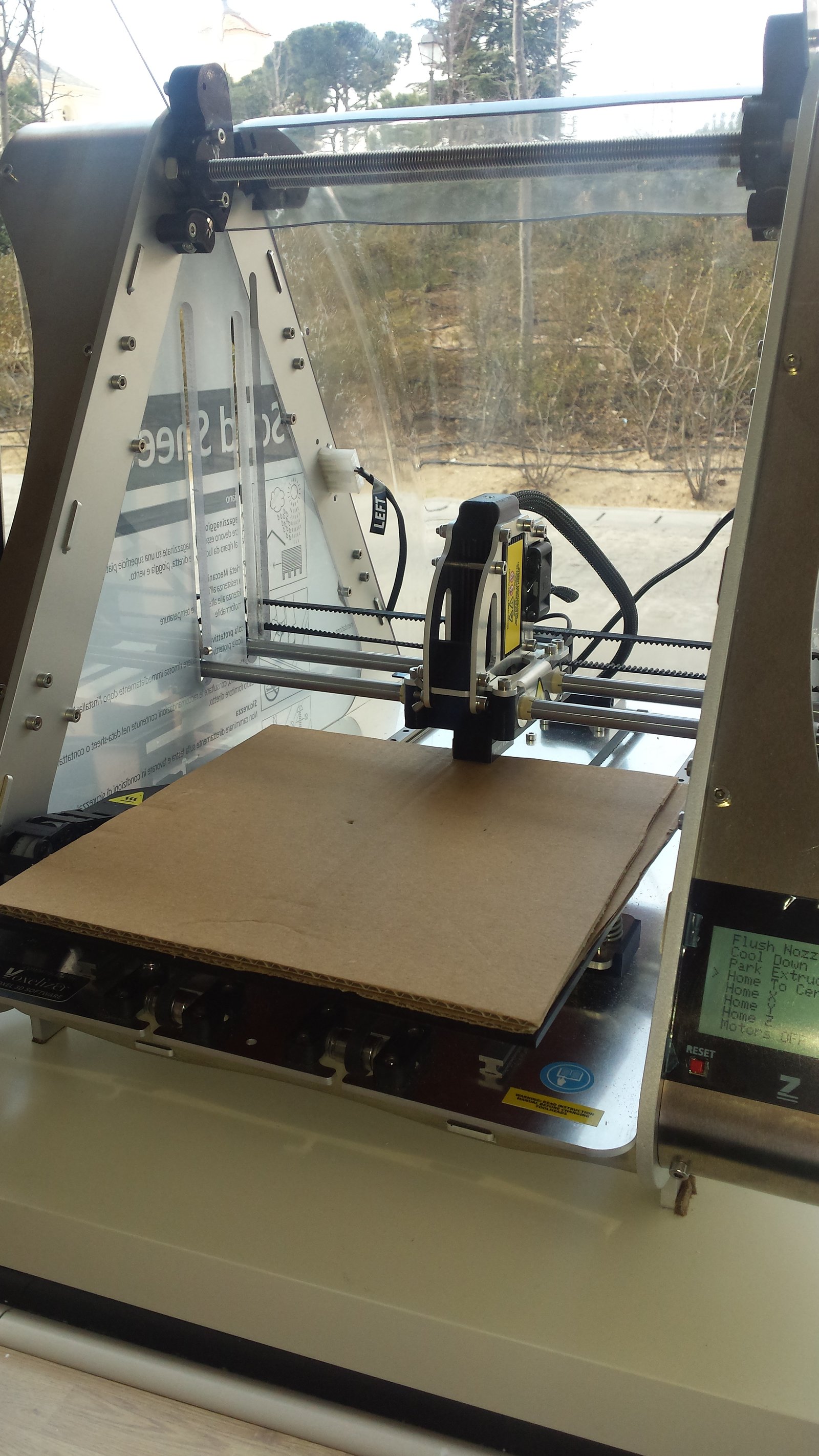

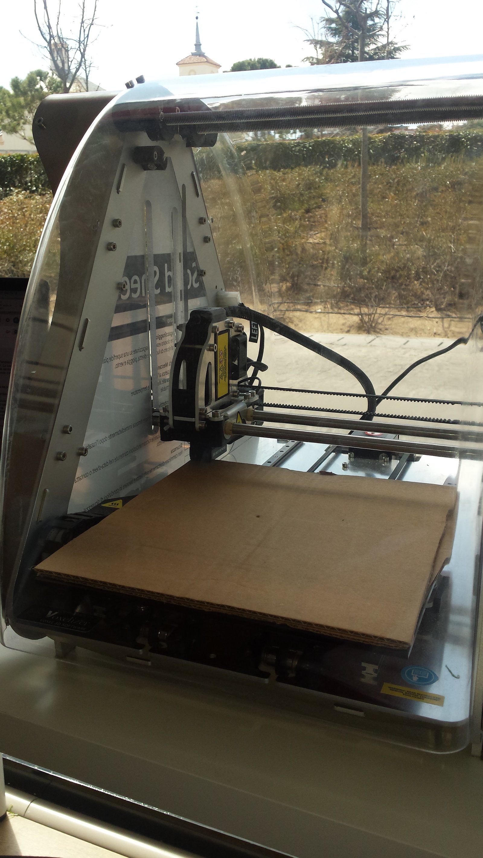

On the other hand, I am also having problems with Y axis configuration. The base goes to the front of the printer when I click on HOME TO THE CENTER. I also attach a photo of the position when I click HOME ALL AXIS (is like Y axis is not well calibrated… or something). Do you know how can a I change that?.

Seems that your Y-axis is not home correctly. Have you checked that your heatbed socket is well connected? Have you tried to turn off the machine and try again?

Y axis problem is solved.
I have talked with Zmorph support services. They are very kind. We were trying to troubleshoot the issue together, but they concluded that the toolhead should be replaced - it doesn’t catch the cardboard, the laser beam is too weak. The parameter laser_module_max_power in config file is set to 1.0). They suspect it is a laser diode damage… So, we are going to try with another laser headtool!. I will inform you of the latest news. Thanks
Great to hear that. Just curious - what caused your y-axis problem and how did you solve it?
