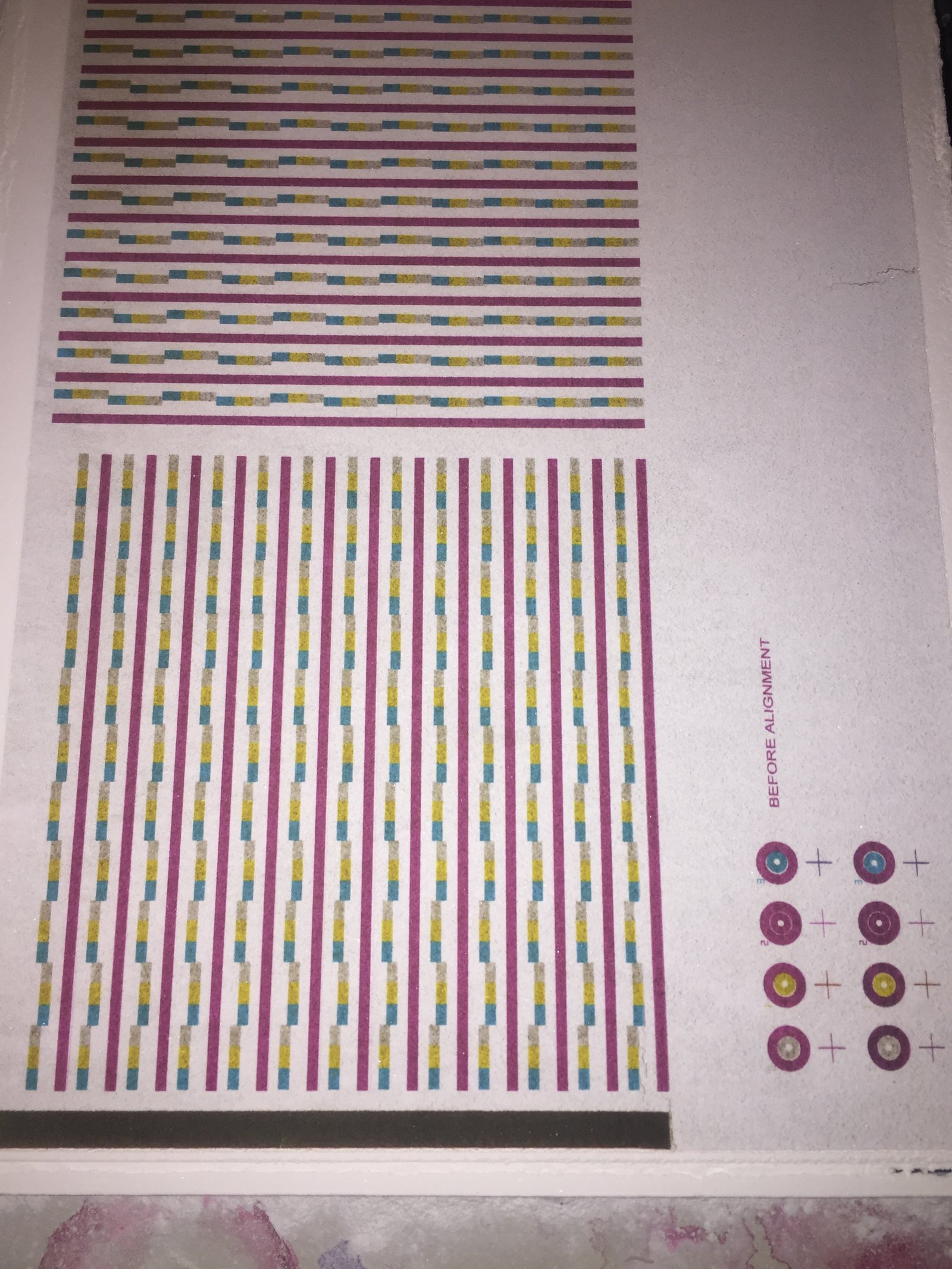

- Print a “Auto Align Pattern” is it fine?

Thanks all for the suggestions. I am using zd-16 powder and binder. The instructions were to use 151 powder profile but the colors are so undersaturated. Using 131 is much closer but the blacks have a green tinge to them. Other colors are pretty good. All new heads and on the stripe test they are not stripey. I have done alignments and they seem just fine.
