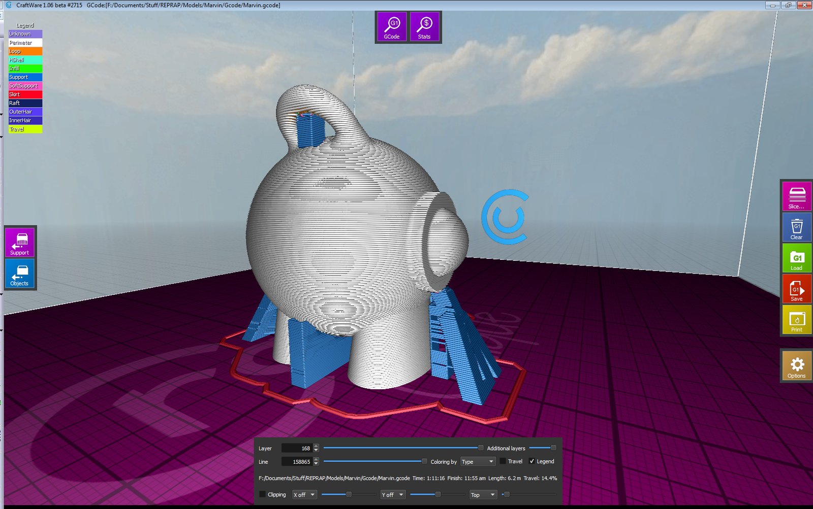

Hi I have a K8400 and I have my z hop set to 0.2 but I watch the z rod and see that it only works on the first layer, Does anybody know why this is and how I can fix it?
My settings:
