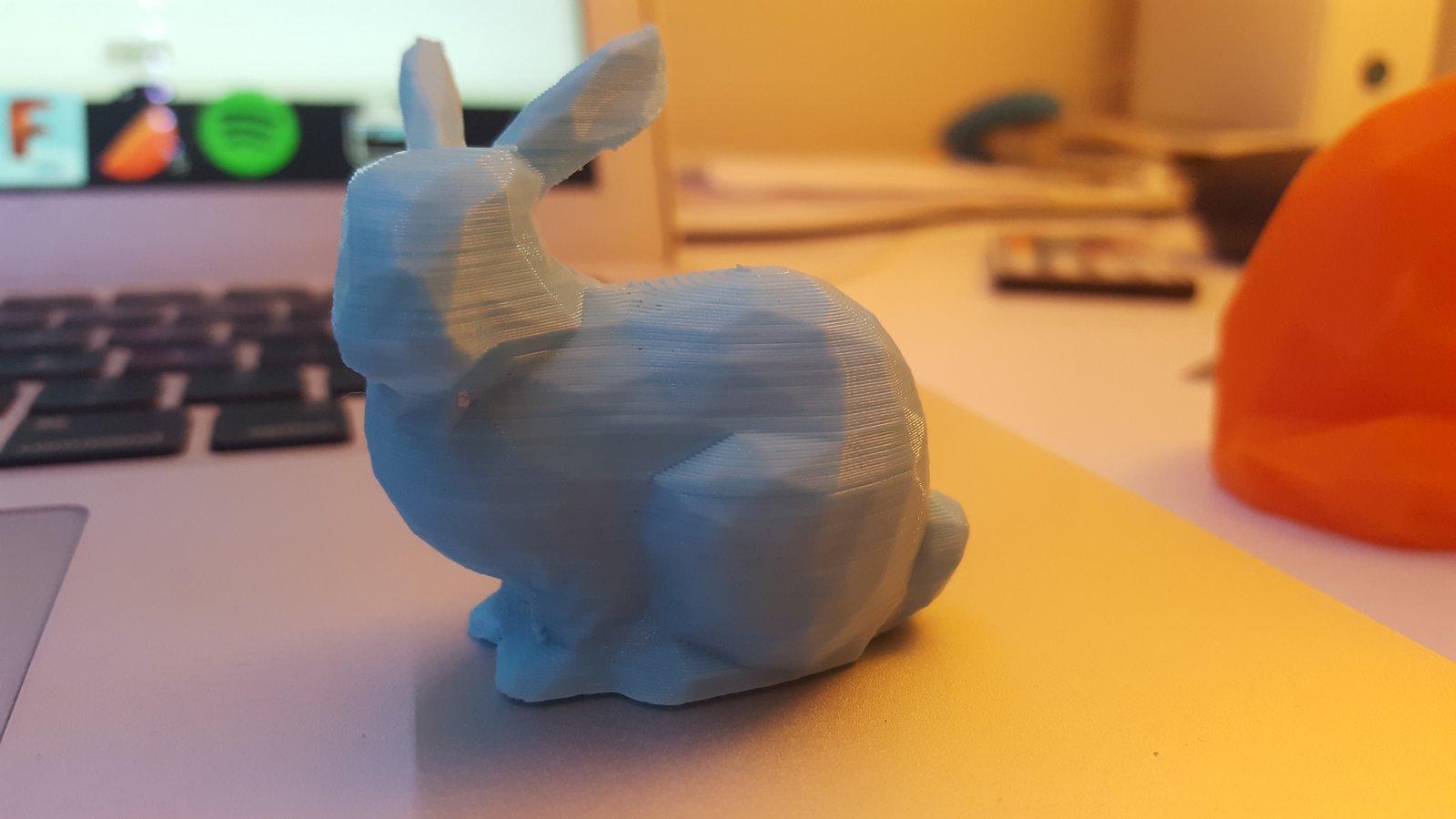

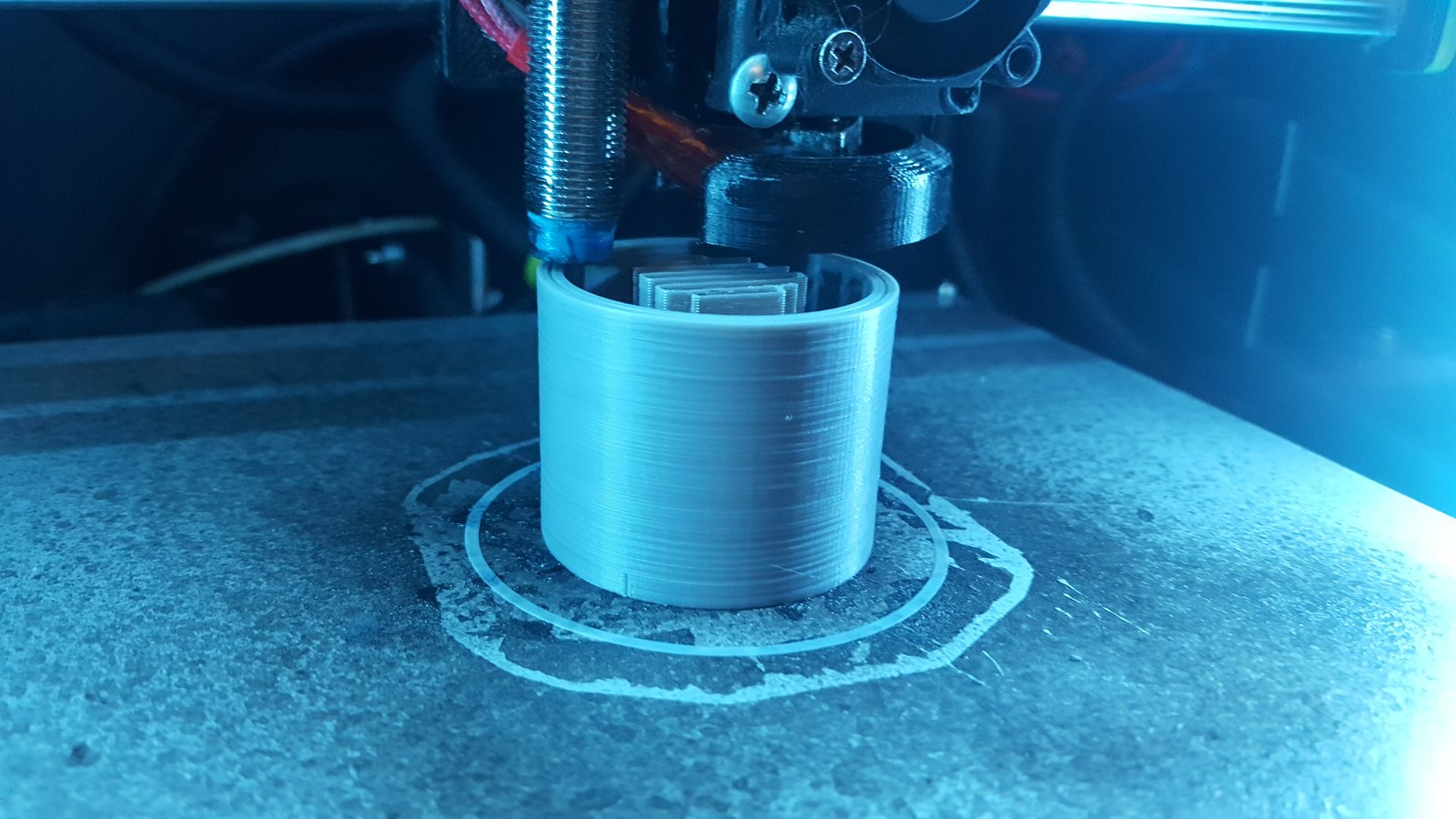

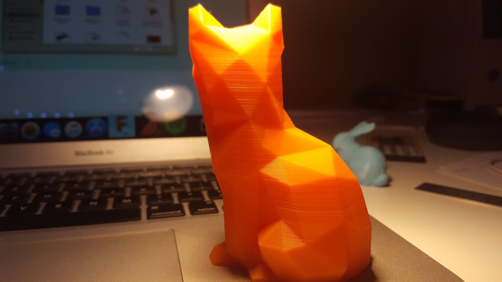

I have been having problems with slight z axis banding and layer inconsistencies on my homemade printer. I am certain that it is not z wobble as everything is 100% straight and true and the bands are not particularly in a constant pattern that follows the lead screw.
My question is, are these bands normal? and is there a way to get the walls more consistent to create a better finish?

Thanks for the suggestions, the filament runs smoothly. The filament seems good and the parts seem to have no gap.
Maybe its just the fact that i am using a bowden extruder which causes a bit of slop.
Are you using layer fan?
Yeah. A blower fan with a circular shroud.
