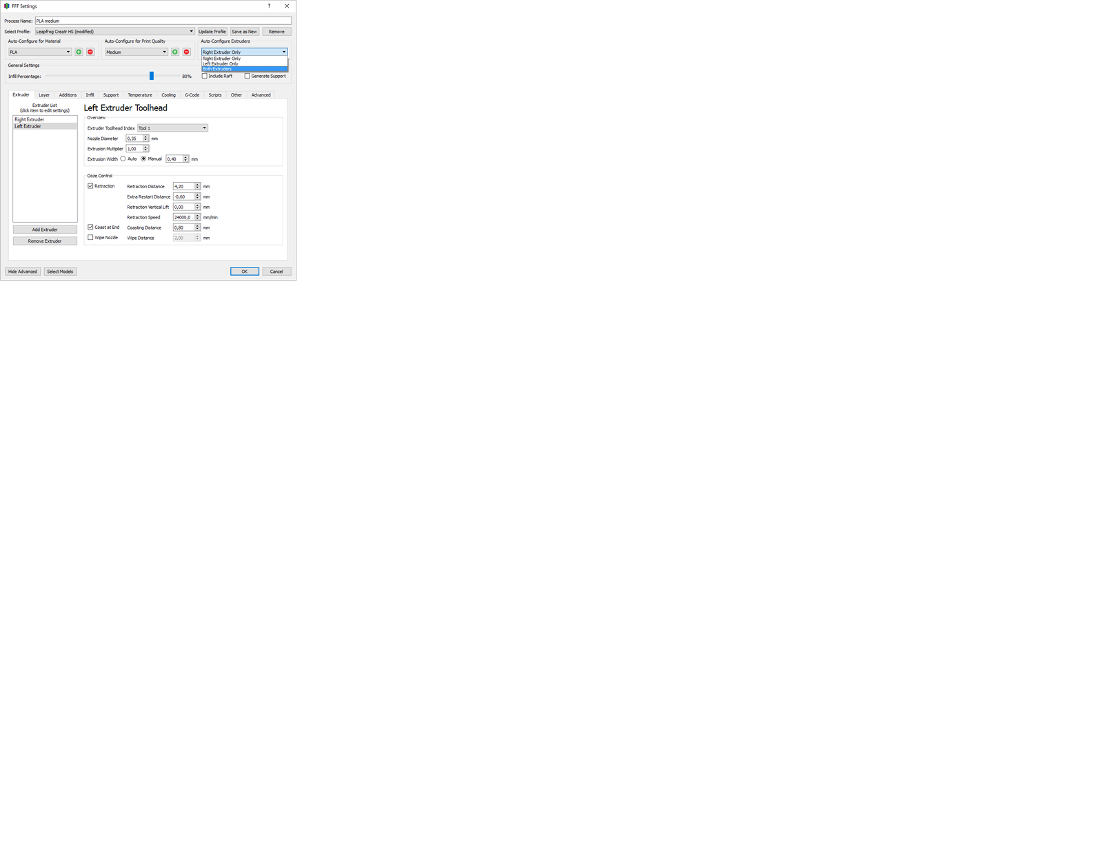

Even though I definitely choose a single extruder in simplify 3D, I can print only 220 x 250 x 230mm.
Am I doing something wrong with setting in Simplify 3D?

Did you select one extruder (Left or right) or both extruder in the settings!
YES I’m sure I chose Right or Left extruder

Can you manually change the wide ( under > tab>g-code>build volume)
the Std function is probably not working fine
YES I know i can change width under Gcode, but that’s not issue.
Even if i set width 220 x 280 x 230mm 8.7 x 11.0 x 9.1 inch and choose a single extrude printer cut the end of printing object.
Basically I can print only 220 x 250 x 230mm 8.7 x 9.8 x 9.1 inch with single extruder
