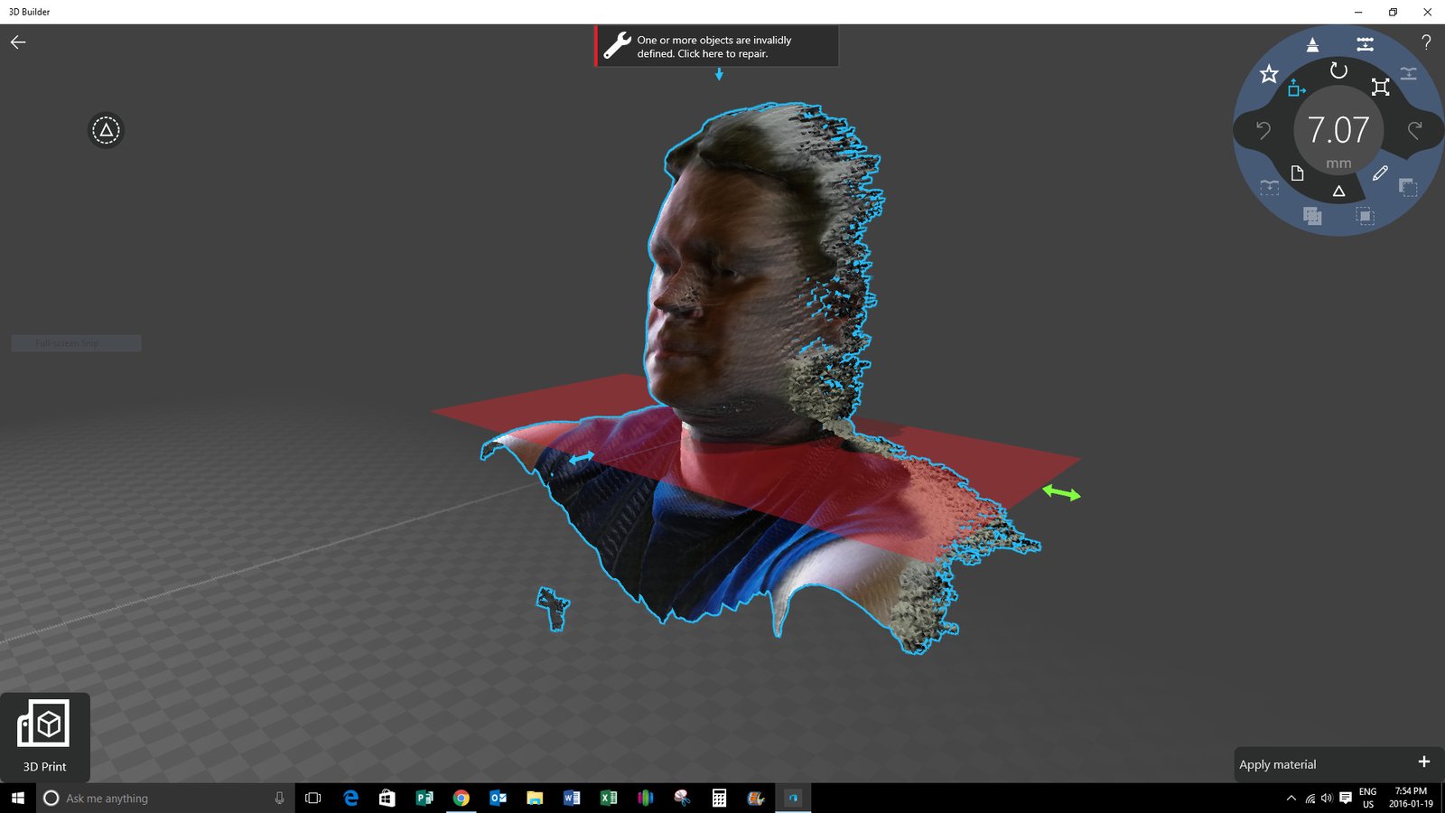

Just thought I would throw this out there for any DIY’ers. I just hooked up the Xbox One Kinect to the PC and got the Microsoft 3D scan app, and it worked fantastic! I just did a few test shots to see how the depth worked out from one side and so far it’s pretty decent. I picked up the Kinect sensor used for $125CAD and the adapter for $65CAD. The software is free from the Microsoft Store, so this is a really cheap 3D scan option. The app exports the completed file in either .STL or.OBJ. Alternatively, you can download the Kinect SDK pack from Microsoft and build the .STL from raw footage.

Well that sure sounds like a bit of bad luck, yes you do need a 64 bit processor to run the Kinect SDK v2.0 and the 3D Scan and Design App. USB 3.0 port is necessary as well. The results are very fluid so far for me, much better than the alternative DIY scanners out there. The Microsoft 3D scan app looks to be brand new, in the last month or so.

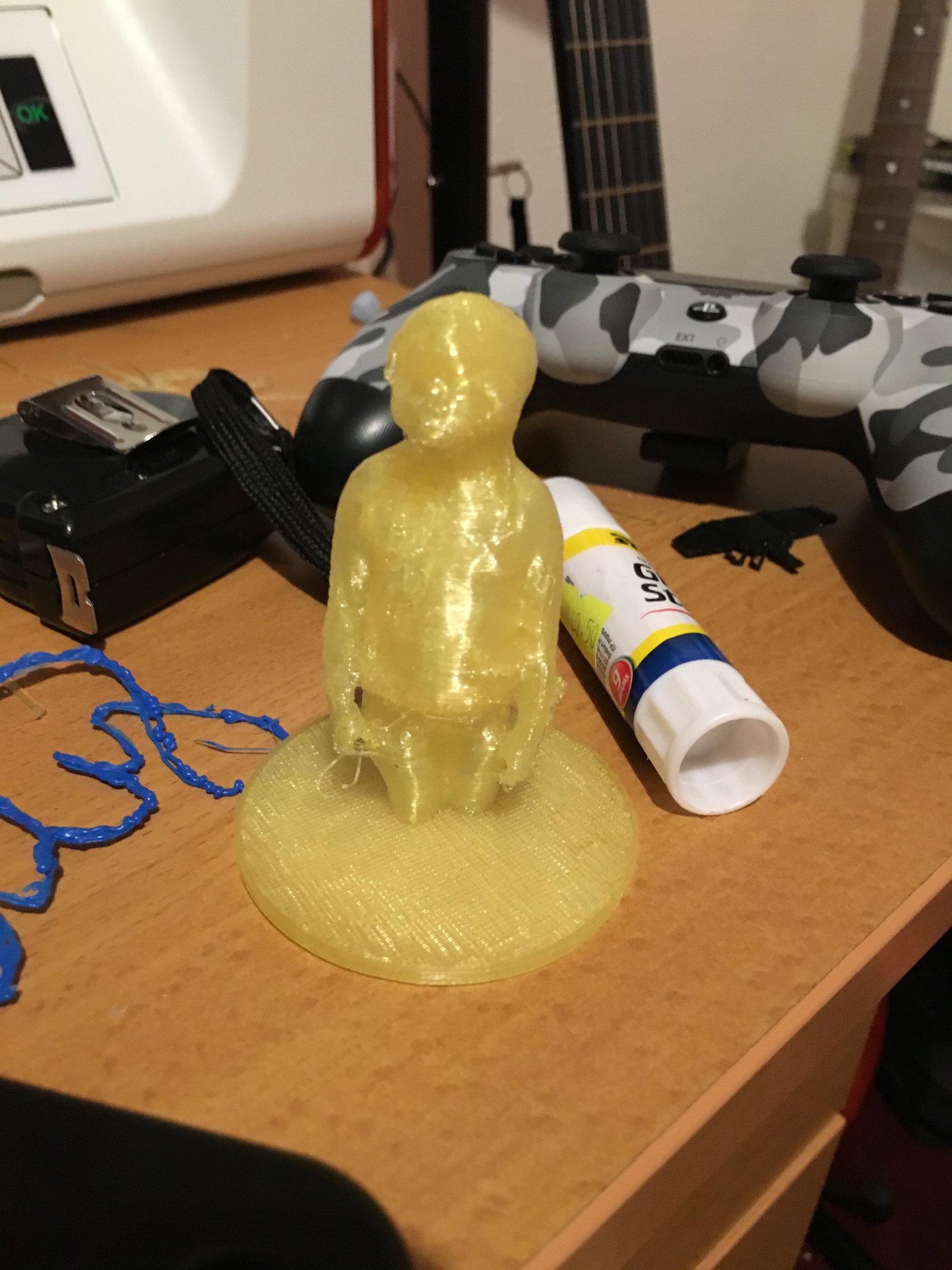

I’ve been getting fun results with my Kinect 360. I am struggling to get busts done properly at the moment but having fun with it.

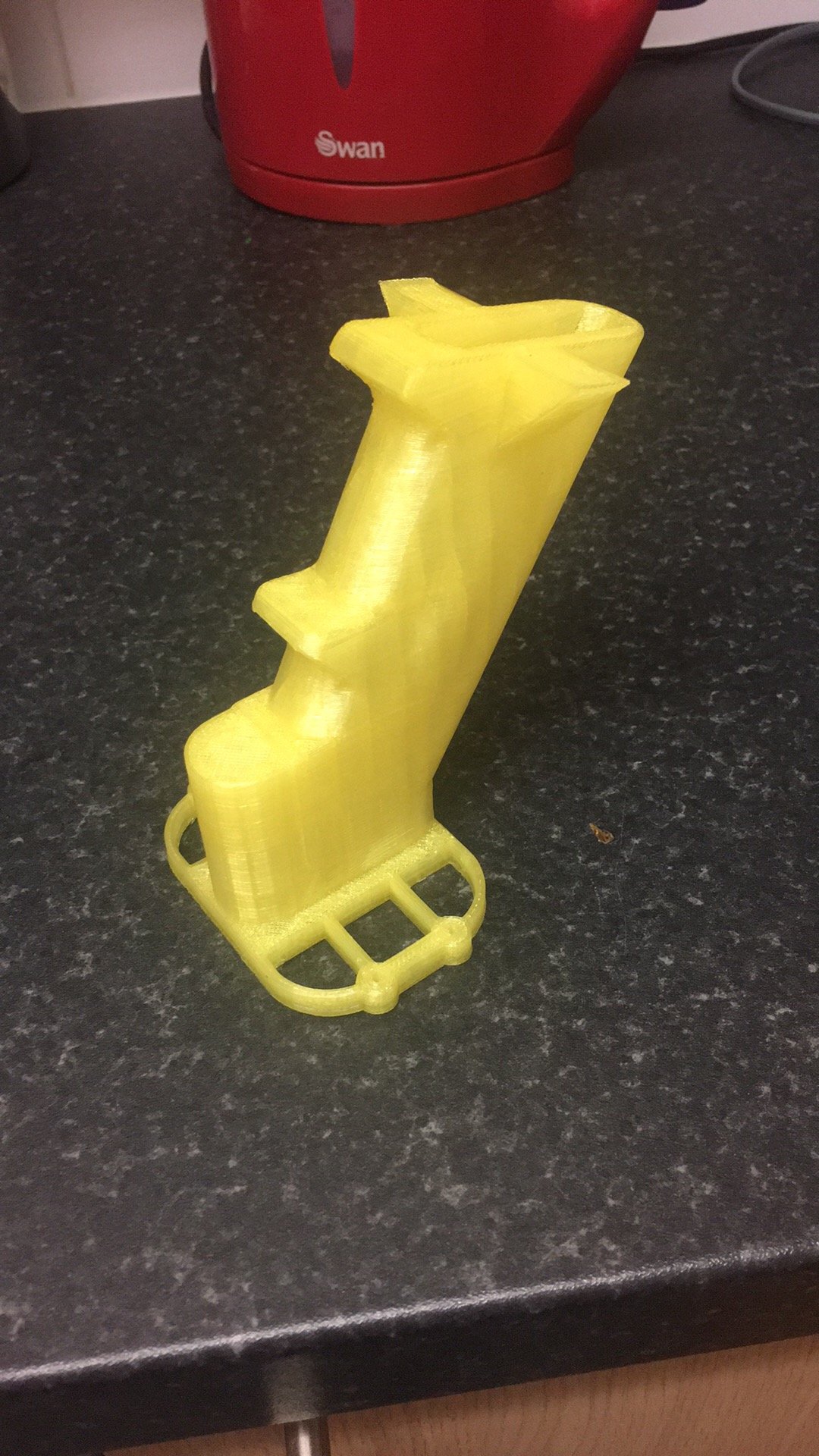

Theres handles on Thingiverse but I don’t have the link close to hand. Have attached a pic of both a test print of my daughter and the handle I’ve done.
Cool! Nice handle!
