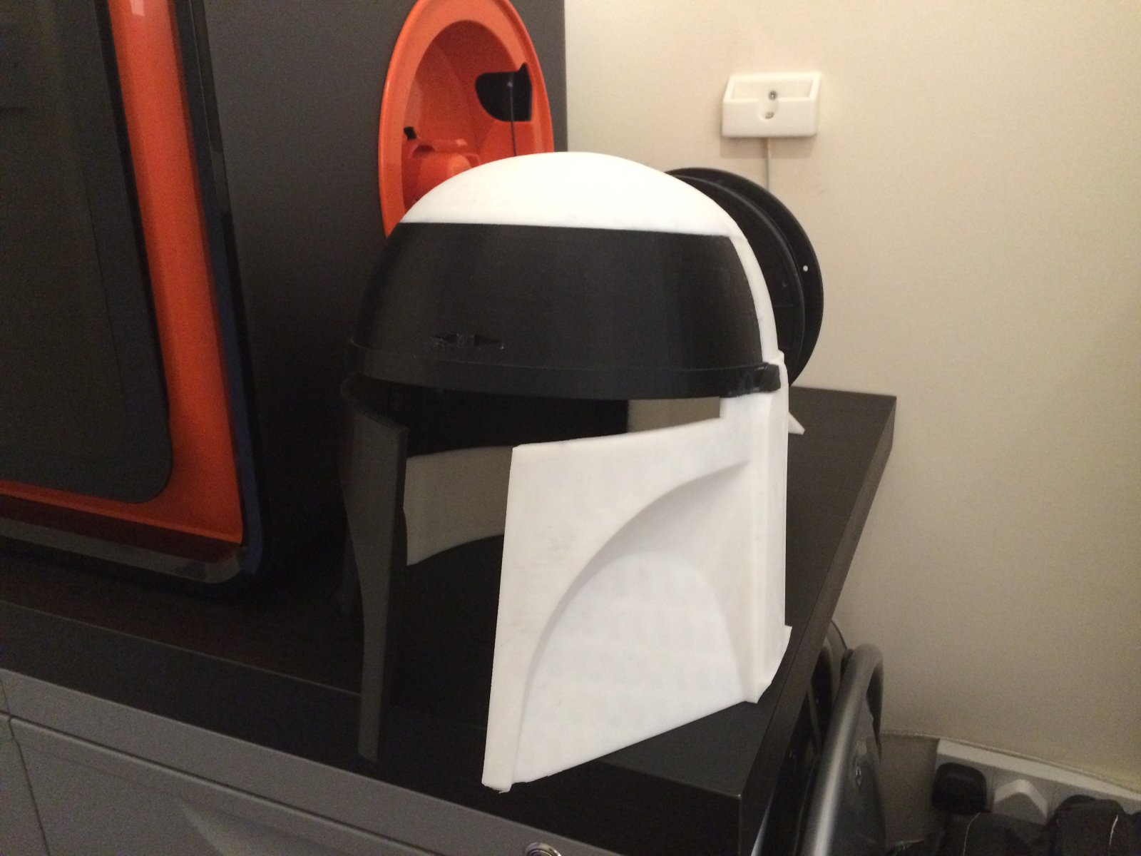

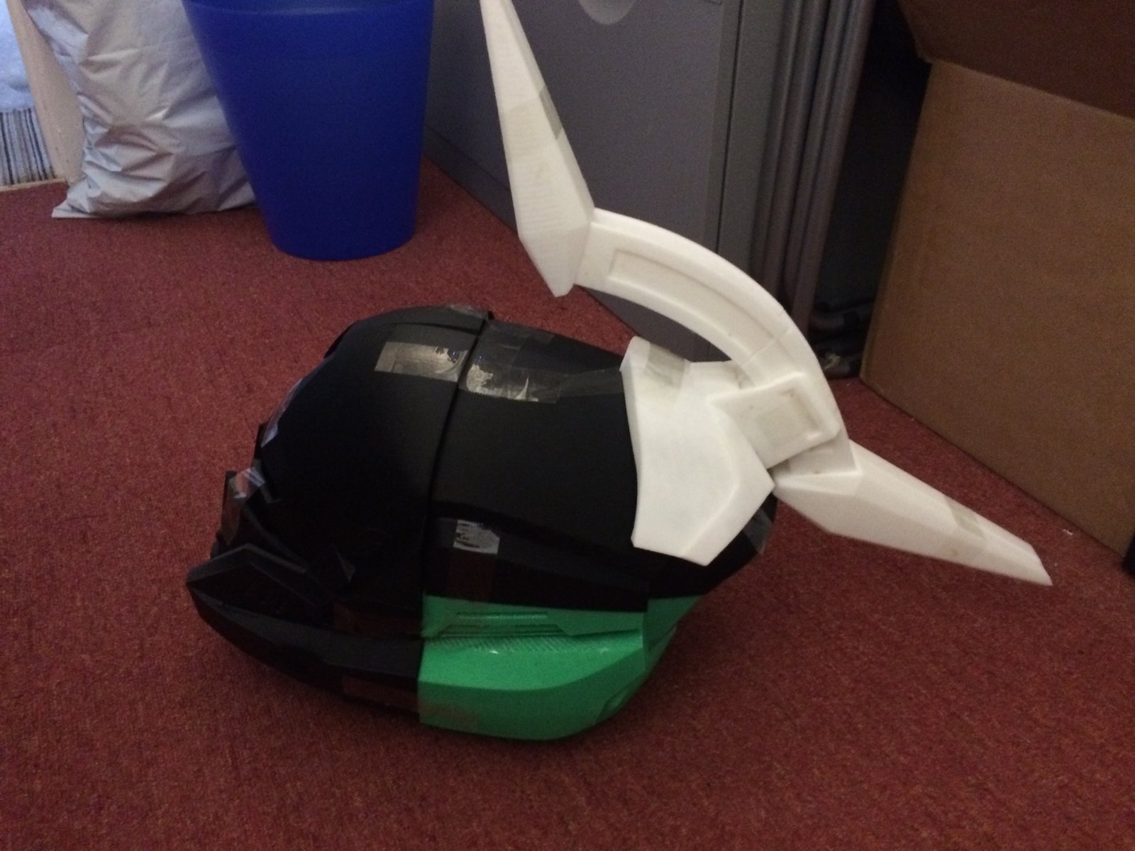

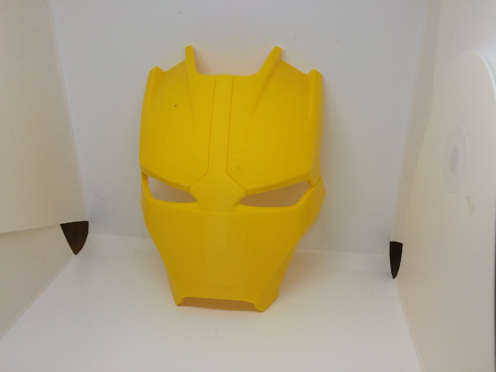

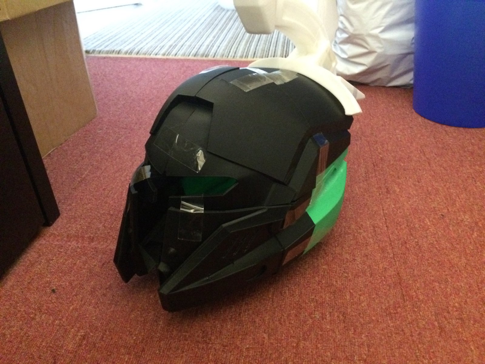

I’ve attached some photos of a few helmets I have done, as they come off the printer and roughly taped together so you can see the shape.
yes very possible… I have done several helmets and its just a matter of getting the size correct
