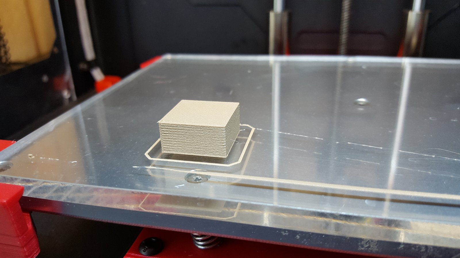

I finally got around to trying wood filament (Hatchbox PLA on QIDI Tech-1) the initial results were very good and encouraging. Started with a 20X20X10 calibration box to see what “wood” happen and it came out pretty good.

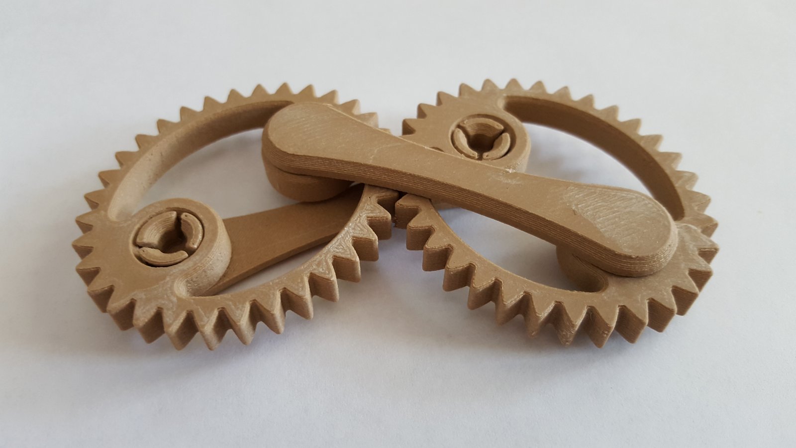

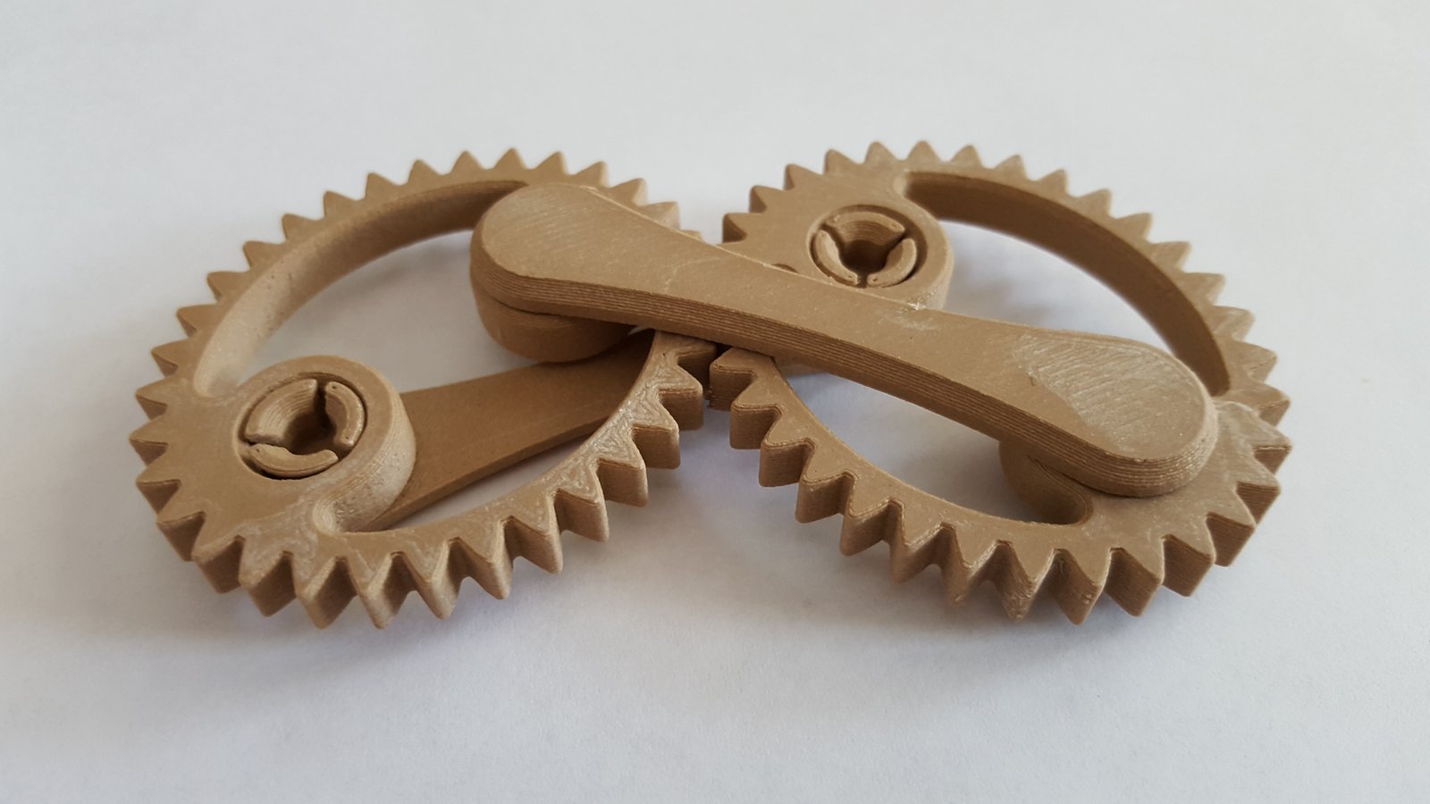

Went on the do an elliptical gear set that I think someone here recommended and it came out great.

Here is the calibration cube and the gears I did in wood.
