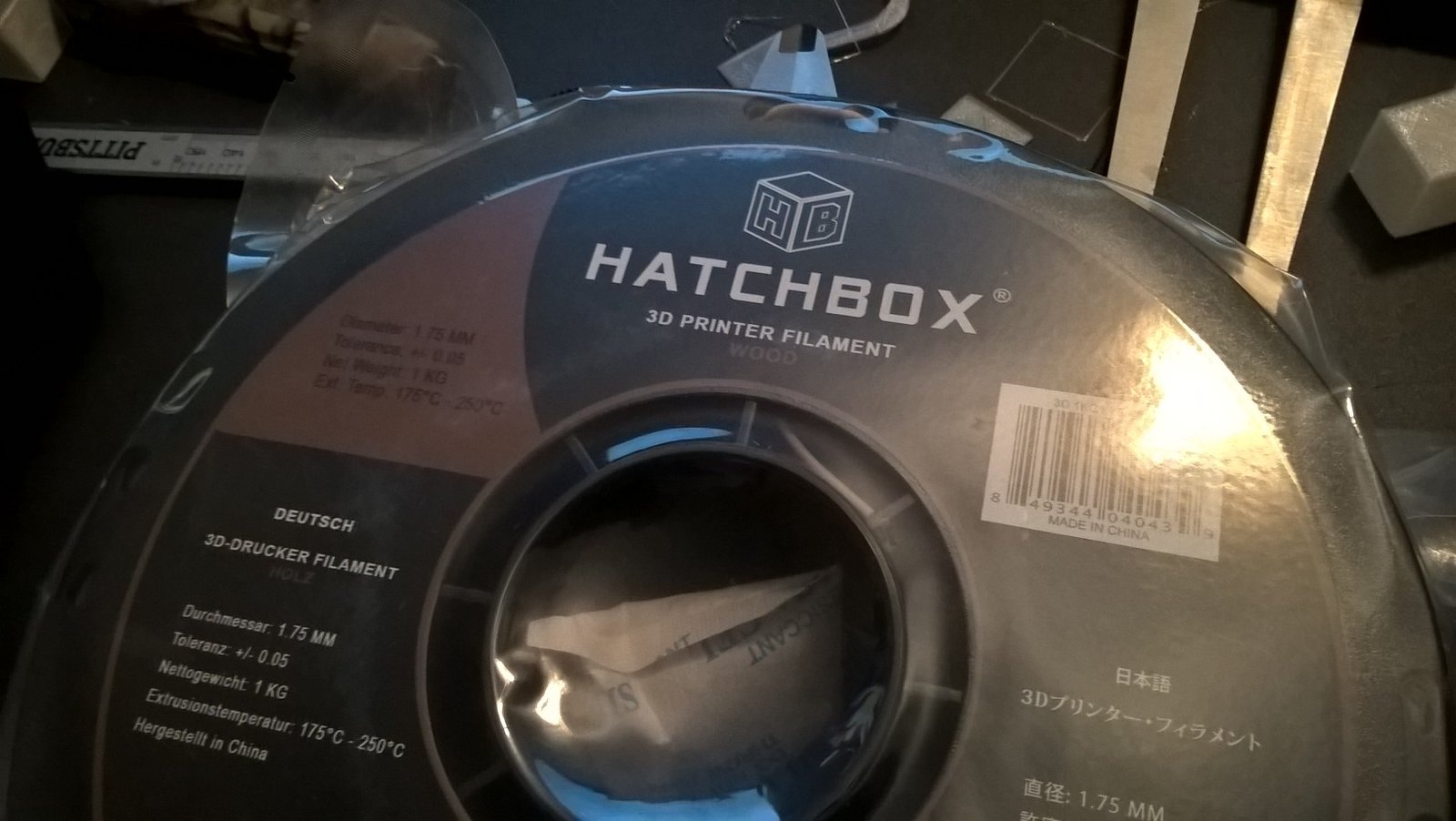

My coworker has this brand and prints it at around 235C for his best result. (he clogged a .4mm nozzle lol)
Package says 175-250C
